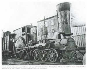

The Siding is doing an interesting kit bash, which in fact is not so much a substantial
alteration as it is an American refitting of a standard design. What baffles me is the
frequent use of what appears to be a vertical boiler hafted onto a horizontal boiler.
This locomotive is just plain wild with its use a massive driving wheel and a triple bogie
to support the rest of the locomotive.
Assuming that draft is an important component of the steam locomotive, how is that
improved by this gigantic funnel?

Burn wood (or even coal) and sparks fly, so the "funnel" was probably more about having a place to hold all the screening that was needed to keep from setting the surround forests, towns, and people on fire. You stuff a LOT of screening in a big stack, otherwise using just a little will burn off quickly and then you're back to giving the people, places, and things along the line "baptism by fire."
With the passing years, as steam locomotives got bigger and bigger, their stacks generally got smaller and smaller, because all of the "spark arresting" components got moved into the loco's smokebox.
Here's a short article on the subject that goes into much more detail: Large locomotive smokestacks solved burning problem http://www.bnd.com/living/liv-columns-blogs/answer-man/article34036968.html
And another article on the "smokestacks got smaller as boilers grew bigger" subject (and how the netting was moved to the smokebox) from a 1928 Popular Mechanics article: The Vanishing Smokestack https://books.google.com/books?id=y94DAAAAMBAJ&lpg=PA183&pg=PA183#v=onepage&q&f=false

A tall stack has advantages in creating draft. Especially when you're just steaming up. When you vent exhaust up the stack to create draft, and when you have a blower (a steam jet pointed up the stack), you can get by with a smaller stack.
I do remember a huge, modern Santa Fe engine that had a smokestack extension that could be used where there were no low clearances and retracted for tunnels, low bridges, etc.
The old steam riverboats had very tall stacks, but I don't think they exhausted used steam up them, so they depended entirely on natural draft. Sometimes that draft would be tremendous, as in throw a log past the fire door and watch it get sucked in.
