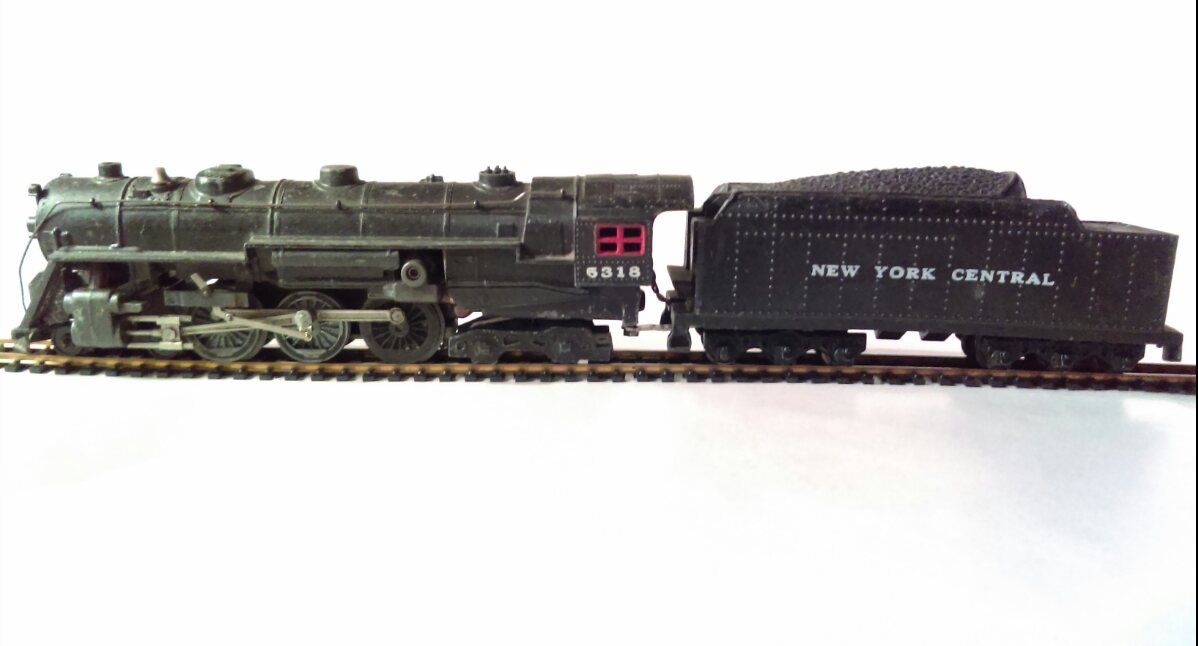

Joe. ** Are you talking about a Gilbert Hudson #112 ( your right) that has #5318 on the cab. They were pre war. Late 1930's. Those were the 6 volt AC Hudson's.

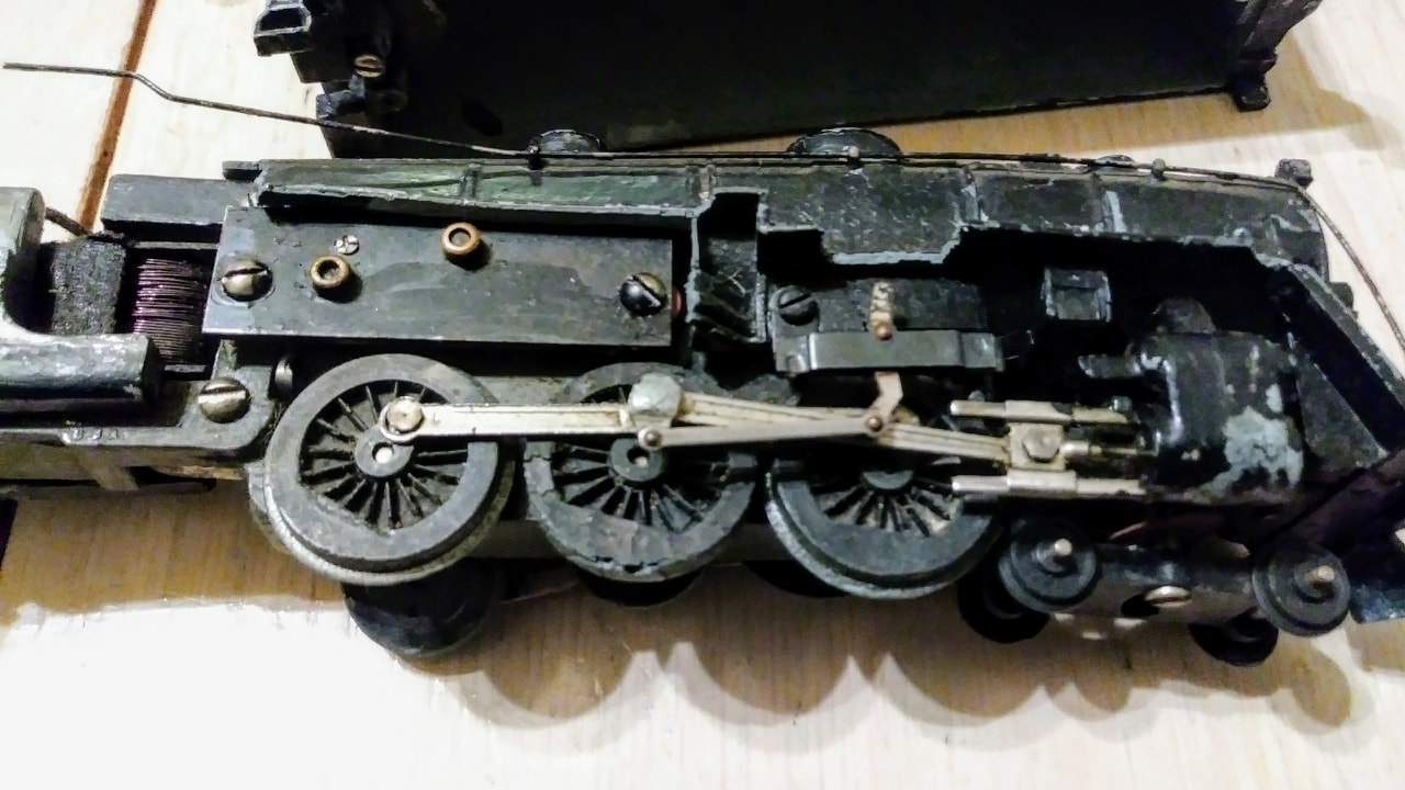

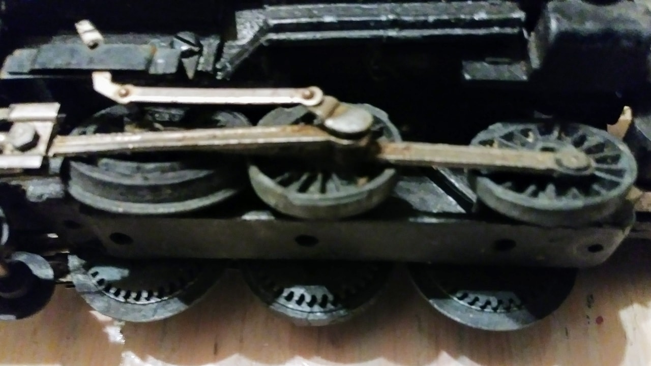

Actually it's the HO112 from 41' with the coupler mounted on the truck, but yes, spur drive, AC powered. They made three different drivers on the HO200 & HO112 Hudson's. The earliest ones were Bakelite, then came Bakelite centers with brass rims, then finally Die-cast Zinc? drivers that suffer from zinc pest where they swell and disintegrate. One of my drivers is crumbling and I'd like to replace it.

This is my HO112 with die cast drivers.

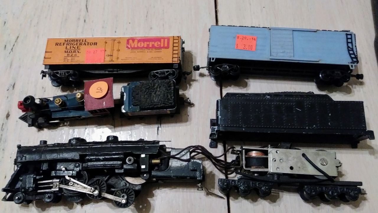

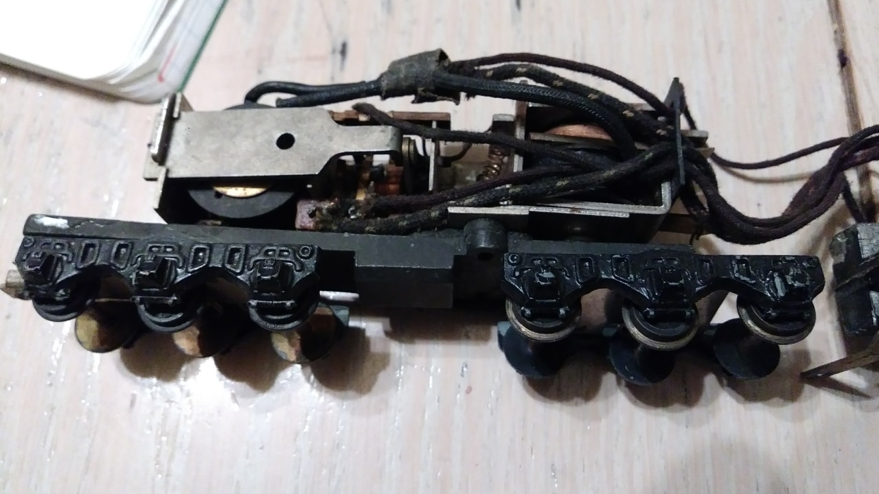

Patience and perseverance paid off today at Allentown. Today's haul contained this pile which included a diecast driver Gilbert Hudson with every part needed to repair the one i have and build the second one i have. The prewar diecast driver Hudson's are extremely difficult to find and as you can see, zinc pest didn't completely spare this one either.
