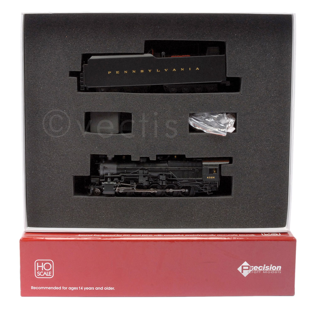

look forward to seeing it running,i have seen them over here on ebay,some prices are not so high,but not an everyday occurrence,you just got to be lucky,as not all post in the right scale,ken
vectis auctions get them in as well,i just missed this one a precision craft for £70
