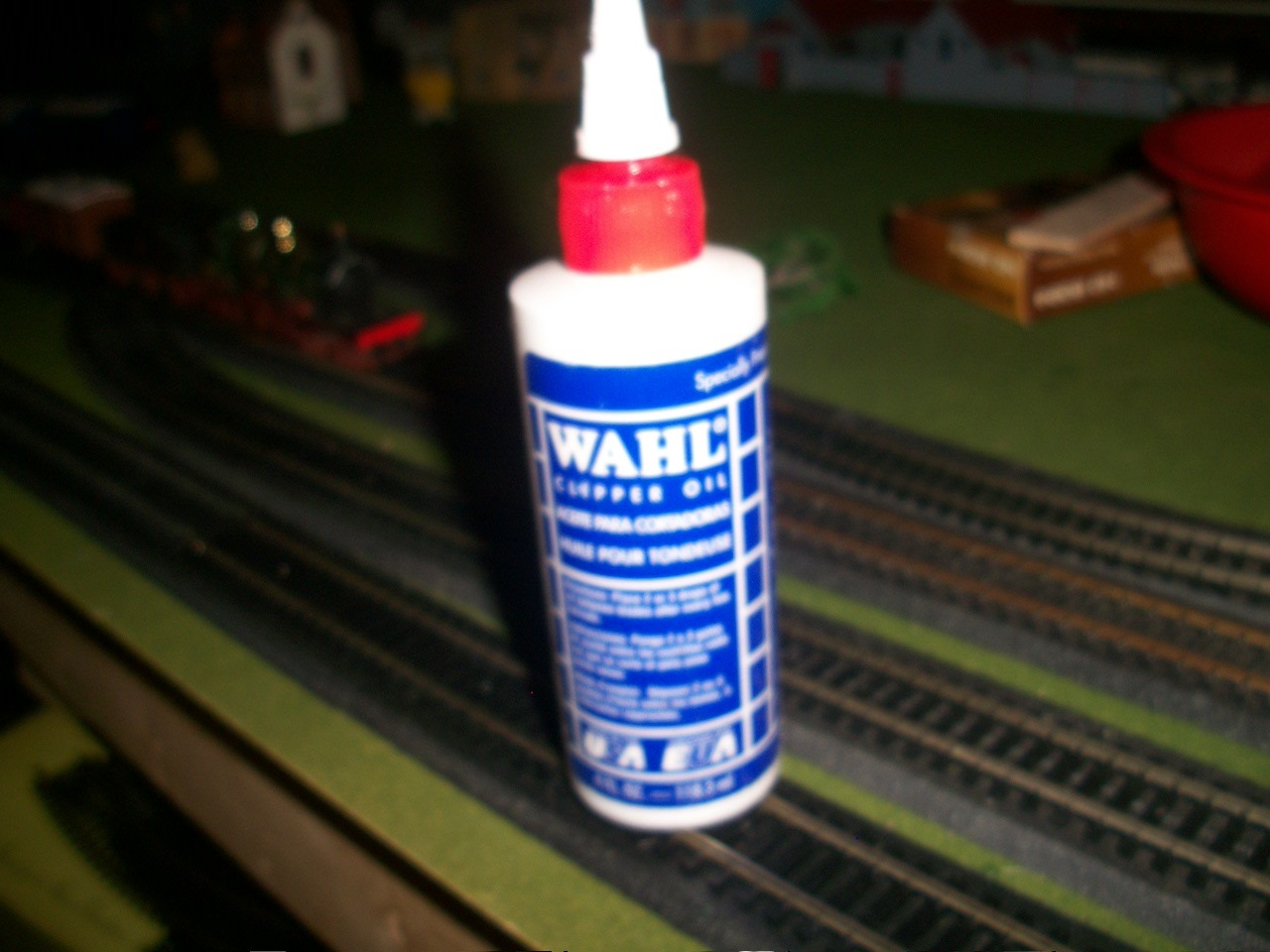

What's safe on trains oil wise? Wahl Clipper Oil or Rem Oil aka gun oil? Read both are safe. Got both at Wal Mart for $7.11. Not willing to spend 10+ on LaBelle and fight horrible traffic for it!

I use Wahl...gun oil can be risky on plastics...

Thank you! Bought both. I'll use Wahl.

Hah! Another Man of the Wahl. I use it for wheel and track cleaning. Great stuff. $3 buys a lifetime supply.
