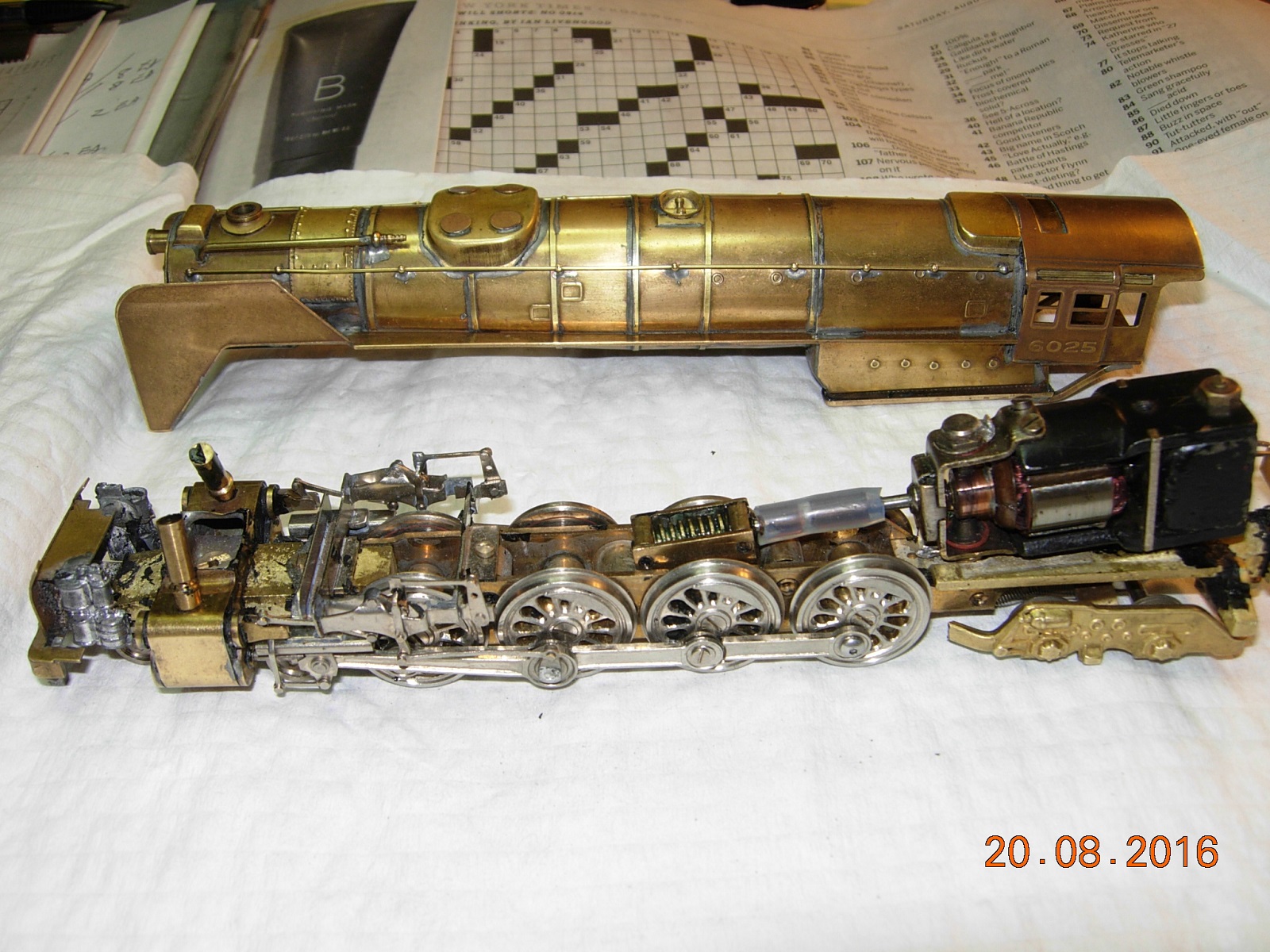

Finally, it runs.
I talked with a friend about turning a couple of crank pin screws for this loco.
Basically, it would be a huge pain in the a## for him to do this.
OK, so, plan B.
As I'm not going to find any spare parts for said loco,
the next best thing is to modify for existing parts.
Out came the Kadee 2-56 tap and into the unmatched holes.
Which, by the way, were not too far off from 2-56.
Cut and file screws to fit and:
Now I'm tracing intermittent shorts, probably from the lead or trailing trucks.
So, for a loco that was deemed a basket case, new life.
Evan
PGE33
CanadianPacificBeaverAvatar
 Posted - August 22 2016 :  8:10:20 PM Link directly to this reply  Show Profile  Add PGE33 to Buddylist
Well, that was faster than expected.
I found the source of the short.
It never occured to me until now.
The cab floor and tender deck touch at some points around the layout.
Quick fix, a bit of magic...... mending tape.
The 3M stuff in the green box.
A piece of that, folded over the edge of the cab floor.
