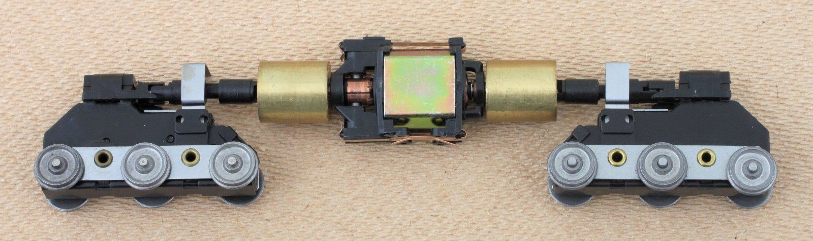

any idea what loco this drive train belongs to thanks ken
New, HO Scale Athearn Diesel, Twin Bogie Motor Drive, suitable for HO/OO and runs well.
Motor:
12v, 5-Pole, Flat Can Athearn Motor fitted with double brass flywheels and x4 fixing holes on the underside of the motor.
Motor shaft length = 9mm front & rear (3.2mm (1/8") diameter shafts)
Length = 22.2mm
Overall length including flywheels = 81.2mm
Diameter = 23.6mm
Across flats = 17.8mm
Bogie Drive Units:
Wheel diameter = 12mm (RP25 wheel profile)
Bogie wheel centres = 23.5mm + 23.5mm
Bogie wheel base = approx. in-between 135mm and 142mm
Bogie length = 61mm
Bogie overall height = 37.5mm
PGE33

That's a tough one.
Without a chassis ( with part # ) it would be a guess.
I've never looked to see if trucks come with part numbers.
Evan

Yes it's hard to say for sure, but I would say based on the length and the 3-axle trucks that it's a U28/30/33C.

That was the genus of Irv's later blue box and RTR products. Except for the small switchers all the motors were the same. The road unit B trucks were the same and the C trucks were the same. Only the frames, truck side frames and drive line length were different. The drive train could be a C truck U Boat or any of the EMD SD UnitS. You could pull a truck off of a Sd40 and put it on a U36C then swap the side frames.
Regards, John

thanks guys yes it is difficult ,guy is selling the complete thing as shown has about 10,will just buy one,handy spares,thanks again ken
