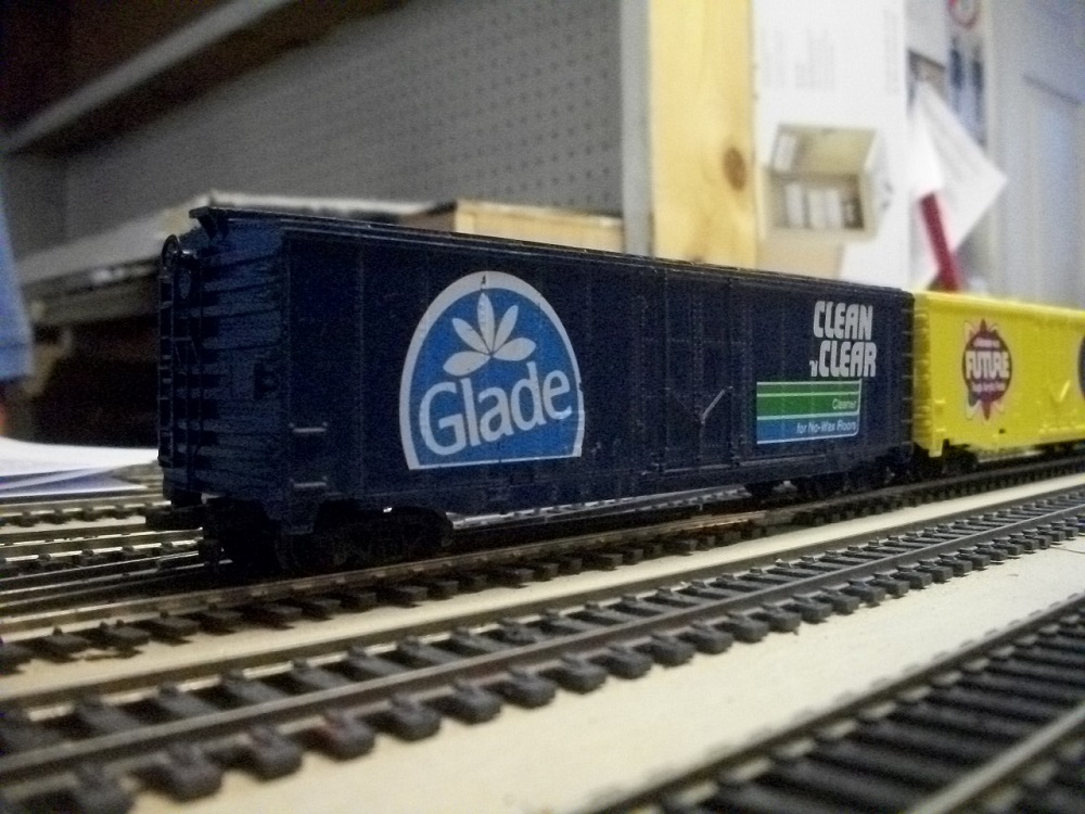

A clean machine. Set of Bachmann Billboards in tow at El Paso Model Train Club.

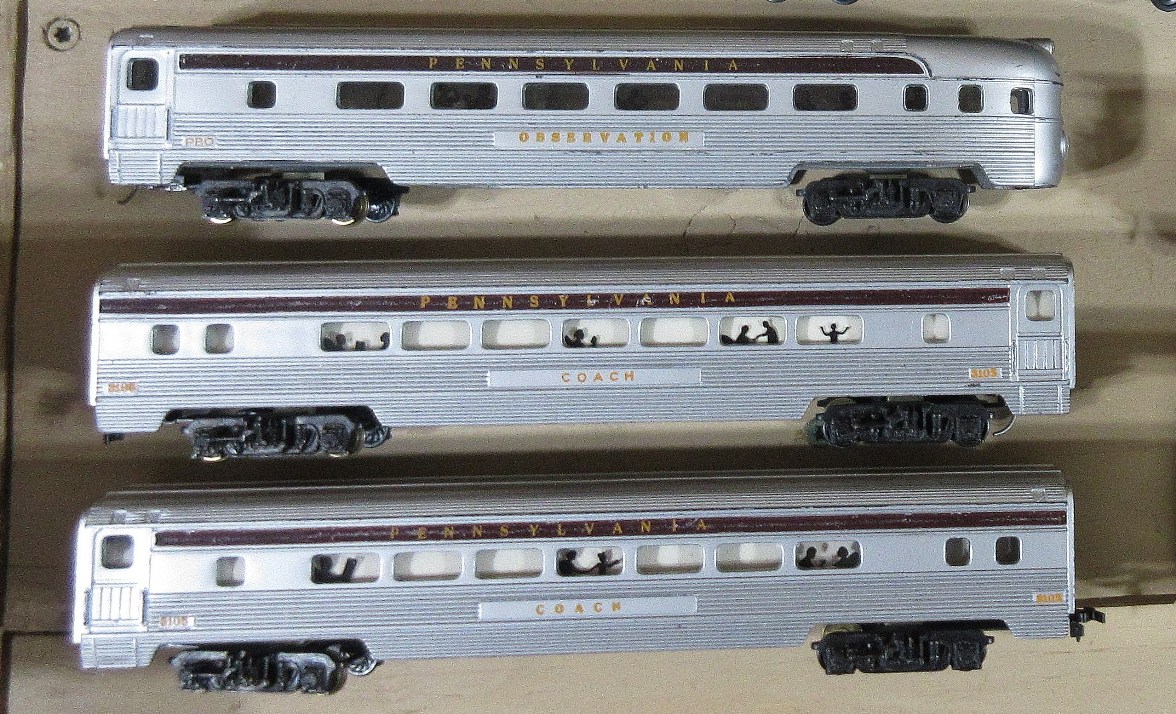

I Have a 3 car set of Tyco PRR passenger cars . Got them today.
 Posted - July 24 2016 :  2:21:47 PM Link directly to this reply  Show Profile  Add Chops124 to Buddylist
Great find!

Only have the Glade boxcar

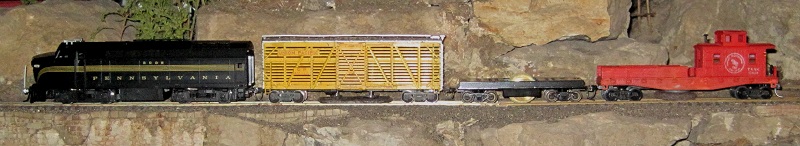

My track cleaning train:
First is the engine. It could be any engine heavy enough to run on moderately dirty track and powerful enough to pull cars that drag along pretty hard. In this case, it's a ROCO Shark.
Next, the cattle car has a Masonite pad under it. This is an idea made famous by the late, great Wizard of Monterrey, John Allen. The nails glued to it go up into holes drilled in the car floor so the pad slides along the track. This knocks off the bulk of dust and carbon. John Allen would include these cars in regular trains to keep the track clean all the time. On my ruling grade, it's all I can do to get trains up the hill without this extra drag, so I just use it when cleaning track.
Behind the Masonite pad is a Centerline Products track cleaning car. It has a brass cylinder with a cloth wrapped around it that rolls down the track in a well in the car. The car comes with some stuff called Goo Gone, which is about like cleaning the track with honey and lemonade. Avoid that! I use denatured alcohol.
Last but not least is the Lifelike track cleaning car. It drags a felt pad along the track, which is intended to be soaked with cleaning fluid. I run it dry to wipe off the alcohol from the Centerline car. The felt pad attaches with a screw so it can be removed and washed periodically.
Until very recently, I just used the car with the Masonite pad, and is seemed to be doing a good job. Even so, a couple of my locomotives would still crud up their wheels in only a couple of scale miles.
Similarly, I had used the other track cleaning cars singly with limited success.
This combination has made a real difference. The engines that used to get dirty wheels in record time now run on and on and remain clean. The combination of the Masonite's polishing action and the alcohol mopping up the dust and probably cleaning up some oils that couldn't be seen nor felt has made a huge difference.
