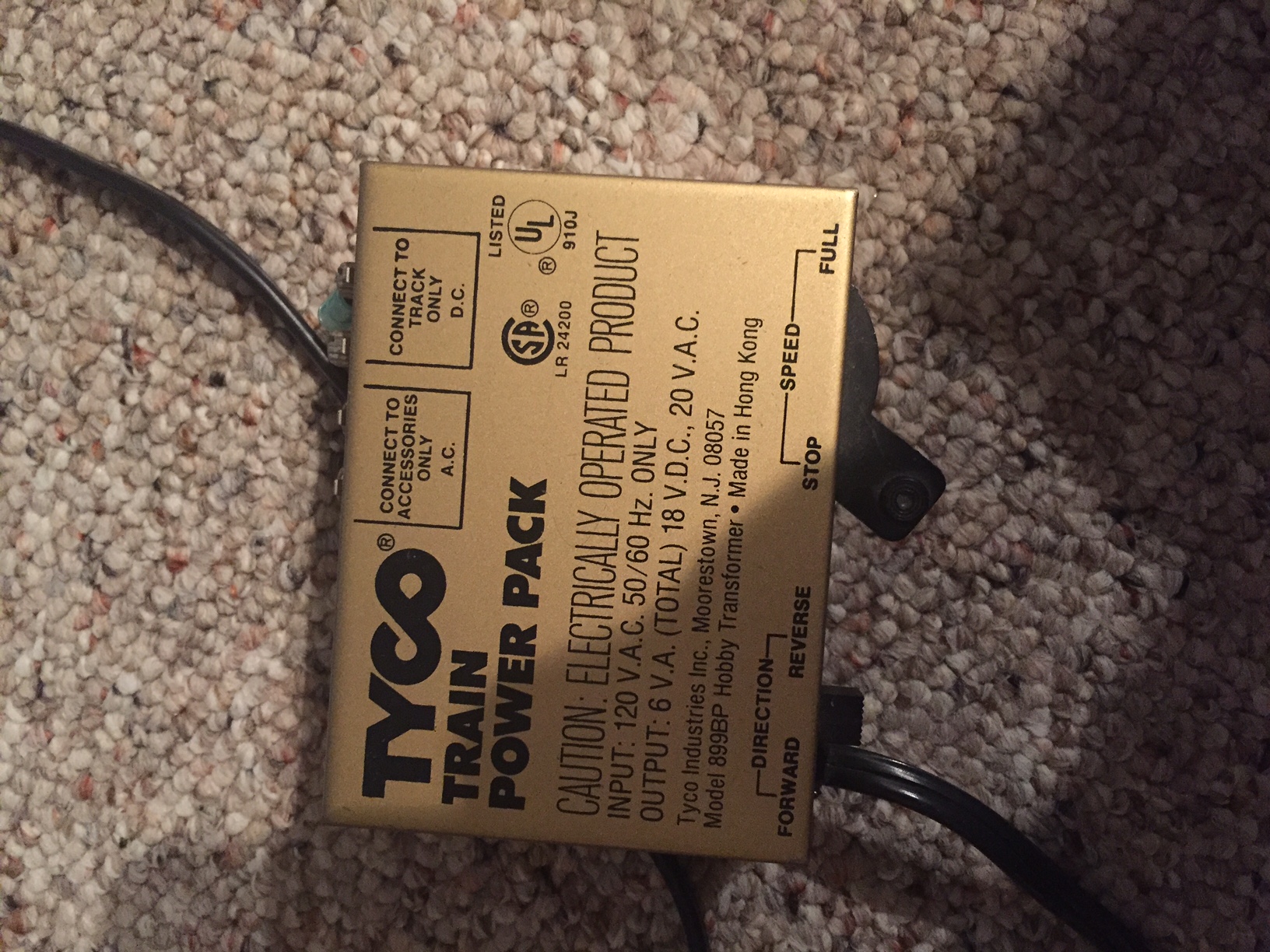

Wiring and electricity basics for trains, simplified - You have a power pack. It has two pairs of electrical connections, one is constant 14 volts, the other is variable ( for the throttle ). Most of the power packs for HO the constant voltage is AC voltage for accessory lighting, you do NOT want to hook that up to the track! Can ruin the engine. Read the power terminals on the power pack CAREFULLY. Only hook up variaable / track power to the rails.
There should be a special Terminal track which has screw connections to it. That is where you hook up the wires. Or it could have been soldered, but I'd look for the terminal track first.
One thing you may want to invest in is a small mulit-function voltmeter. You can get a cheap made-in-China variety for $5 at some auto parts stores, usually red or orange in color, in a free-standing cheap tool bin. A multi-meter is an excellent tool to have when troubleshooting electrical problems. It is extremely hard to diagnose problems without a tool to do it. If you try the "hook it up and see if the engine frys" method, that is not a good way to test it. The SIMPLEST way is to get a small 12-14 volt bulb, and hook it across the rails, and power the power pack up QUICKLY to see if it lights. Try the bulb on the terminal connections FIRST, though, to make sure the power supply is working. Then the track, if no light, POWER IT DOWN, there could be a short. DON'T leave power connected when you don't know if there's a short or not! Only BRIEF trys on the throttle to see if power gets to the track. While the power packs do have some protection, it is not good to leave them shorted for any length of time.
So, to recap - test your power back first, make sure it has power, before hooking it up to ANYTHING. if you have a gold-colored Tyco power supply, like a #889, they are prone to failure, so I'd start by testing it with a small light bulb to make sure it works, then proceed to the track. Again, an ohmmeter/voltmeter is almost required to do any sort of electrical testing to discover problems, otherwise you are just guessing and have no idea what is going on. Even a simple 12 volt light bulb across the track is better than nothing. Radio Shack may even still carry the "bug light" troubleshooter tool, it's a simple wand with 2 triple A batteries and a light bulb, and is used for finding shorts. Do NOT power it with the power pack, or you will blow the bulb AND batteries up! Only use it by itself with no other power to the track if you get one of those.

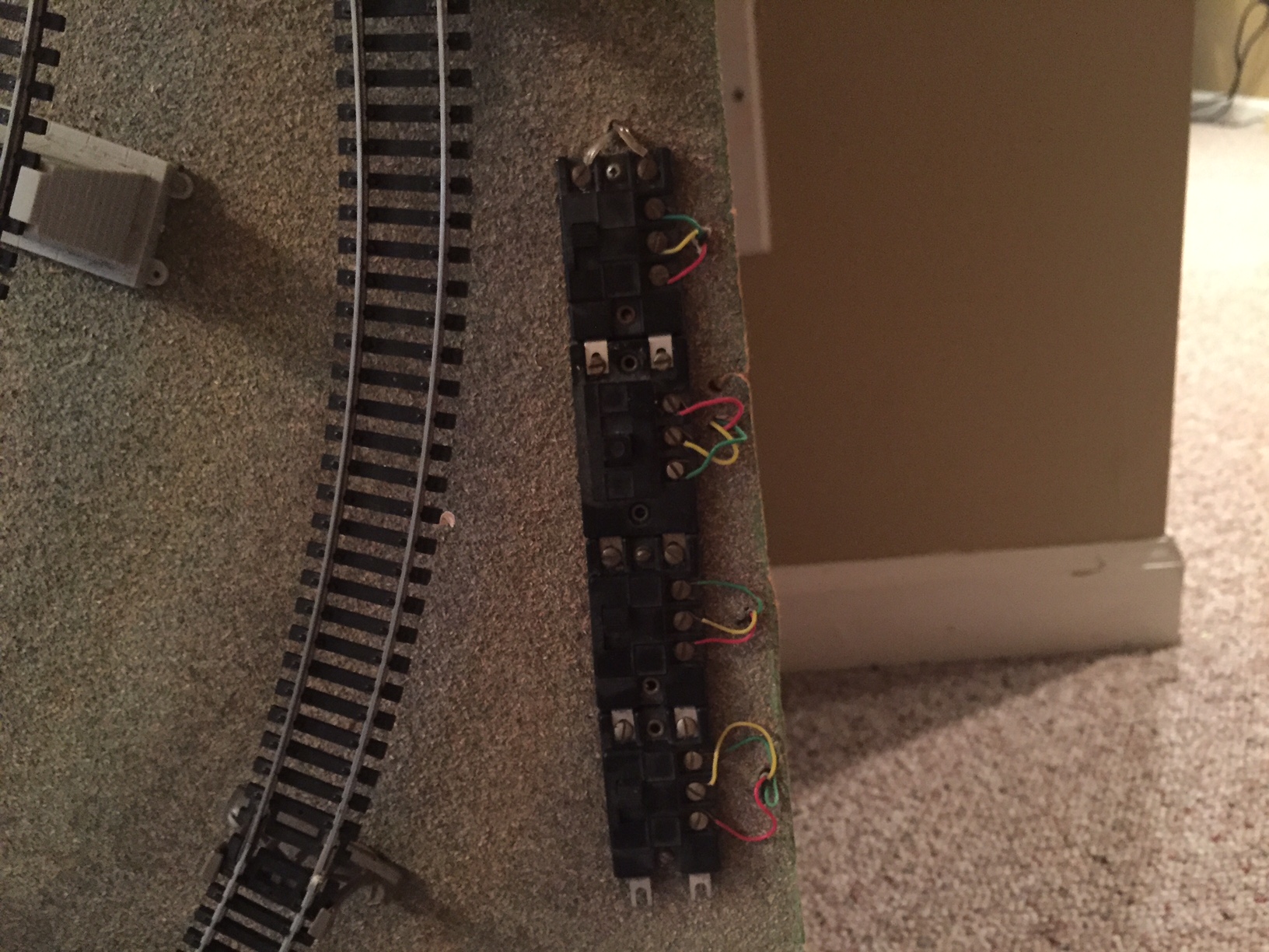

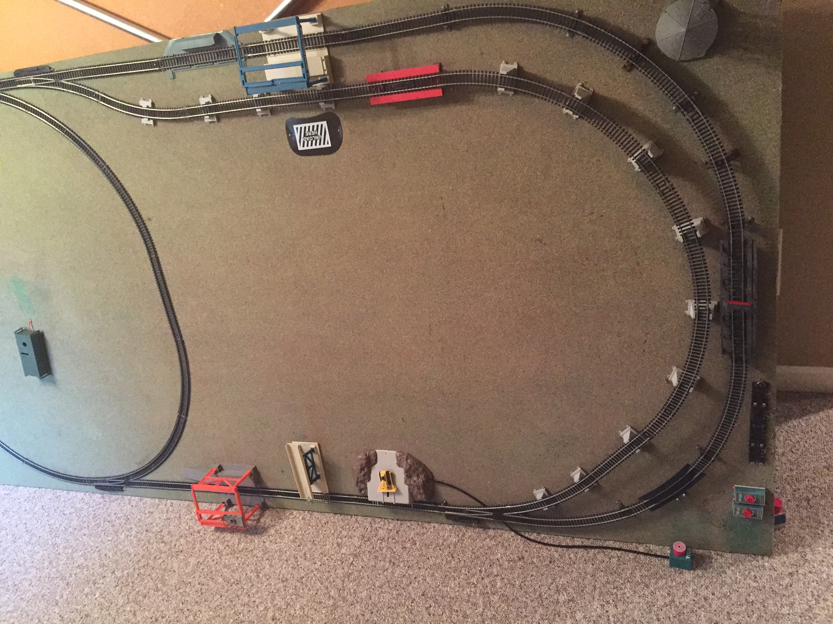

Top of train table, showing very basic layout
Some of the various connectors and such. Red and green wires go to power pack but I do not know which is which

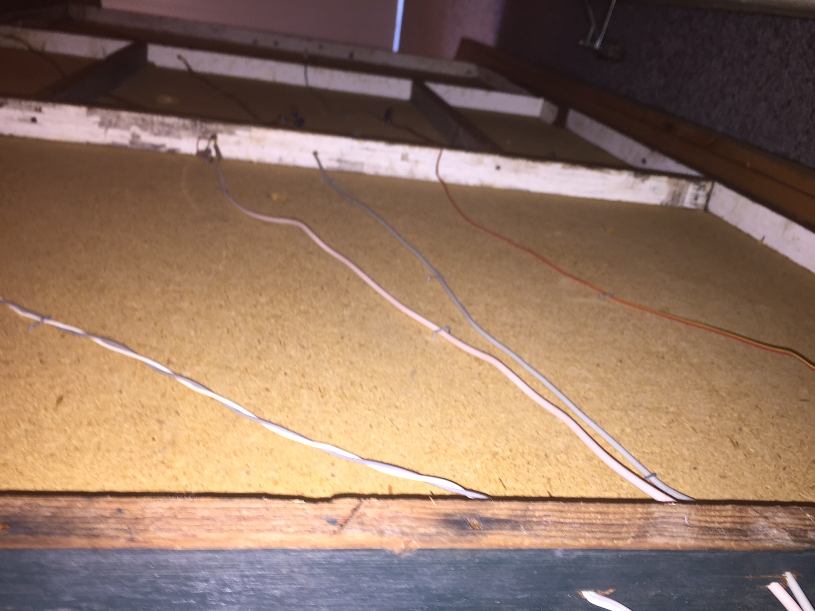

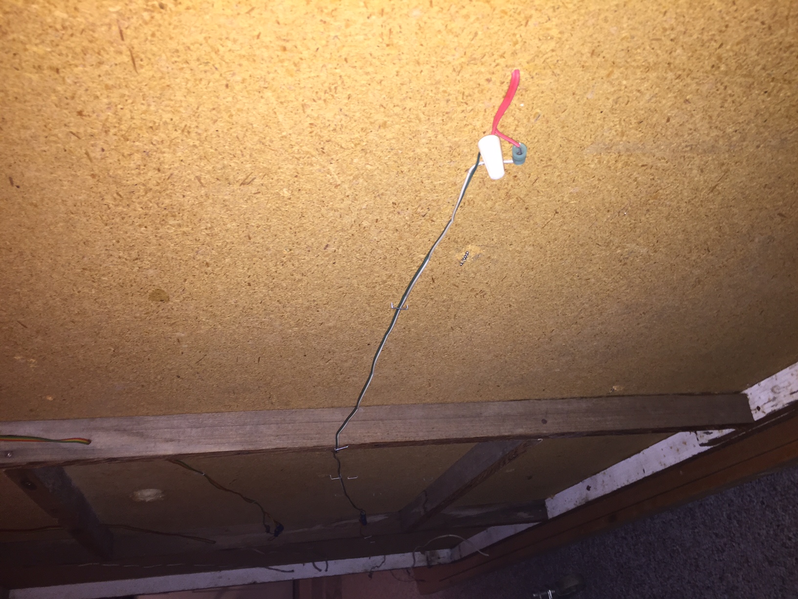

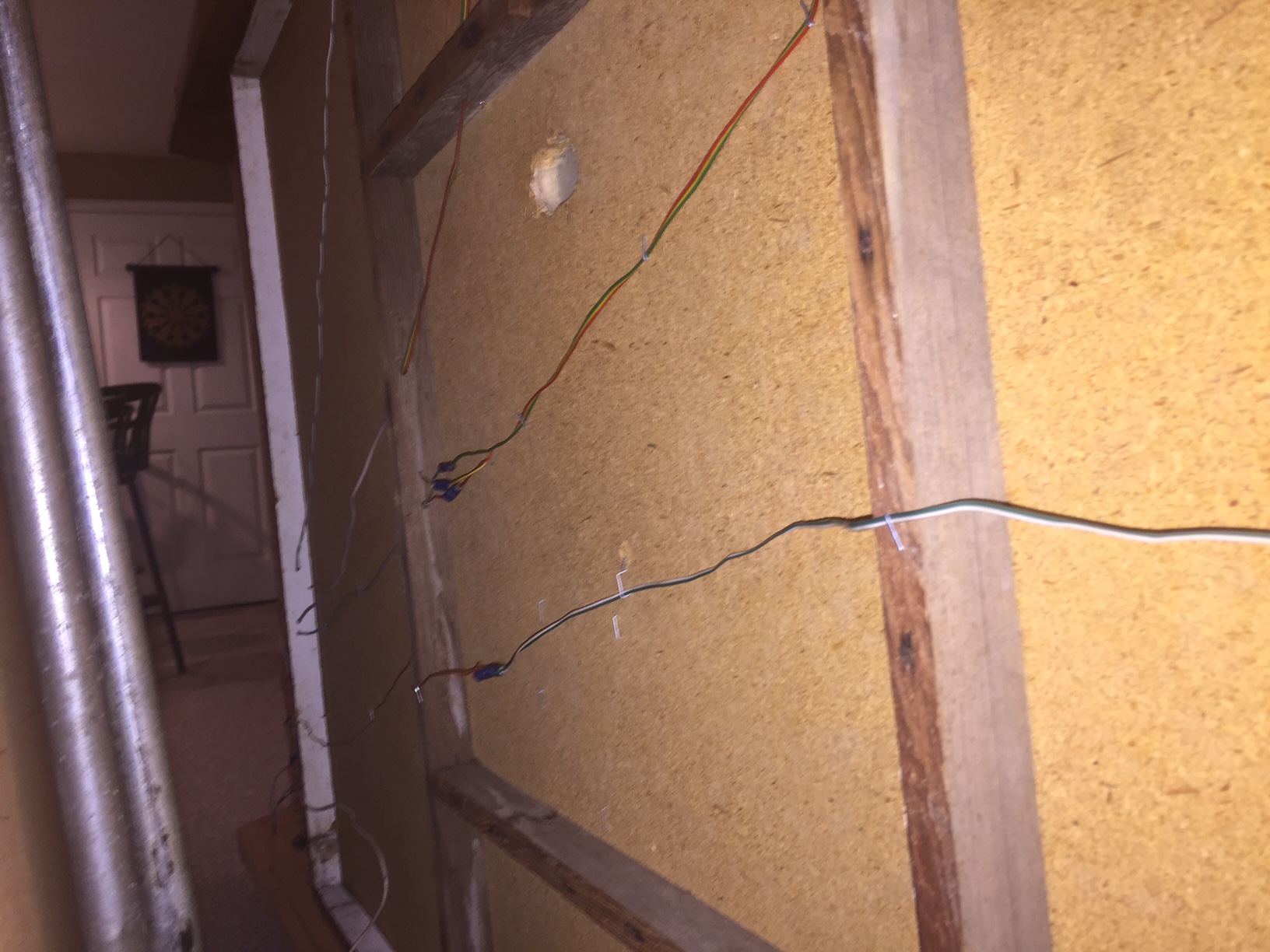

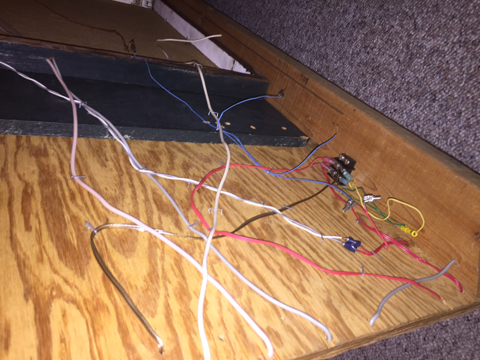

Underside of table, far left, showing most of the wires that are currently disconnected
Underside of table, left center
Underside of table, right center
Underside of table, far right

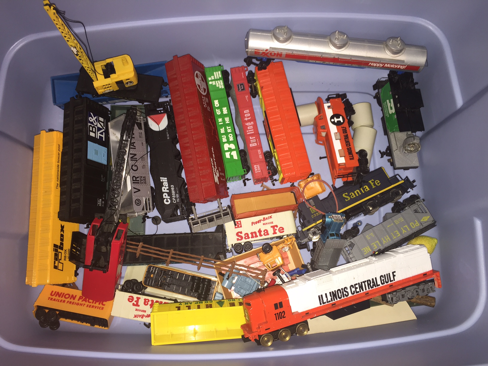

A look at various train cars and additional accessories that came with it
And finally, the power pack

If you look at the track on the left-hand side of the second picture there are two clips for power wires. Your red and green wires (which as you say are for the track) need to be hooked up there. The wires are normally attached by pushing down on the metal tab, inserting the wire into the hole, and then releasing pressure on the tab. If the tabs are deformed you may need to solder them on. I can't tell from the picture where the other ends of those two wires go, but they need to be hooked up to the two terminals on the Tyco transformer marked "TRACK ONLY". It shouldn't matter which wire goes where as long as one end of each wire is connected to the track and the other end is connected to the transformer.
The above should be all that is necessary to run trains (keep in mind the track and engine may need cleaning for reliable operation). All the other wiring appears to be powering the accessories, and it looks like it's been set up so that all the accessories can be powered from a single source.

never seen that Polyethalene car b4
I do sees a Tomica American Truck (Peterbuilt) in there too
the blue frame is a US Steel accessory but missing the crane

Nice little run-around layout, looks like it's in good shape, and the wiring isn't torn loose. As a previous poster said, those red and green wires sticking through the board and going nowhere should go to the terminal track, then the power pack must be hooked up somewhere else, so you need to trace out those red and green wires to see if there is another set hanging loose somewhere. On the underside of that corner is a black terminal block with yellow, green and red wires? going to it. You may have to run the power pack wires from it's terminals to that point, is what I'm thinking. A terminal junction like that is exactly what you would hook a power pack into. Otherwise the layout looks complete and ready to go. You've got a good Tyco base to go forward with.

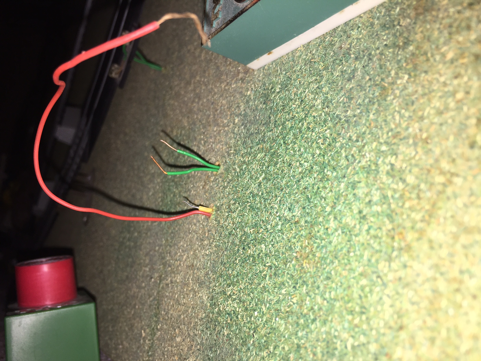

First of all, I looked at the wires a little closer. See the pic below. There are actually two wires coming out of each hole. The one on the bottom has a red and yellow which are for the accessories. The upper one actually has two green wires which if you look in the distance come back up through the board and connect to the track. So that's progress.
Additionally, I had a multimeter so I tested the power pack. It most definitely is working. I need a couple of the little rubber wire connectors in order to take this to the next level, but we are getting somewhere. The question there would be does it matter which wire goes to which terminal? I know the left side is for accessories, but does it matter which order the red and yellow wire go in?
There are still definitely a few loose wires under the table that I need to solve but this was encouraging news tonight.

It looks like the green wires should go to the track terminals on the power pack and the red and yellow wires should go to the accessories terminals.
I noticed a loose blue wire underneath and you seem to have a broken accessories button, there, so you might have to hook things up and test to find what doesn't work. From there, it shouldn't take much to trace a wire back from what doesn't work to what's not hooked up or what's missing.

Yes and no. One terminal is positive, the other is negative. If you want the engine to go Forward when you have it switched for Forward, they need to be the correct polarity ( if you are looking at an engine on the track, it's facing to the right ( ie, forward it will go right, reverse it will go left )), the right side rail gets positive, and the left side gets negative, or the closest rail to you is positive, the one on the far side of the engine is negative/ground. Otherwise it really doesn't make any different,except when you use a power pack with a directional throttle. Since your Tyco power pack DOES list Forward and Reverse on the switch, yes, the polarity matters. It won't hurt anything to switch it, it just won't match the designations on the power pack.

If the red and yellow wire are as you say, for accessories then no it doesn't matter which wire goes where as long as they go on the accessory side of the power pack. Same goes for the track side of the power pack. It doesn't matter which side you put the wires on as long as they are going from the track side of the power pack to the track.
