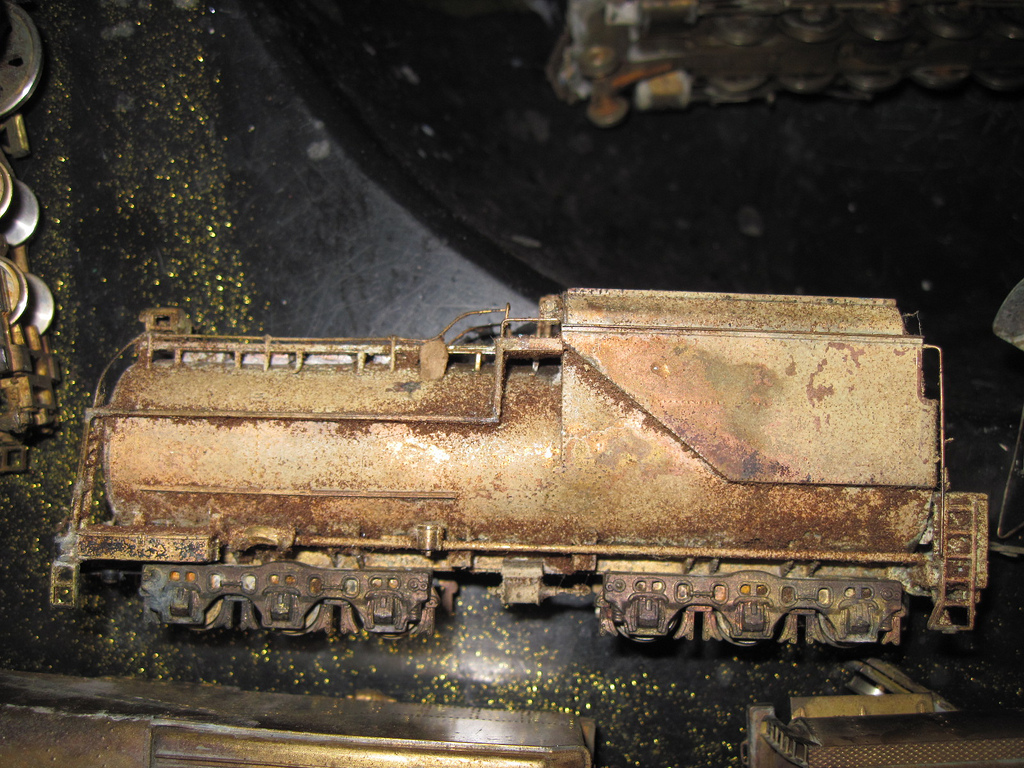

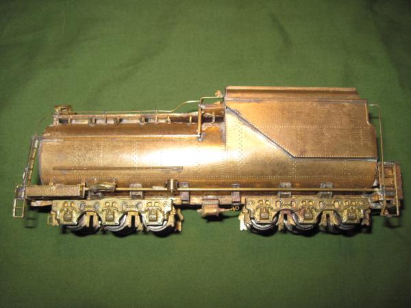

 Posted - August 29 2016 :  5:19:33 PM Link directly to this reply  Show Profile  Add Mustangs_n_Trains to Buddylist
Use Tarnex! Disassemble the models removing any-non-metal parts. Let soak in the solution in a well-ventilated area for about 10 minutes or so, checking on it periodically. It may need more depending on the level of oxidation.
Use warm water and a brass brush to clean it as soon as you remove it from the solution. Then soap and water.
Leaving it in too long will cause the solder to turn black, resulting in the brass turning black.
Here is a before and after example of a tender I cleaned a while back.
