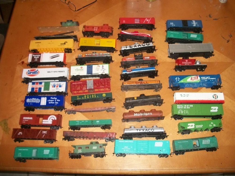

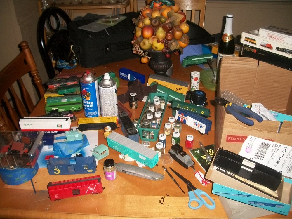

Went from this pile of repair jobs, to this:
Refurbished a lot of missing box car doors, brake wheels, some trucks, etc,
thanks to a little help from the Tyco Forum friends. Moose was able to
rewire a three axle switcher to my delight, and that is destined to become
a fantasy PC switcher. FINALLY got a door for my CNJ box car, although I
had to trim it to fit.

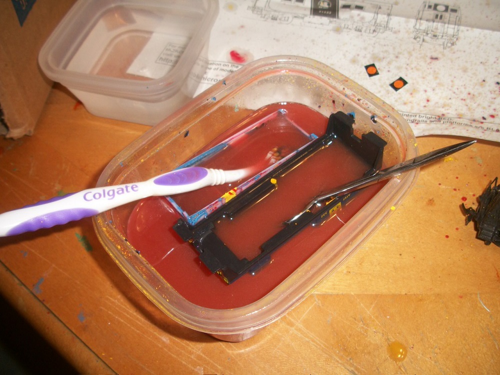

 Posted - May 22 2016 :  01:13:59 AM Link directly to this reply  Show Profile  Add Chops124 to Buddylist
Yep, enamel. Pretty lousy, but didn't cost me a buck for
the lot. Use it for small jobs, but the result is pretty
junky. What strips it?
 Posted - May 22 2016 :  9:41:24 PM Link directly to this reply  Show Profile  Add JNXT 7707 to Buddylist
Testor's enamels are generally thicker, slower drying paints in my experience - especially the gloss colors. I use them for specific small details mostly. But even for that they need thinning so that they flow better without gobbing up on the brush.
Chops, laquer thinner will strip enamels in a heartbeat but will destroy plastic as well. Maybe someone else has some knowledge on what to use. I usually just paint over them like the railroads do.
 Posted - May 22 2016 :  10:53:12 PM Link directly to this reply  Show Profile  Send AMC_Gremlin_GT an AOL message  Send AMC_Gremlin_GT a Yahoo! Message  Add AMC_Gremlin_GT to Buddylist
Originally posted by JNXT 7707 - May 22 2016 :  9:41:24 PM
I use simple Dot 3 brake fluid on my car bodies, and I haven't had any trouble with plastic , the paint will come off with some soaking. I did some removal on a SOO line diesel shell last week, only an hour of dabbing on some brake fluid on the lettering, and it softened it up enough to rub off. So far, knock on plastic, I haven't had any of my bodies destroyed by the brake fluid. I soaked a Marx caboose body for weeks, trying to remove some paint, and never hurt the plastic, but it has some tough paint on it!
 Posted - May 23 2016 :  10:55:05 AM Link directly to this reply  Show Profile  Add Chops124 to Buddylist
I've used the Dot 3 brake fluid with good success in
years past, I'll try that again. The problem is that
I have a hard time finding it.
All the brake fluid
that seems available these days is some kind of
"eco friendly" stuff that has no effect whatsoever.

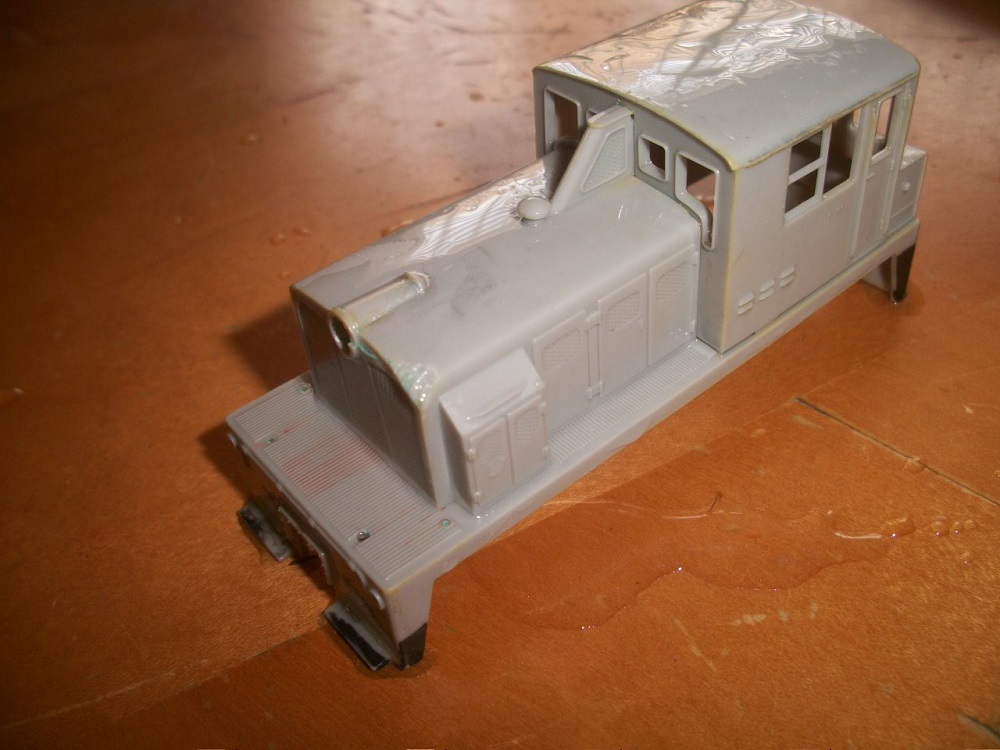

 Posted - May 31 2016 :  01:09:54 AM Link directly to this reply  Show Profile  Add Chops124 to Buddylist
Well, the DOT 3 brake fluid from the Dollar Store worked like a charm.
Last time I tried brake fluid it was some environmentally friendly thing
and it didn't touch the paint- but this ate through the cheap Testor's layer
and stripped off the factory paint nicely. I had in mind a fantasy pea green
Penn Central paint over, but now I have some extra New Jersey Central
decals so I believe I will give it a coat of some red Rustoleum I have lying
about.

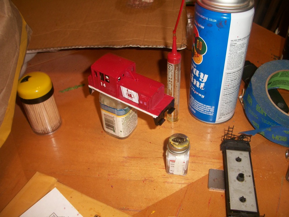

 Posted - May 31 2016 :  3:43:48 PM Link directly to this reply  Show Profile  Add Chops124 to Buddylist
The CNJ repaint is coming along so nicely, I can't stop myself. I want
to repaint every AHM switcher known to mankind. And every Life Like
caboose.
