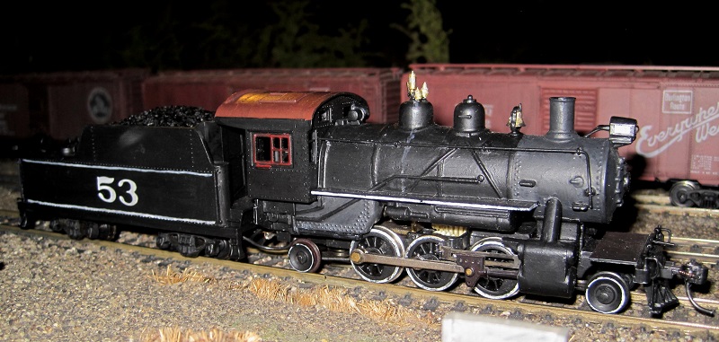

Some time ago, I got a Mantua Prairie with a tender I didn't like and temporarily put a slope back tender behind it:

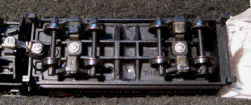

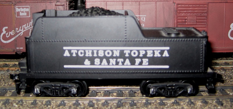

Recently, I was at a swap meet and found a dealer with two tenders from Tyco Power Torque 0-6-0's. He did not have the engines for them and let me have them cheap (2 for $5). Here's one of them:
The body is practically identical to the ones on the Mantua Prairie, but the frame is just a sort of Tyco car frame with truck mounted couplers.

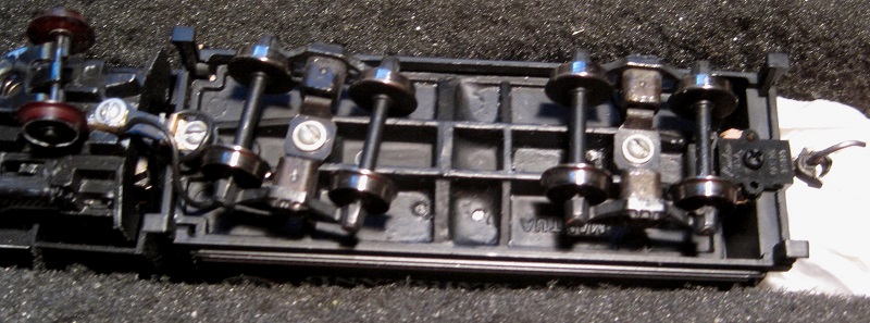

It turns out that the mounting lugs are a direct fit for the frame of a slope back tender and the truck spacing matches that of the Prairie tender. Here's the slope back tender's frame dropped into the new body:
The one difference between this body and the one made for the Prairie is that it has no place to body mount a coupler. I notched the end beam and added a block of plastic at the proper height for a Kadee coupler box:
I drilled and tapped the mounting block and screwed on a coupler:
I like to add a backup light to the Prairie. This one came from the slope back tender. The uncoupling lever was soldered together from .020" bronze wire and test fitted:
Because of the drop-in fit of the body on the frame, this project turned out to be a whole lot easier than I expected. It's still a bit incomplete because I've primed the uncoupling lever and am waiting for the primer to dry. I'm also out of engine black paint, so the project will resume when I have the paint and the time.

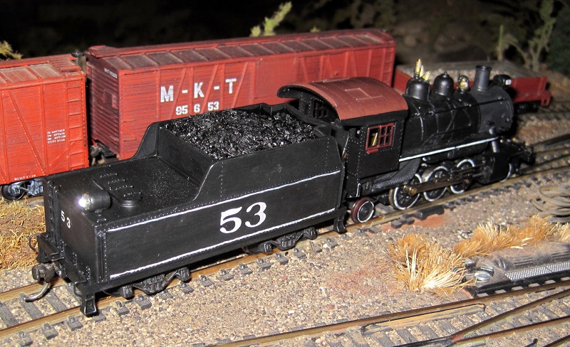

 Posted - June 04 2016 :  3:15:18 PM Link directly to this reply  Show Profile  Add scsshaggy to Buddylist
At last, I got a chance to finish up the new tender with paint, numbers and real coal in the bunker:

 Posted - June 05 2016 :  12:46:31 AM Link directly to this reply  Show Profile  Add oldtimer52 to Buddylist
That turned out real nice shaggy. Really slick.
