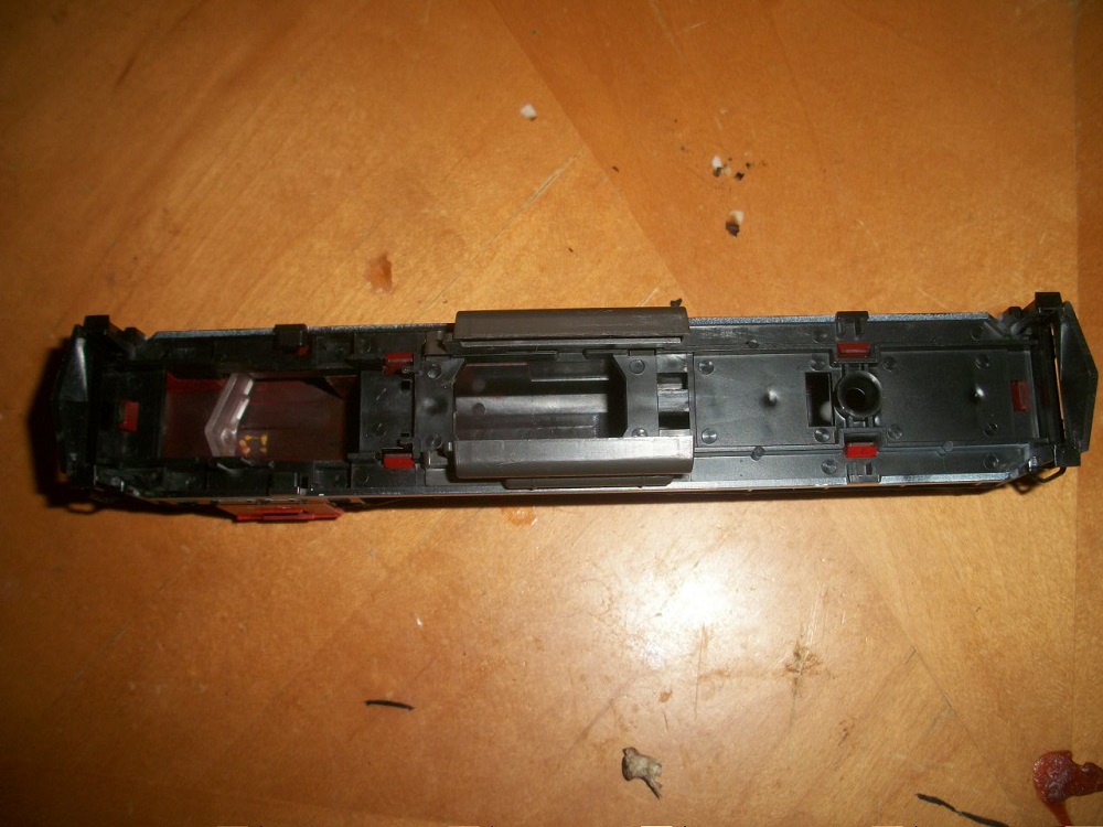

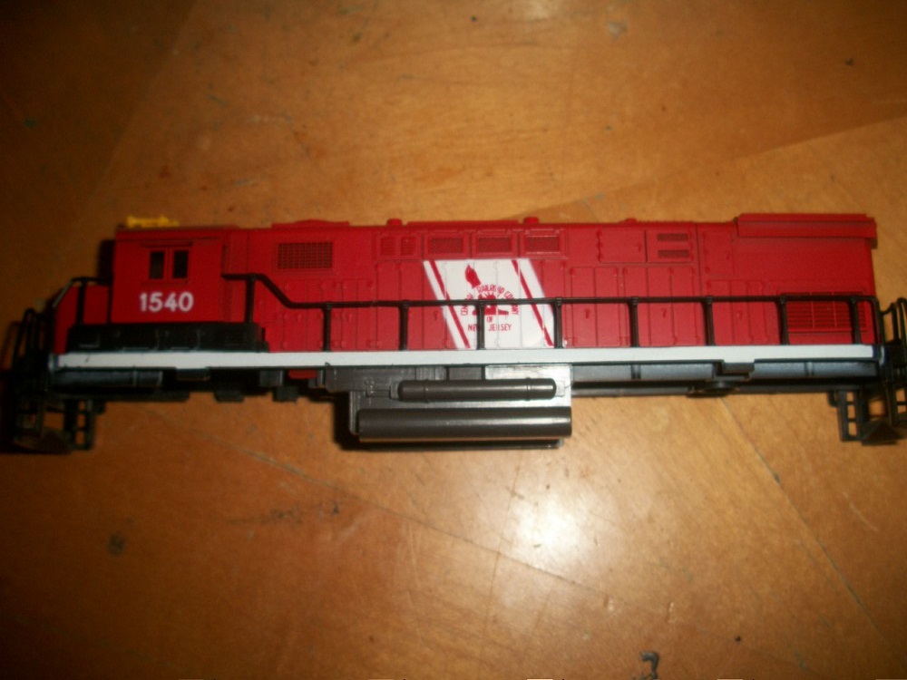

I believe the maker is AHM. The interior of the shell has me a bit confused. Is it possible
to graft an AHM chassis onto this as it stands?
 Posted - April 06 2016 :  11:05:38 PM Link directly to this reply  Show Profile  Add JNXT 7707 to Buddylist
Yes that's an AHM Alco C-424 is my memory is working. I also have one of those, regardless.
Your loco has a chassis, but it's missing the trucks and drivetrain. So I would say yes, you could swap in a complete replacement chassis with a drivetrain, or source the parts from one or two junkers....

Thank you. I don't know an Alco from a hole in my head,
so I appreciate the 411. Now is it just trucks that
fit into the shell, like a Tyco piece, or is it an entire
sub-chassis like a Model Power that would clip on?
Is the weight a separate piece?

If this is the design I think it is, you have both the body and the chassis there. The chassis is attached to the walkways, and the body snaps on to the top with hooked tabs.
The motor is a vertical type driving one truck, which fits into the large hole. If you can find a truck, these are very easy to remotor with a certain type of automotive can motor - I have some that I got once from Jameco - because the worm is a direct press fit on the motor shaft, and after removing the original armature and magnets, the motor tunnel is almost a drop-in fit for the can.

It was made in Austria by ROCO for sale by AHM. Only one truck was powered.

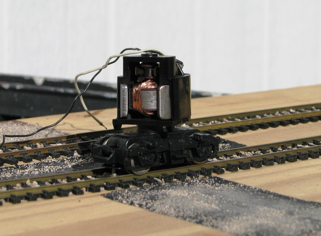

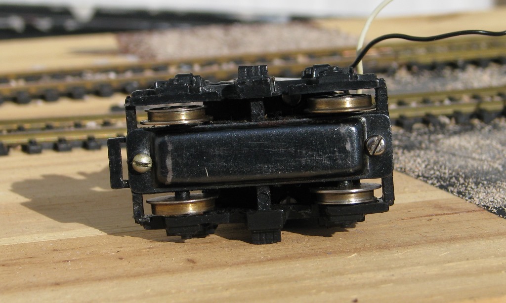

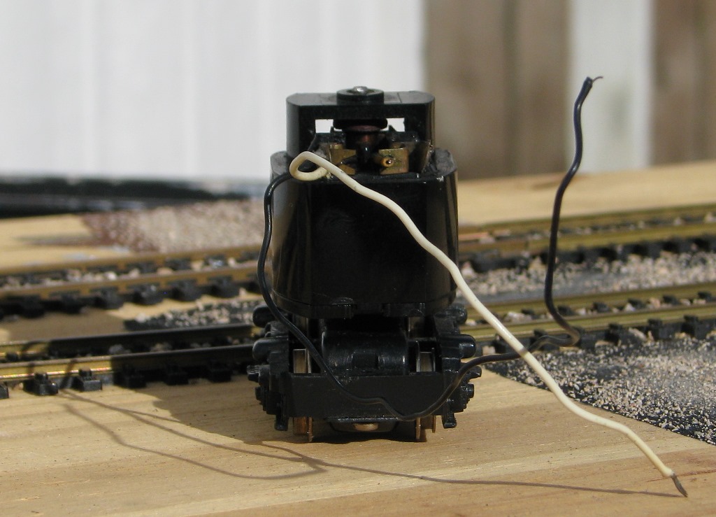

Hey Chops, I have this motorized truck that I think is an AHM. I am not sure if it is a rear or front motor. Maybe someone of the forum can identify it.

Well, that would be pretty fine. The hole in the rear
chassis seems a might small, so I reckon that
would be a front wheel drive. What would you
like in trade? I might be able to get it if not from
my own box, from one of several sources.

I think that truck is from an early AHM BL2. The C-424 that I have, has a single power truck, it is powered by a seperate mounted motor. I think some of the Roco units were sold by both Atlas & AHM.
