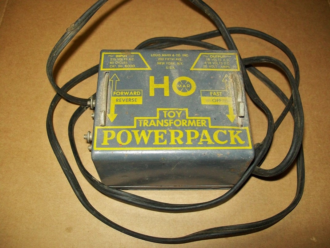

The Marx HO trainset power pack for train sets.
 Posted - December 16 2015 :  6:25:22 PM Link directly to this reply  Show Profile  Add Barry to Buddylist
Looks pretty clean Frank. How does it work? I've been thinking about adding a transformer and wondering if some of them might have more guts and a better rheostat than some of the newer ones?
 Posted - December 16 2015 :  8:51:56 PM Link directly to this reply  Show Profile  Add toptrain to Buddylist
Barry the pack works fine. I keep it with one of my Marx sets.
 Posted - December 16 2015 :  11:22:25 PM Link directly to this reply  Show Profile  Add scsshaggy to Buddylist
Originally posted by Barry - December 16 2015 :  6:25:22 PM
Many of the new power packs are transistor throttles. Because you have no hills and don't seem to do double headers, they're probably pretty safe on your layout. I have obscenely steep grades and big old open frame motors and have toasted a couple of transistor throttles. I still use one in the yard, where it's nice and flat, but on the mainline, I use the old rheostat throttles from Model Rectifier Corp.
MRC made power packs with a lever on the side and ones with a knob that turns about 300 degrees. The ones with a knob have very substantial rheostats that would be hard to kill. That's what I use.
With high current draw motors like the ones on Mantua steamers or blue box Athearn diesels, rheostat throttles work well. They do a poor job controlling a low-draw motor such as you find in a Rivarossi or IHC engine. This can be remedied by wiring an automotive tail light bulb in parallel to the train. I have one wired in with a switch so I can turn it off for high-draw motors and on for low-draw motors.
Some of the power packs come with a switch labeled "pulse" that helps with slow speed movements such as coupling or spotting a car in a very specific place. I use this feature in switching.
