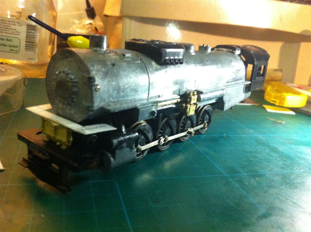

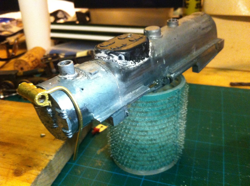

Got started a new project: G+D #42

 Posted - December 09 2015 :  8:06:46 PM Link directly to this reply  Show Profile  Add Barry to Buddylist
Looks like a fun build Erich. On the piece that you added to the boiler, what are the four hatches used for?
Erich
train
 Posted - December 10 2015 :  08:10:50 AM Link directly to this reply  Show Profile  Add Erich to Buddylist
Originally posted by Barry - December 09 2015 :  8:06:46 PM
It´s the sand dome Barry, you need hatches to fill it.

 Posted - December 10 2015 :  11:30:43 AM Link directly to this reply  Show Profile  Add Barry to Buddylist
Thanks Erich. I've only been messin' with smaller locomotives and wasn't use to seeing multiple hatches.

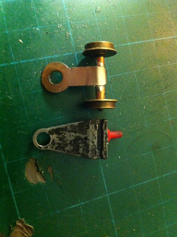

shortened the frame a little bit because draw bar of lead truck is shorter
the shorter one

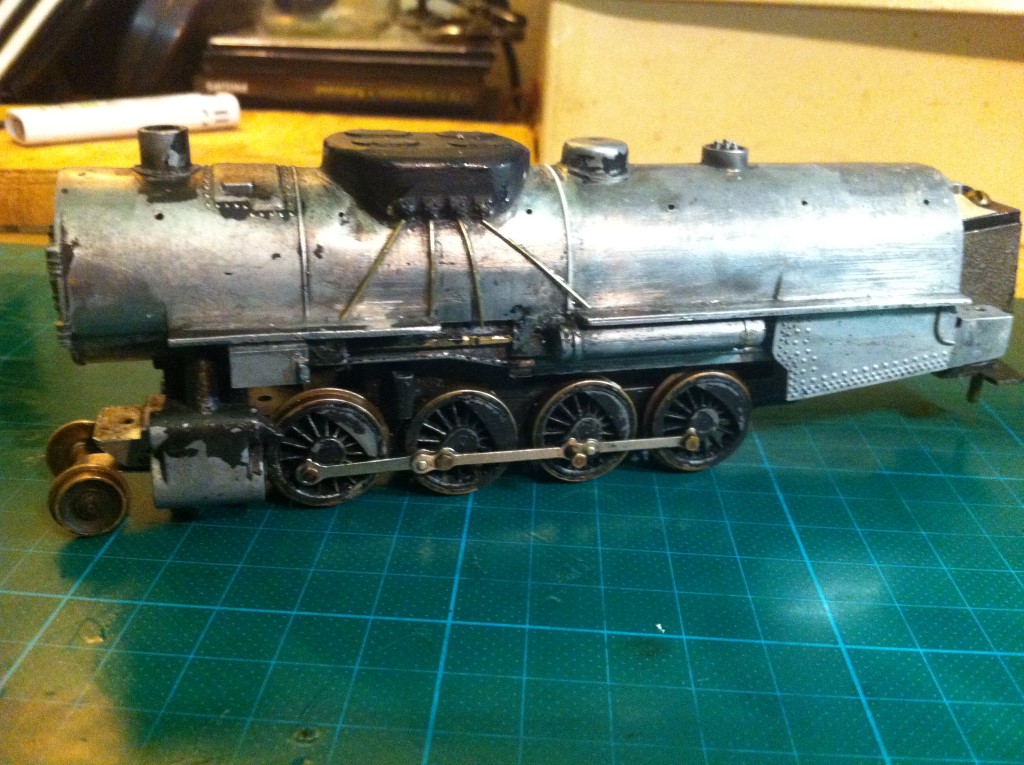

feedwater heater got situated, running boards are shortened, sand dome cemented. ,
sand pipes installed - Erich

 Posted - December 17 2015 :  3:42:38 PM Link directly to this reply  Show Profile  Add scsshaggy to Buddylist
I really like that lead truck design. It looks simple and effective.
Originally posted by scsshaggy - December 17 2015 :  3:42:38 PM
As do I. I'm wondering if it would be possible to modify it to allow for attaching a tension-lock coupler...
This build is shaping up well, I look forward to seeing it completed and running.
 Posted - December 28 2015 :  9:51:37 PM Link directly to this reply  Show Profile  Add scsshaggy to Buddylist
Originally posted by ZeldaTheSwordsman - December 28 2015 :  8:42:56 PM
It seems like if you attached a coupler to something as small and light as that pilot truck, the tension on the coupler would often be enough to derail it. Are you sure you wouldn't rather attach the coupler to the pilot beam?
Originally posted by scsshaggy - December 28 2015 :  9:51:37 PM
I am, yes. When dealing with tension-lock couplers (also known as hook-and-loop couplers), if a loco has a pilot truck then it works better to mount the coupler to the truck. I suppose that given James' overall length and the fact that it's only a 2-wheel pilot I might be able to get away with body-mounting it, but still.
 Posted - December 28 2015 :  11:28:52 PM Link directly to this reply  Show Profile  Add scsshaggy to Buddylist
In that case, with the pilot truck being all soldered brass, it seems like you could just solder on a piece projecting off the end. That could be bent to the desired height and pre-drilled for the screws that mount the coupler.

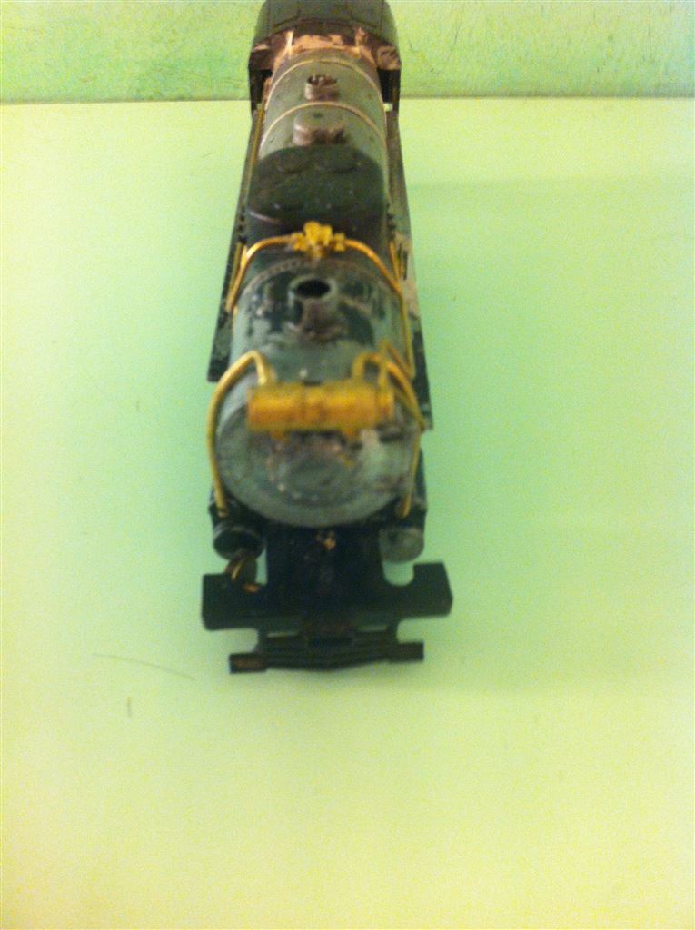

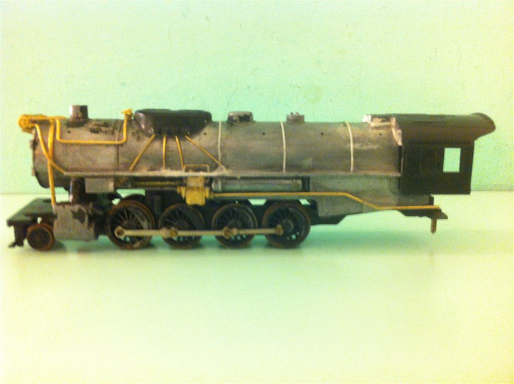

 Posted - February 29 2016 :  06:59:03 AM Link directly to this reply  Show Profile  Add Erich to Buddylist
A little bit of progress. - Erich

That is quite a plumbing job Erich. It also looks like you added a couple of boiler straps as well. I'm curious what material you used for them and what you fastened them with. Good to see your continued postings of this project.
ZeldaTheSwordsman
G2 Slingshot
 Posted - February 29 2016 :  9:57:47 PM Link directly to this reply  Show Profile  Add ZeldaTheSwordsman to Buddylist
They look to be made from flat copper strip.

 Posted - March 01 2016 :  12:35:54 PM Link directly to this reply  Show Profile  Add Erich to Buddylist
Originally posted by Barry - February 29 2016 :  6:11:05 PM
this are common plastic strips like Evergreen glued with with what we call here "super glue"! - Erich

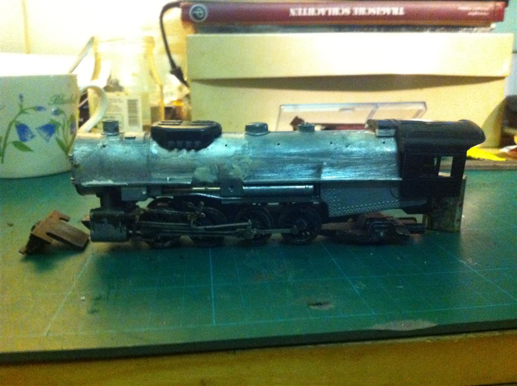

 Posted - March 01 2016 :  1:51:34 PM Link directly to this reply  Show Profile  Add microbusss to Buddylist
when you did start
the loco did look gory
Looking good now
