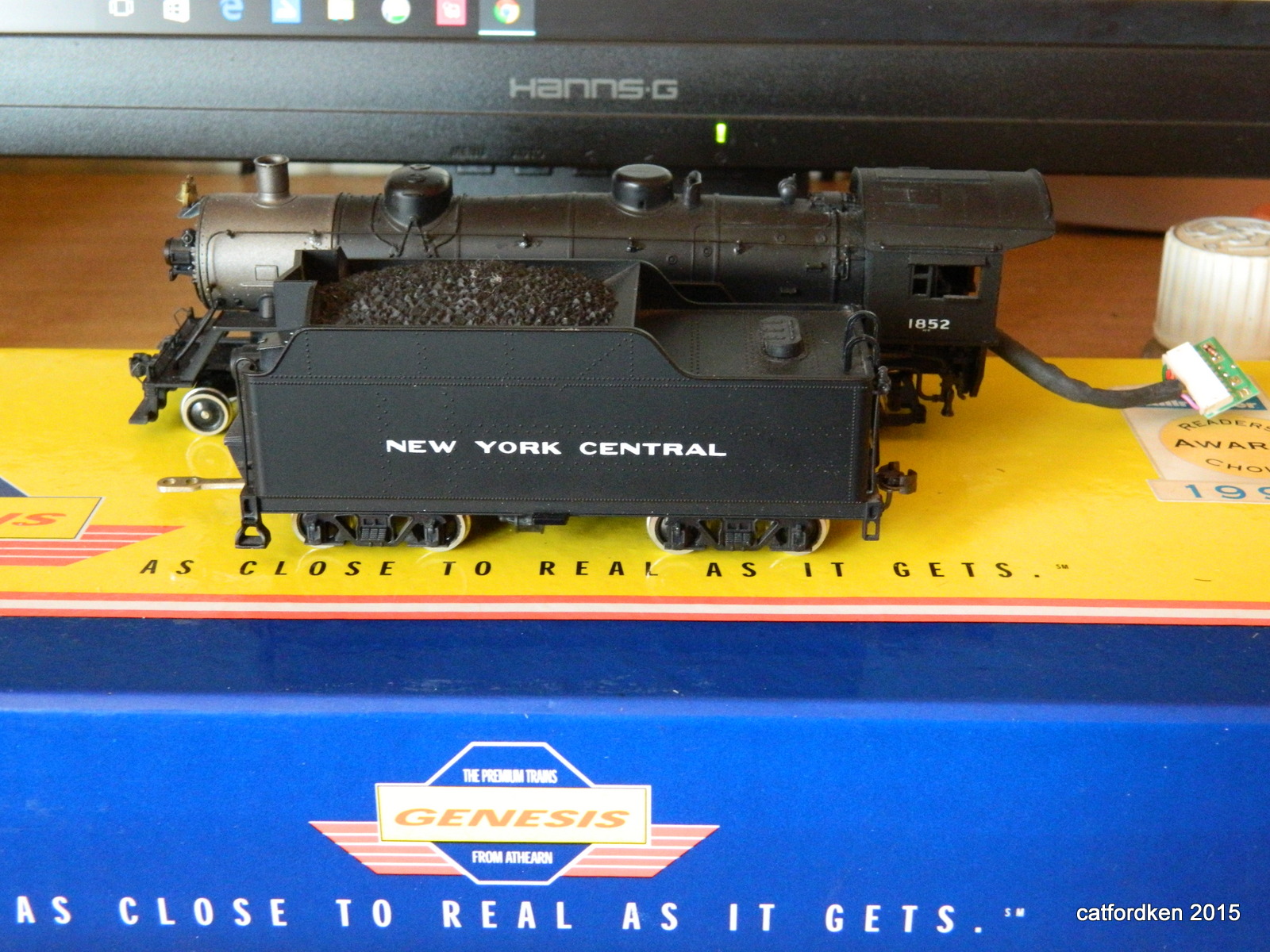

unlike their diesel locos which i consider great value,kit bashers dream locos,their steam locos are a different kettle of fish,the first pacifics,being a mish mash,forever breaking down etc,you would have thought,that the genesis range would be a lot better,user friendly.yes they are smooth runners,that is until the gears split,then the fun starts,getting the body off,thanks to darths great detail of how to remove,it might be feasible someday to actually get it apart,but with my hands/eyes doubt it,shame when a couple of well thought out screws could have made it a great loco,my opinion only
just glad i got mine for a song,under $30,ran nicely for while then just stopped and motor carried on,so it will most likely be a shelf queen till i get inclination to do it
luckily nwsl make the offending parts as athearn do not stock them even though they know its a problem

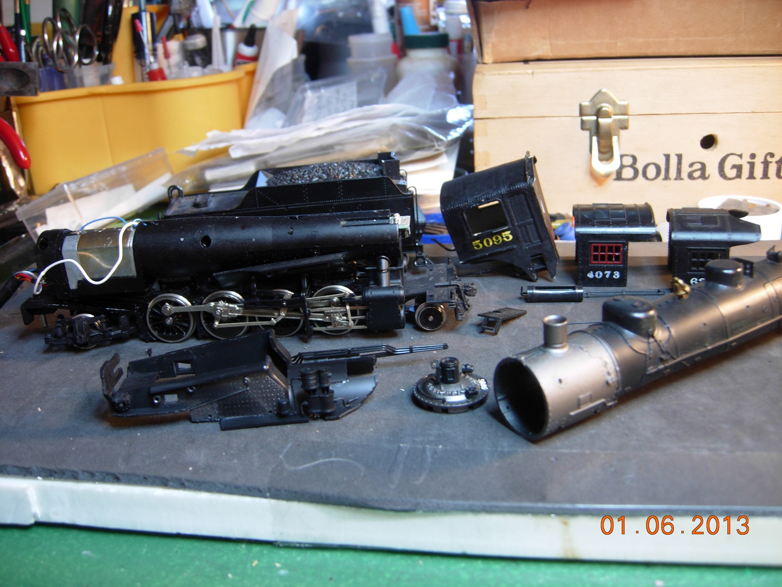

I got my Mikado in a disassembled state, given to me after a serious tumble
off a layout.
One of the trickiest puzzles I've done in a while.
And now you say I have split gears to look forward to.
Sweet!
Evan
 Posted - September 29 2015 :  3:45:33 PM Link directly to this reply  Show Profile  Send catfordken a Yahoo! Message  Add catfordken to Buddylist
oops,what can i say,wish mine was looking like that at the moment,half way there,my advice is before you assemble check it first,would hate to see you assemble it,run it for awhile then for it to crack gears

 Posted - January 21 2016 :  7:27:09 PM Link directly to this reply  Show Profile  Add PGE33 to Buddylist
Ken.
Not sure if you've given up on the Athearn 2-8-2 or not.
I came across the original review for it in Model Railroader mag.
a little while ago.
Removing the boiler shell goes against all common sense.
You do have to almost break it to get it off.
But, once it is partially up, you will see a screw below the sand dome
Loosen both sides, and it's easy after that.
Evan
