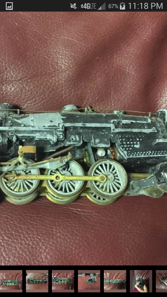

[URL=http://s1228.photobucket.com/user/jdboomer904/media/Mobile%20Uploads/Screenshot_2015-09-07-23-18-21_zpssiqh4al7.png.html] [/URL]
My Varney 4-6-2 needs a eccentric bolt. Hasn't arrived yet. What can I use for a replacement?

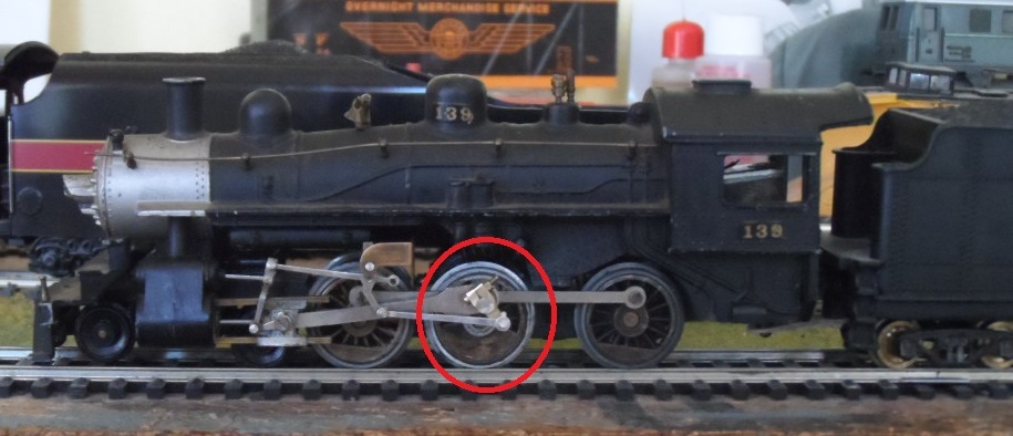

you need cal scale #190-384 eccentrics
and eccentric rivet #1-80007 from Bowser.
did this on my Varney casey jones
hardest part is to get out the old thread maybe you need rivet tool #1-36 too - erich

thats what I did with the parts I listed above
any other parts you need like air pump and feedwater heater? there are selley parts what fit - erich

 Posted - September 10 2015 :  4:17:47 PM Link directly to this reply  Show Profile  Add Redneck Justin to Buddylist
Thanks Erich! I've got another boiler with a nice detail job started I'll use. It's got a pin and not a rivet it seems. I have a donor Casey Jones with valve gear. May try using the bolt.

 Posted - September 10 2015 :  4:31:36 PM Link directly to this reply  Show Profile  Add Erich to Buddylist
Thats Fine when You have a donor One.
You can use the Crank Pin which has a
Hole for a Pin to Secure the crank! In this Case
You dont Need the Parts I sugested! -erich

 Posted - September 11 2015 :  1:03:37 PM Link directly to this reply  Show Profile  Add Redneck Justin to Buddylist
I'll definitely need a rivet! My rivets on hand are too short to rivet the eccentric and it's linkage.
