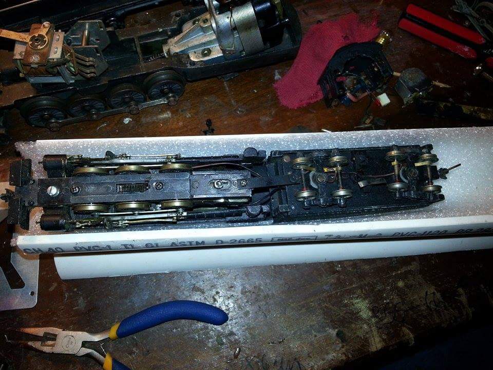

[URL=http://s1228.photobucket.com/user/jdboomer904/media/Mobile%20Uploads/received_1145725625453234_zpsjsv5vyfa.jpeg.html] [/URL] [URL=http://s1228.photobucket.com/user/jdboomer904/media/Mobile%20Uploads/received_1145923795433417_zpspofgxhkx.jpeg.html] [/URL]y recent buy. Has a American Flyer boiler and tender. The chassis has me stumped. It's a smooth runner at best with a nice slow speed crawl. Worm gear directly contacts the axle gear. Not a Mantua by any means.
 Posted - June 13 2015 :  11:31:05 AM Link directly to this reply  Show Profile  Add kovacste000 to Buddylist
MDC?
 Posted - June 14 2015 :  5:36:15 PM Link directly to this reply  Show Profile  Add Redneck Justin to Buddylist
Stephen, it's a MDC Roundhouse to a degree. Seems the chassis and motor is that of a 0-6-0T "Yard Hog" 1989 and up model. I'm guessing the valve gear is either scratch build or from another engine.
 Posted - June 14 2015 :  6:28:11 PM Link directly to this reply  Show Profile  Add kovacste000 to Buddylist
Originally posted by Redneck Justin - June 14 2015 :  5:36:15 PM
MDC has got to be my best guess unless you show what the motor looks like.
 Posted - June 20 2015 :  4:53:07 PM Link directly to this reply  Show Profile  Add Redneck Justin to Buddylist
Updates: Chassis is verified to be a Roundhouse chassis. Has possibly Kemtron brass cylinders and has the rare Kemtron Walscherts valve gear.
 Posted - June 20 2015 :  6:49:26 PM Link directly to this reply  Show Profile  Add kovacste000 to Buddylist
Originally posted by Redneck Justin - June 20 2015 :  4:53:07 PM
Oh, okay. So it's a kit bash using MDC Roundhouse, Kemtron, and American Flyer parts.
 Posted - October 05 2015 :  5:00:16 PM Link directly to this reply  Show Profile  Add toptrain to Buddylist
Your 0-6-0 is a Gilbert PRR B6. The only thing I see different is someone changed the valve gear, and what they but in is wrong. 2 of the rods are to long for this 0-6-0.
