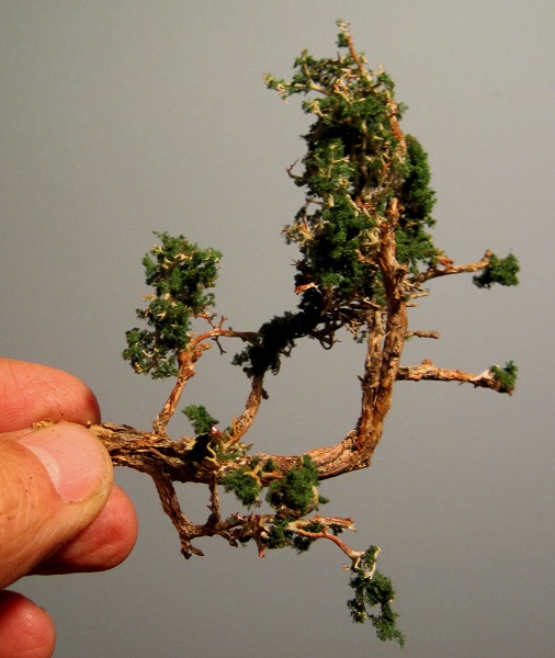

All over the Midwest, cedar trees sprout from the sides of cliffs. They're usually gnarled and scraggly because of their difficult circumstances. On a layout, a little vegetation helps our model cliffs look a bit more like natural cliffs, so I've been pondering how to model a gnarled cedar for a long time. Here's my first attempt:

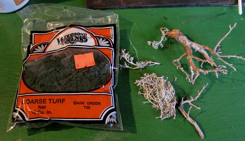

Vacationing in the West, I found some nice dead sagebrush twigs. Vacationing near Lake Superior, I found some reindeer lichen uprooted in a trail through a dune area behind a beach. The lichen, when glued to the sagebrush twigs makes a nice twig structure for a cedar tree. Foliage is ground foam glued to the branches with carpenter's glue.
Since cedar bark is a mix of weathered gray and reddish brown, I drybrushed both the sagebrush and lichen with mottled spots of reddish brown paint. Here are the main ingredients:

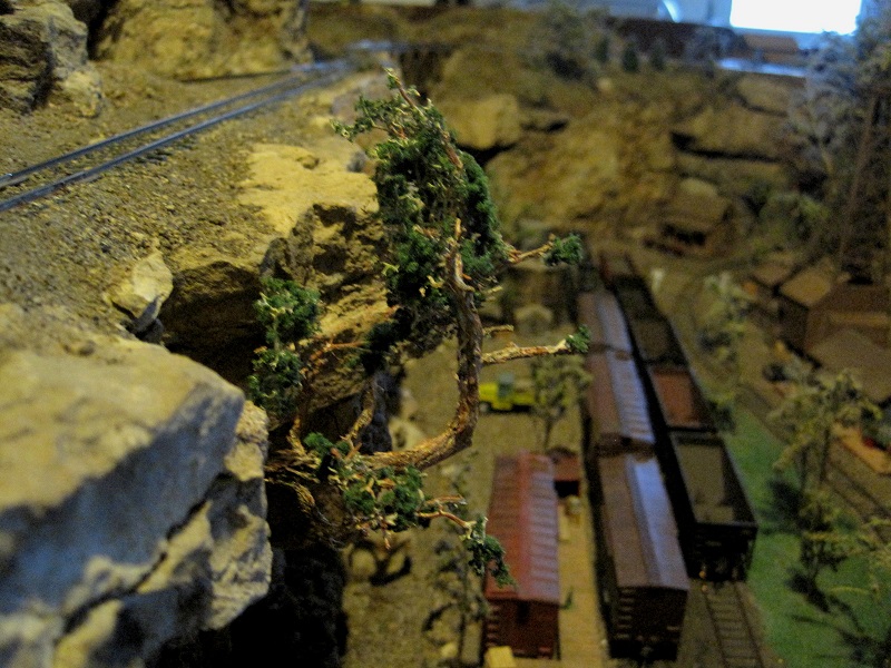

Here's the tree in its natural habitat:
These take a while to build, so you could never mass-produce a forest of them, but in the real world, they grow as a few isolated individuals so there's no demand for them by the dozen.
