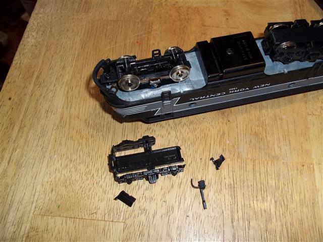

I picked up this Mantua F7 from eBay, and when opened I found that the front wheel frame is broken. Does anyone know where or if I may be able to pick one of these up? Hoping someone can help, I really want to keep this for a future project.
Thanks Blane

I have a couple of different ones, post a picture showing what the side frame looks like.
 Posted - March 11 2015 :  6:33:59 PM Link directly to this reply  Show Profile  Send AMC_Gremlin_GT an AOL message  Send AMC_Gremlin_GT a Yahoo! Message  Add AMC_Gremlin_GT to Buddylist
Well,I see your problem right off the bat - that is NOT a Mantua! Or a Tyco. at least, not a vintage one. Hard to tell without a further close-up, but that's not how the (original) Mantua is designed. Does it say that on the center weight? Looks like a bachmann to me.

Hey Blaneo, Picture looks like you might have all the pieces there? While you're waiting to find a new part, you might try some JB Weld or superglue (sparingly); maybe with some sort of brace you can hide (if needed; tiny scrap) . . . you never know . . . might just hold together. Sometimes that kind of thing works. And sometimes, you can keep the repair fairly hidden. However, I can dig that you might ultimately want an undamaged part.

Here is a couple more photos. And yes it is a Mantua, from the 90"s.
I thought about using some type of adhesive to see if it would hold, and I will do that. The frame snapped apart right at the clip that holds it all together. So I think it will probably just snap again once I apply pressure to attach it back onto the gearbox. But we will give it a try.

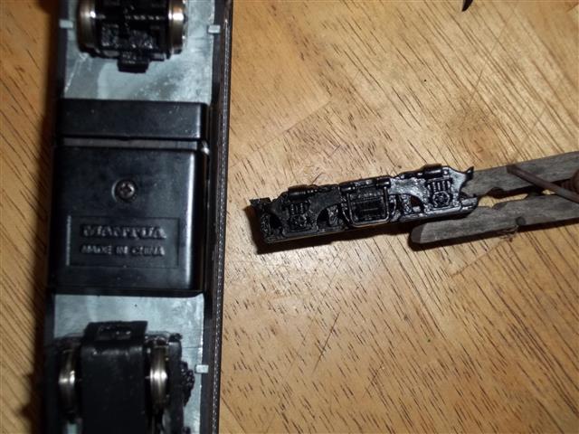

I tried the testors liquid plastic cement, and it did a great job of putting all the pieces back together again. But once I went to snug up the coupler screw I heard a snap. Luckily the truck frame didn't snap apart, only the section where the screw goes into the truck frame. Which as soon as it happened, I realized that there shouldn't be any screw holding the coupler in place. I don't think the hole is the correct size for the screw used. I don't know why I didn't catch that before. As you can see in the first photo, there shouldn't be a screw used to hold the coupler in place, there is no need for it, the truck frame would have held it in place on it's own. I think that whoever did the coupler swap actually broke this to begin with, and that the seller and I just happen to be the lucky recipients of someones wrong doing. Any way, I think it will be okay now, as I have made a few laps around the oval with it, and the truck frame has held together. I do plan to add a thin piece of styrene to the top of the truck frame to reinforce it when I clean and lubricate the model before adding a decoder to it.

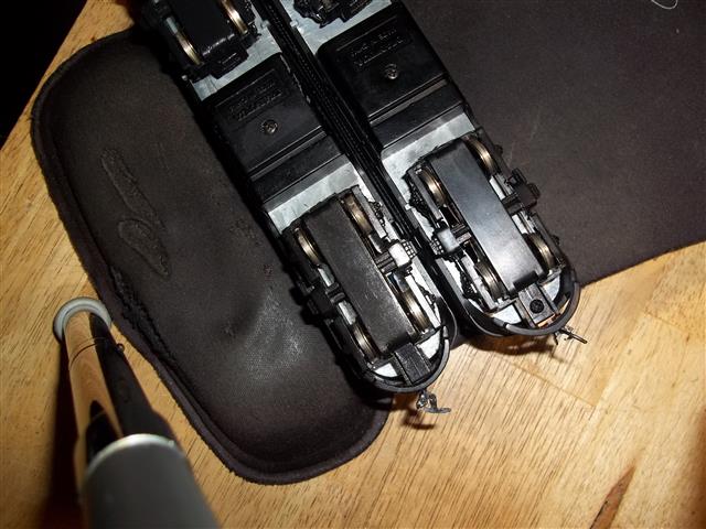

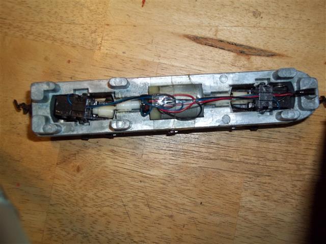

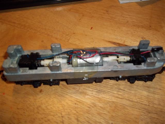

Pics two and three show the drive line for those that asked.

 Posted - March 27 2015 :  9:09:26 PM Link directly to this reply  Show Profile  Add JNXT 7707 to Buddylist
Thanks for posting the pics!
First look I have had at one of those Mantuas. Looks pretty stout! I've been on the lookout for them lately
 Posted - March 27 2015 :  9:54:58 PM Link directly to this reply  Show Profile  Add NickelPlate759 to Buddylist
That's the late 90's red box Mantua with the Mehano drive that I spoke about in the other thread. This is what ran at Northlandz, and Tyler mounted a huge ad campaign to promote them. That's why he was distancing the company from 70's CF Tyco and the old pancake trucks. I have the GP20 version, and it's a very smooth customer. They finally wound up in the Model Power line of locos with reduced chassis weight and minus the Flywheel, IIRC.
The trucks are the same as old AHM Mehano. Unless they made some dimensional changes, the Blomberg sideframes from an old AHM GP-18 should be an exact replacement.
