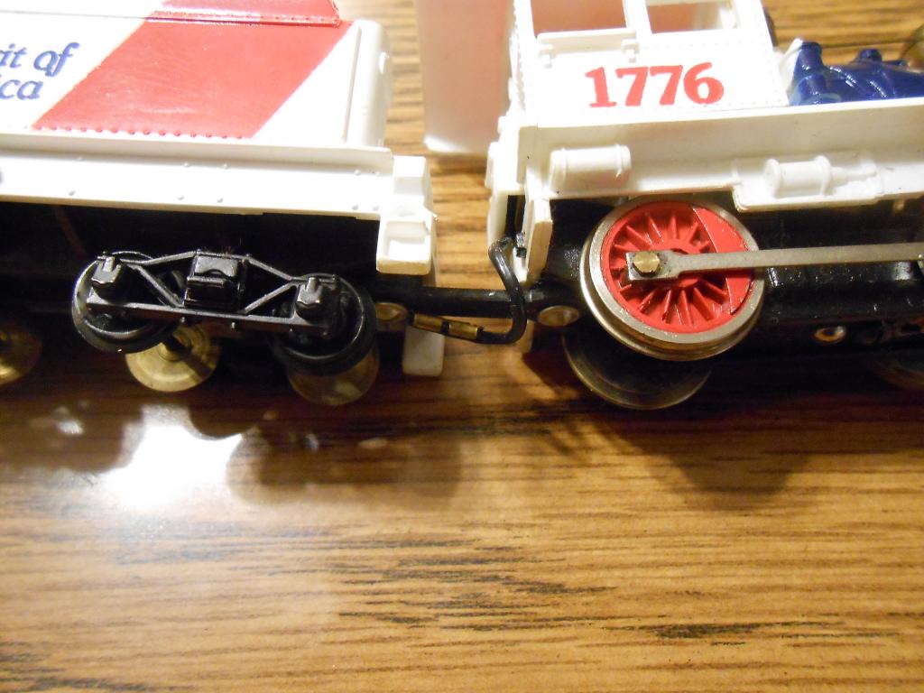

 Posted - January 02 2015 :  5:46:29 PM Link directly to this reply  Show Profile  Send zebrails a Yahoo! Message  Add zebrails to Buddylist
RDC's example shows what I have on my loco's.
It's hard to hide a "thick" cord/pipe.
You may be able to paint a matching shade on the wire insulation.
Perhaps it could act as the water pipe connection.

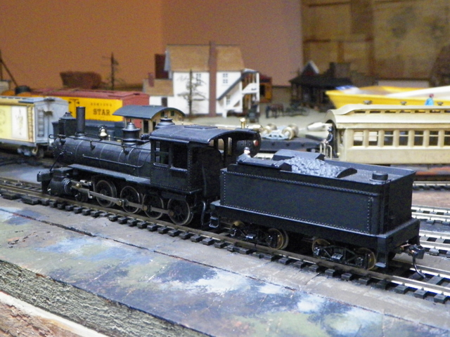

 Posted - January 03 2015 :  12:04:36 AM Link directly to this reply  Show Profile  Add Barry to Buddylist
Hi Patrick, I hope you can tell from this photo how the wire is running. Basically, I got into the habit with the 4-6-0's that I have of drilling a small hole (1/16") just below the firebox/motor cover on the left hand side of the cab and routed the wire through that. What I found otherwise is that the wire tension kept pushing the firebox/motor cover out of the cab.
Routing the wire like this seems tidier to me, but it does make it more fussy to disassemble things, though you could go so far as getting some of those miniature male/female wire connectors.
Otherwise, the wire runs along the top of the left side of the motor and out under the firebox/motor cover.
