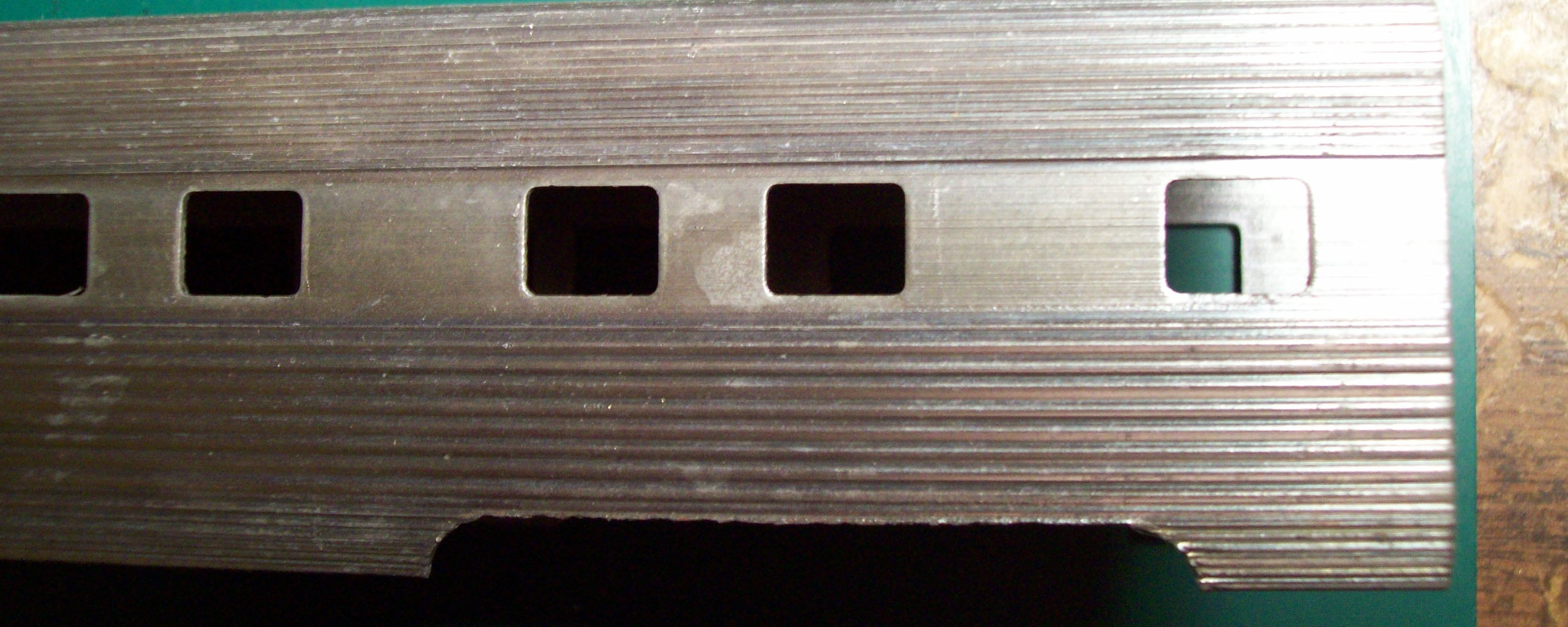

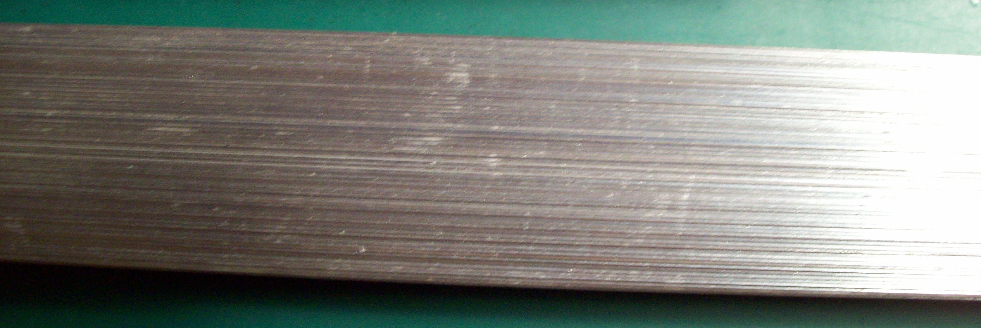

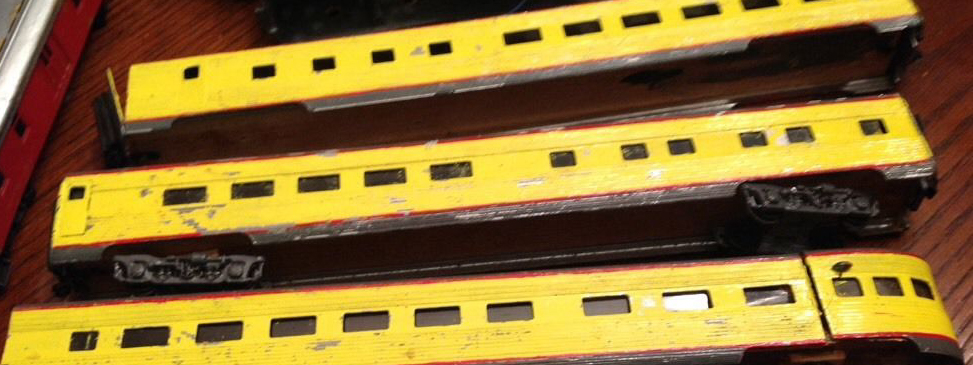

Here are some photos of before and after of some ribbed stream liners that I recently did with the
Super clean.
Before
After
Side of car:
Top of car:
As you can see, there a lot of ridges on these bodies. I put them in the Super Clean and checked them every 20 minutes, using a medium toothbrush to help remove the paint. The paint on the bodies was put there in the late 50s-60s, so it was an older type enamel. Hope this helps ya.
George
