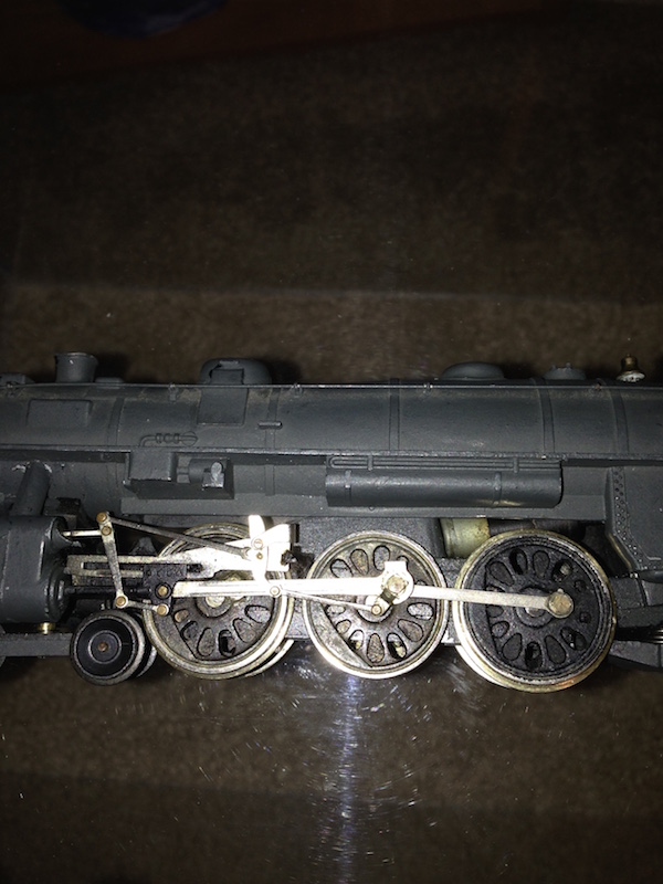

I got a 1950's Mantua Pacific at a train show with a freight car for $30 a month or so ago. But sadly, it had a couple of problems I had to fix. One of them that I finally got fixed today. Unfortunately though, within minutes after my little "victory", this happened.
The linkage for this thing cracked much like those cheap Bachmanns from the 70s and 80s. And when this happened, I heard a crack and the power pack overloaded. After that, anytime I turned the power up, I hear a buzzing sound from the locomotive. First the front truck problem (understandable), next the wire problem (also somewhat understandable), now this?! Good gosh, I feel like this thing is against me.

 Posted - December 02 2014 :  08:33:59 AM Link directly to this reply  Show Profile  Add scsshaggy to Buddylist
What's the other side look like? Usually, when the old Bachmanns did this, it was because the wheel spun in the hollow axle and got out of quarter. Mantuas tend to hold their place on the axle better, so this looks like what would happen if a crank pin fell out or the connecting rod on the other side bent or broke. If so, it might not be a very hard repair.
 Posted - December 02 2014 :  08:49:05 AM Link directly to this reply  Show Profile  Add toptrain to Buddylist
I'm with shaggy, For a Mantua you should show both sides. They don't go out of quarter often. Usually it means a side rod screw fell out. Or you need another driver.

Alright, here's the other side.
Oh, and when this happened yesterday, the wheel on the other side fell off but I was able to get it back on before taking the first photo. On top of that, I do believe one of the connecting rods were bent at some point yesterday, along with the fact that the locomotive started acting up on corners again before that happened for some bizarre reason.And another thing, my parents are calling this thing a piece of junk, I'm wondering if I should think the same thing.

 Posted - December 02 2014 :  09:35:09 AM Link directly to this reply  Show Profile  Add scsshaggy to Buddylist
Well, definitely the fact that the wheel fell off is important. I imagine that when it was acting up, the wheel was already coming loose. I don't know if there's a handy way to fix that or not.
If you have to go shopping for a new wheelset, be aware that there are two kinds of tire. The ones like yours have a lower profile tire and the big pizza cutter flanges. Newer ones have the same wheels and axle, but the tire is higher and the flanges are lower so mixing a new wheel with the old ones would result in different diameters at the tread. That's a bit incompatible when all the wheels are linked together and turning at the same rpm.

 Posted - December 02 2014 :  09:53:00 AM Link directly to this reply  Show Profile  Add Retired Alex to Buddylist
The whole rear driver is out of quarter. Look at the position of the counter weight on the rear driver, I would say approximately 1/8 turn out. All the counter weights should be in the same position relative to each other on the same side.

 Posted - December 02 2014 :  10:38:59 AM Link directly to this reply  Show Profile  Add Autobus Prime to Buddylist
k:
I posted some info about quartering and some Autobus soapboxing over on your other thread. Copypasta here for posterity...
k:
<AUTOBUS SOAPBOX>
Truism: The average person's "junk" is the resourceful mechanic's "learning experience". A person who habitually takes that experience when it becomes available gains insight and pushes himself out of the primeval fog that clouds the average person's eyes when looking at technology. Those who the average person sees as technical wizards (and annoys to death whenever anything breaks) are simply those who took the experience enough times. You've leveled up once with the first fix, let's diagnose this and attempt a fix, and maybe level up again...
</AUTOBUS SOAPBOX>
Your driving wheel is slipped. This happened on old Bachmanns for a different reason. On those, the axles were half-axles, connected by a brittle plastic sleeve. The sleeve cracked and allowed slippage. Your driver has slipped on its metal axle. The Mantua assembly is fixable without purchasing new OEM parts.
The loco probably started having trouble on curves when the driver started working loose. Wheel gauge has to be narrower than the track gauge. Too-wide wheel gauge and the loco will derail, and it will show up first on curves. Curves are curved, and rigid wheelbases are not. Too-wide wheelsets get pinched out.
You can press the driving wheel back on with some Loctite. The Loctite may help keep it in place if the fit isn't as tight as it should be. It looks like the insulated driver is the one that came loose, so no worries about losing electrical pickup on that wheel.
There is one further wrinkle to this learning experience: Quarter. Driving wheels are set with their crankpins rotated 90 degrees apart. This is needed to avoid 'dead spots' where all crankpins on both sides are in line with the axle centers. At this point, forces pulling on the rods could potentially rotate the wheel either way just as easily. This shows up in real life as a crank mechanism locking and binding. You can put together some Lego Technic gears with connecting rods to observe this in action.
At any rate, you will have to set these drivers in quarter. There are jigs for this but they cost a lot. You can do without the jig using a hard, flat surface, a steel straightedge, a reasonably accurate 90 degree square, and a reasonably accurate eyeball:
Hard flat surfaces can be a scrap piece of thick window glass (plate glass is best but modern window glass is probably close enough) or ground flat steel, stone, or iron. A piece of marble or granite countertop might well be flat enough.
Take all your driving wheel sets out and measure the good ones first, in your quartering setup. This will show you what the assembly should look like. Note that the quarter angle does not have to be exactly 90 degrees as long as it is the same on all driver sets.
Wheel gauge (spacing) is also important. If you don't have a NMRA sheet-metal gauge, measure what the other two driving wheelsets are with your 6 inch steel scale, and press yours to the same distance. That should be close, anyway. :)

I second what John said. This poor man's quartering jig looks like just the thing for someone who wants to fix an out of quarter driver without owning every tool in the store for one repair. I appreciate that kind of resourcefulness.
 Posted - December 02 2014 :  6:36:36 PM Link directly to this reply  Show Profile  Add NickelPlate759 to Buddylist
It's hardly a piece of junk. It's a 60 year old model locomotive, and just like the real thing requires maintenance. Just be glad you don't have to re-flue the boiler.
The wheel centers look intact; as others have said the driver just slipped. Mantua axles are only slightly knurled (ridged) on the ends, so it's not impossible for one to work loose. I would take Randy up on his offer if you'd rather not attempt quartering them yourself. Replacement driver sets for these Pacifics are also very easy to find, but newer ones (60's onward) will have smaller flanges.
Nice diagram, Autobus. I have pretty good luck eyeballing it with all the drivers in the frame, then gluing the loose driver(s) once they match and all side rod play is even.

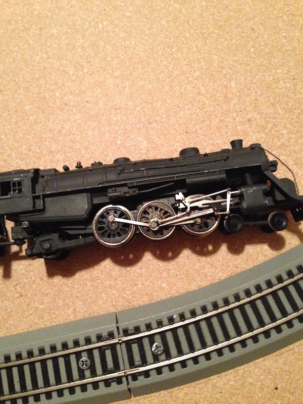

 Posted - January 10 2015 :  11:03:56 PM Link directly to this reply  Show Profile  Add kovacste000 to Buddylist
She's back from the shops and running like brand new now. She even got here wheels cleaned and wire replaced.Here's a photo of her as of now.

 Posted - January 11 2015 :  07:11:10 AM Link directly to this reply  Show Profile  Add toptrain to Buddylist
* Congratulations " Good to see the old girl running again. If you have those Mantua 4-6-2 and 2-8-2 locos you should have a spare set of drivers somewhere for them. It does help and give a little piece of mind.

 Posted - January 11 2015 :  12:20:29 PM Link directly to this reply  Show Profile  Add kovacste000 to Buddylist
Thanks, guys.After I got it back, they told me not to run it fast, which I'm guessing is why the wheel came loose and stuff to begin with. I guess the model is a bit sensitive to that sort of stuff.
