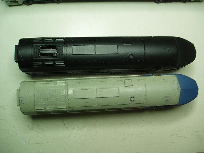

 Posted - September 19 2008 :  12:23:01 PM Link directly to this reply  Show Profile  Add toptrain to Buddylist
Have you noticed their are two different diecast RF16As. It is that one has a solid roof and one has what I think is dinamic brake cooling fan outlets in the roof. They are two side by side elongated rounded holes in the roof. Are their A and B units of each version?

 Posted - October 25 2008 :  8:24:47 PM Link directly to this reply  Show Profile  Add toptrain to Buddylist
The photo shows all. The different roofs on the tyco mantua metal sharknose diesel. One is newer. One is older. I don't know which is which. frank
 Posted - June 01 2015 :  09:34:12 AM Link directly to this reply  Show Profile  Add kovacste000 to Buddylist
Originally posted by toptrain - October 25 2008 :  8:24:47 PM
The top one is the newer version and the bottom one is the older version. I know that because I have the top version and it apparently dates to the late 1950's, which dates the bottom one to the mid 1950's.
