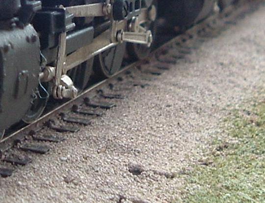

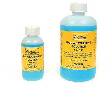

I've read a bit about Mirco-Engineering's Rail Weathering Solution...
I know you can spray paint the rail and I guess ties too and then go back and clean off the top of the rail. However, I'd like to avoid spray painting if possible.
Anybody have some good suggestions and possibly any pictures of finished results to share?

I have not used the solution you are thinking of. But I did use a solution called Perma Blue. It's for reblueing firearms. It does a good job of darkening both brass and nickle-silver rail. As a plus, it seems to conduct current.

I have heard of that solution, but not seen it used.

I saw a picture / URL about a year ago, for a device that was like a paint bottle with a special applicator tip, with a rolling wheel. You could roll in inside the rail and weather that way. I meant to investigate it but forgot - I actually had thought of a similar idea.
I did not weather my rails, but used an alcohol/india ink wash on the ballast between the ties. It makes a big improvement. For some of the rails (in visible areas that I like to stage photos), i went back and painted them with a micro-brush. A pain, but tolerable for a small area.
Next layout I build WILL get the airbrushed rails treatment. Unless that rail weathering solution works well, but I expect that would be slow and messy. But maybe it would work for what I have now...? If you try it, I'd love to hear about it!

The rail weathering solution works great--only drawback is you need more than a bottle and you need a tub up to 36" maybe a little longer for flex track. The trick to this solution is the longer you soak the track-the darker the rail becomes. You have to soak for a while to get results-not sure how it works on switch tracks-only soaked a 9" straight for test. I paint my track with Floquil rail brown. I mask track and then take a sharp xacto knive pressed along tie plates and go down each side then remove excess tape. Ties are still masked exposing only rail and tie plate. I take the strip that is removed and placed on top of rails. Not to tedious
