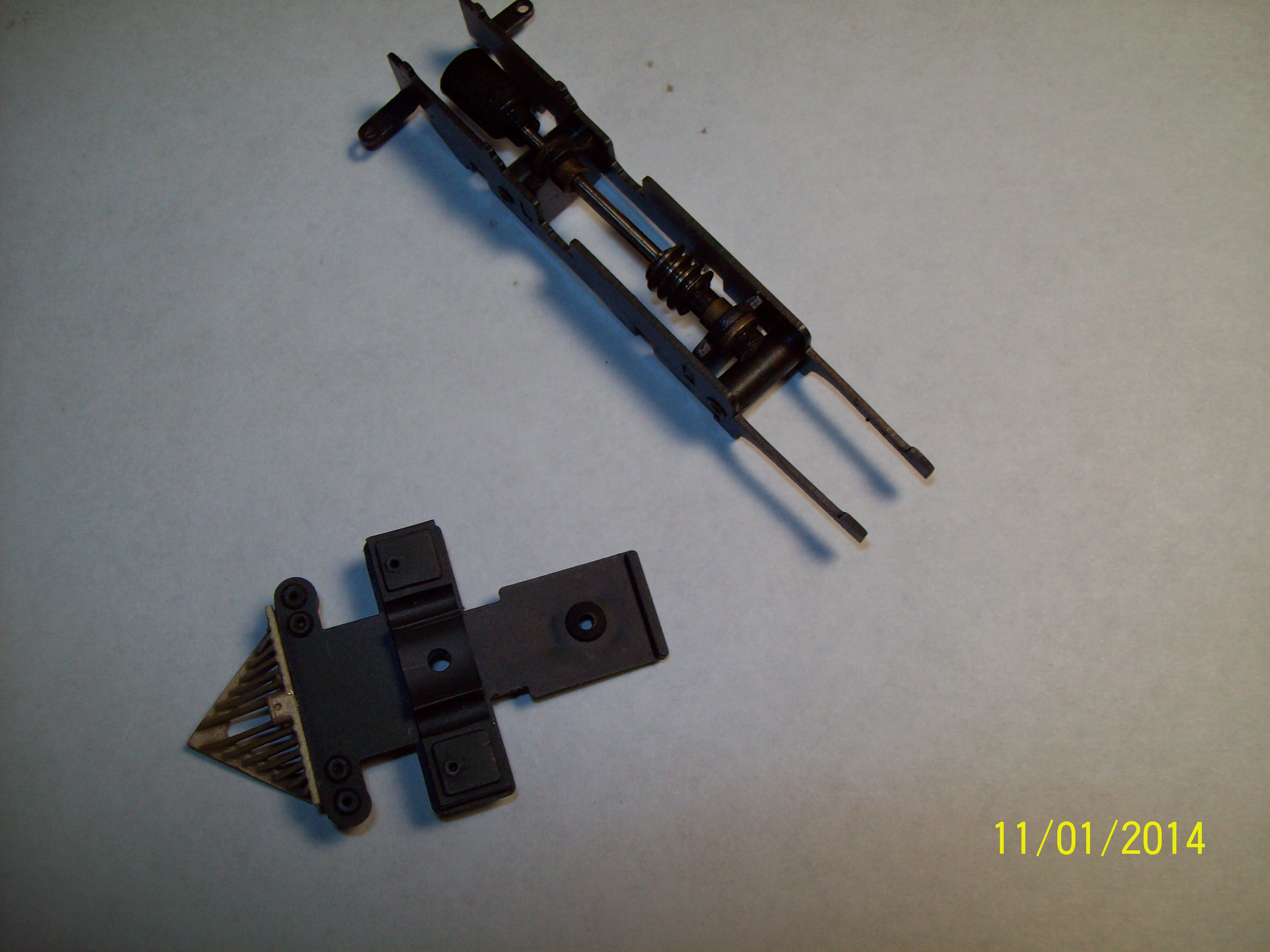

 Posted - November 01 2014 :  11:49:21 AM Link directly to this reply  Show Profile  Add toptrain to Buddylist
The best information I can give to anyone building a locomotive using parts from another is fix or replace a problem when first you see it. Don't do a quick fix.

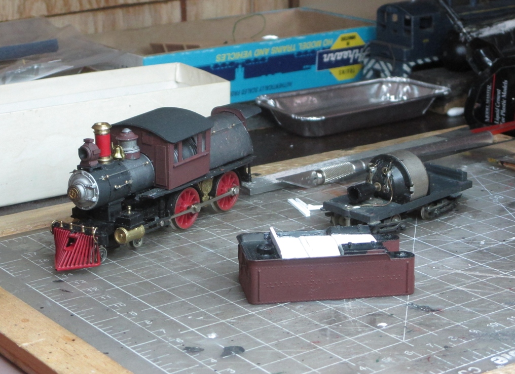

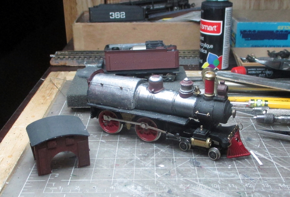

 Posted - November 02 2014 :  7:44:14 PM Link directly to this reply  Show Profile  Add toptrain to Buddylist
A little more dome.
Frank
oldtimer52
0ldtime
 Posted - November 02 2014 :  8:03:09 PM Link directly to this reply  Show Profile  Add oldtimer52 to Buddylist
Now that is starting to really look good. Love the color scheme you chose for it.
George
 Posted - November 02 2014 :  10:03:19 PM Link directly to this reply  Show Profile  Add kovacste000 to Buddylist
It's looking better and better with each new photo you post of it. Good job!

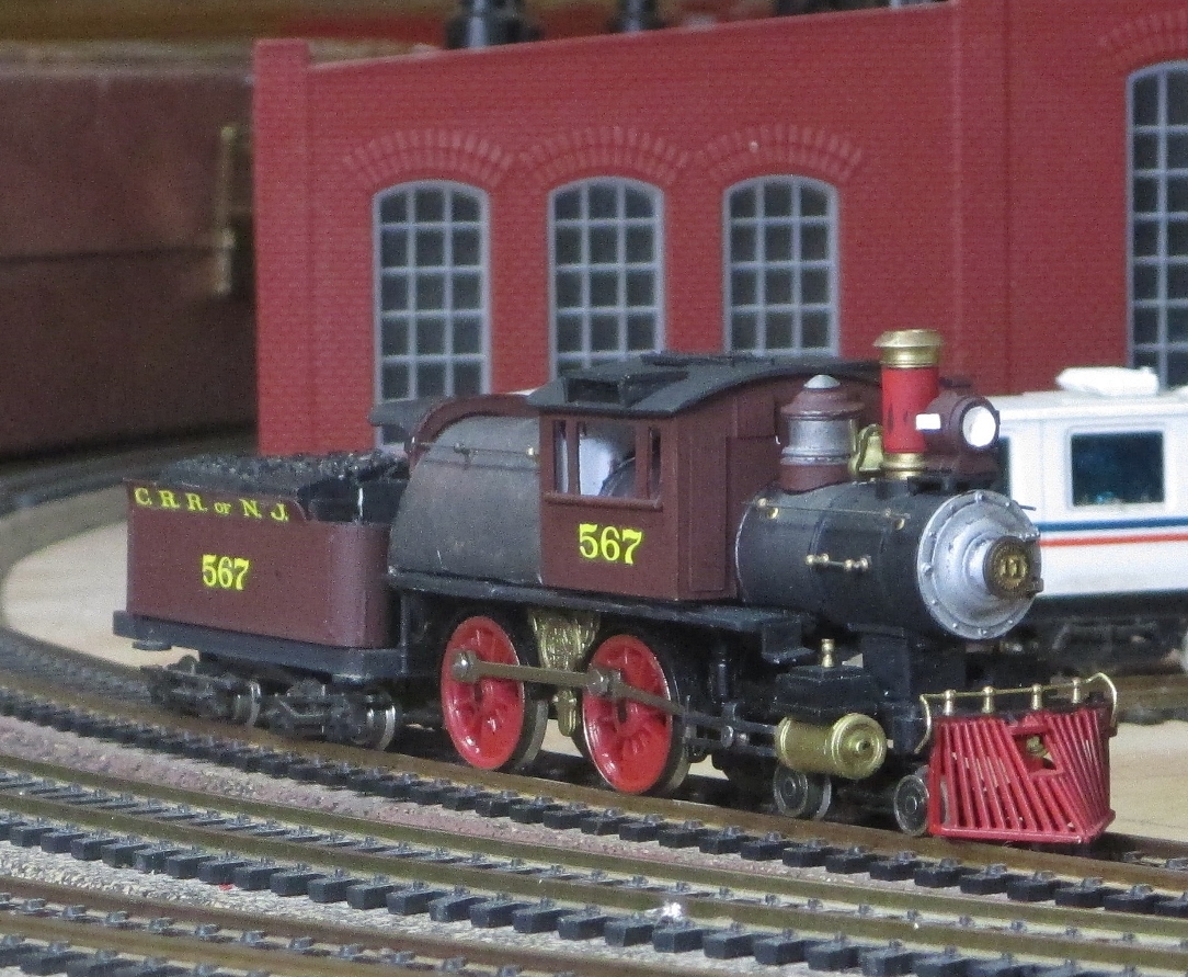

 Posted - November 04 2014 :  5:53:40 PM Link directly to this reply  Show Profile  Add toptrain to Buddylist
Here is the Loco today. Picture taken one hour ago. I started on the tender coal bunker.
 Posted - November 06 2014 :  08:29:40 AM Link directly to this reply  Show Profile  Add toptrain to Buddylist
* Now it is starting to look good. No major structural work left to do. All that is left is the good stuff, details. The things that make a bad loco, look good. The period 1880 color scheme is appropriate for the time and the historic look of this CRRofNJ Ashley built locomotive.
 Posted - November 06 2014 :  09:19:50 AM Link directly to this reply  Show Profile  Add kovacste000 to Buddylist
Nice job, Frank!

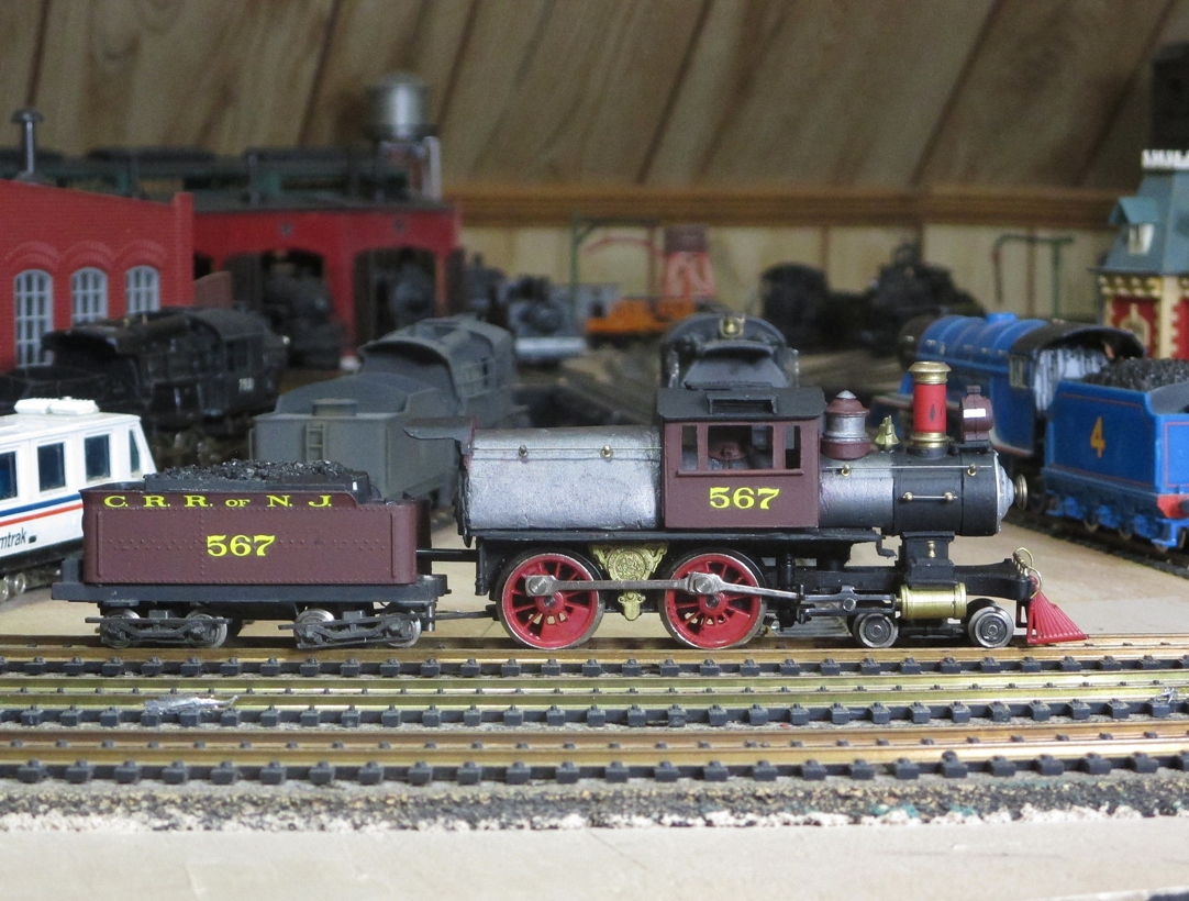

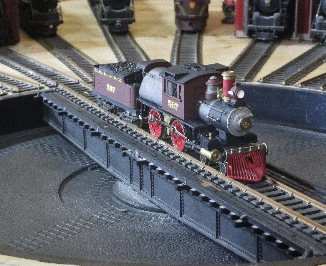

 Posted - November 07 2014 :  1:10:43 PM Link directly to this reply  Show Profile  Add toptrain to Buddylist
Here you can see a few more details have been added. Still more to do.
Edited by - toptrain on November 07 2014 1:11:56 PM
 Posted - November 07 2014 :  9:46:54 PM Link directly to this reply  Show Profile  Add scsshaggy to Buddylist
Is that firebox real well insulated so that the engineers don't roast?
Originally posted by Barry - November 07 2014 :  12:39:08 AM
The silver part on the firebox and the barrel of the boiler represents a boiler jacket. The boiler was insulated (lagged in industry jargon) and the insulation was covered in sheet metal. Some heat would come through the jacket, but not enough to roast the engineer. In non-camelback cabs, the engineer usually sits next to a jacketed boiler, and the open window is enough to make the experience livable.
The rear surface (backhead), where the fire door is mounted, may or may not be insulated. It depends on the engine. I've fired a locomotive with an unlagged backhead and there is considerable radiant heat. It's nice to be able to wander over to the cab door, occasionally, for a rest from the heat. Of course on cold days, that spot by the backhead is kind of nice.

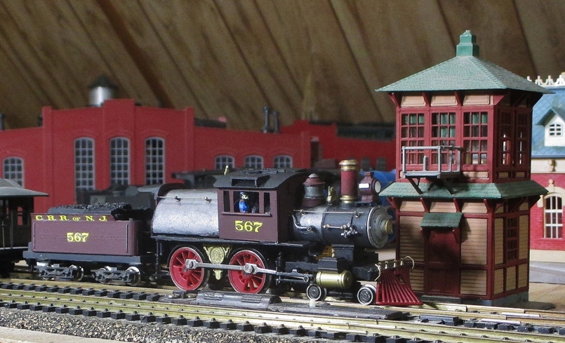

Hi Tim; Now you've read the works of the "frustrated modeler". When the marker lights go on I will call it done. I hate to do a 35 mile trip each way to get a set of them. Hope there at the Edison show. Got to be there sat the 29th and sun the 30th anyway. Its closer.

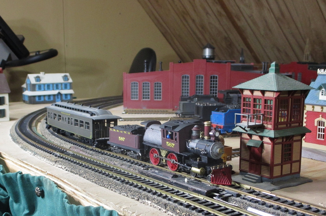

 Posted - March 30 2015 :  07:27:13 AM Link directly to this reply  Show Profile  Add toptrain to Buddylist
I should have put this in sooner. A link to 567 running. It is a special so flying white flags on its front pilot.
https://www.flickr.com/photos/30431536@N03/15347614624/
wildecoupe
Conrail
 Posted - March 30 2015 :  08:44:25 AM Link directly to this reply  Show Profile  Add wildecoupe to Buddylist
That thing flies! Looks good!
Tim
 Posted - March 30 2015 :  10:56:37 AM Link directly to this reply  Show Profile  Add Barry to Buddylist
Frank, that locomotive looks great. I kept playing the video over to see if the flags were actually waving. I'd like to see a video of it cruising along a bit more slowly.
