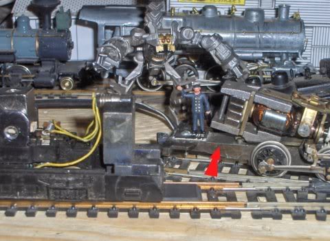

...OK, the NdFeB magnet tip is the same trick that a half-dozen people here already use with old open-frame motors. Many of the older ones out there have weak or deteriorated magnets, which make the motors draw more current and run faster for a given voltage. Replacing the deteriorated old magnets with a stack of super-strong rare-earth magnets makes the motor run better than new...slower and with a reduced current draw. It's very dramatic with the PM-1 used in Mantua and Tyco's cheaper locos.
Photo:

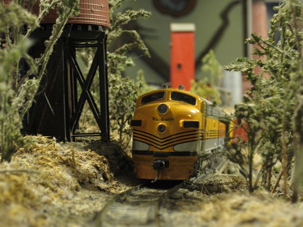

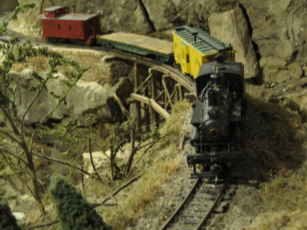

Goldenrod is a prairie plant, found throughout the Midwest, that when dipped in watered down green latex paint, makes for cheap, effortless trees. They're a bit fragile, but if they're broken, they're easily replaced.
I keep a supply of old frayed manila hemp rope around for high grass. Cut it to the desired length and plant it in a thick layer of white glue or carpenter's glue. Sprinkle some sand in around it and glue it down with thinned white glue to have something that looks like the ground at the base of the grass. Dirty, dusty sand is best.
You'll also notice some conical trees standing in for red cedars. These are some cores of spruce cones that I found after pine squirrels had stripped off the scales. They're covered in green ground foam. There's no guarantee that you'll ever find cones so properly proportioned, but they illustrate that it's handy to have an eye out for potential scenic materials.

Those trees look great! The pine cone idea is clever too.

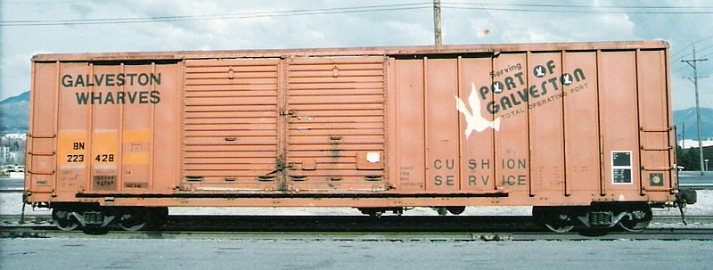

Some decal sets, like the Herald King decals, have information or instructions printed on the side of the decal paper. I always save these, as i can use them for lettering and numbers, such as this BN patch on a Galveston Wharves boxcar. Although you can't really see it due to the poor quality of my camera, the reporting marks and numbers have been patched out and replaced.
A picture of the prototype, from the internet.

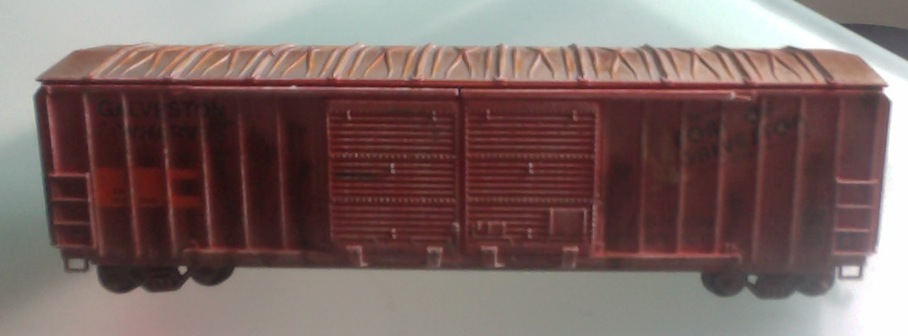

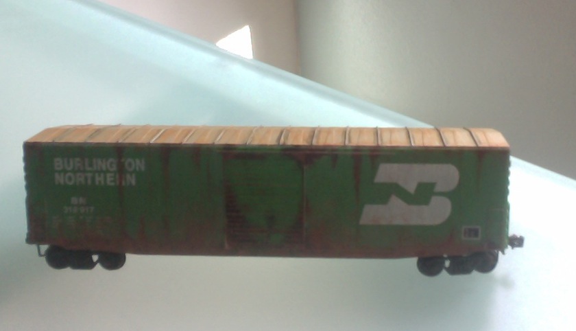

You don't need fancy brushes or an expensive airbrush, just dab the paint on with a sponge to create realistic rust patches:
