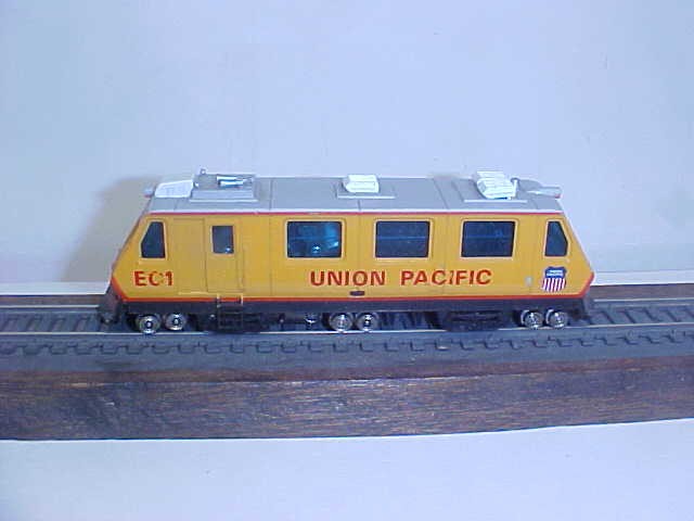

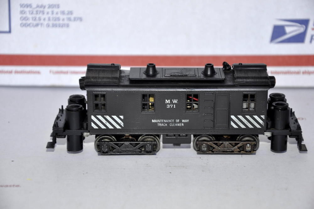

I've got some areas of track, as I imagine everyone else does as well, that are real easy to avoid when it comes to cleaning things up. You know where you're climbing around might cost you an hour in repairs if you don't watch it. So, I know there's some deluxe track cleaning cars available and some track cleaning locomotives and I got to thinking that it shouldn't be impossible to build one from an old junker locomotive sitting around. What got me to thinking more about it, was reading one manufacturer's admonition to make sure and have the locomotive PUSH the track cleaning car. This got me to thinking that maybe building a nice heavy little platform with some sort of a cleaning reservoir dripping on to a good pad that could be "pushed" along . . . . Well, I didn't do anything, but I'm guessing maybe someone has done some things. I'm curious what other Forum members have done. And here's a couple of photos of "commercial" track cleaning locomotives. I didn't find a photo of the bottom of the Bachmann, but the MDC (black one) has 4 individual brushes that go at each corner; front and back of locomotive "scrubbing" (Ha!) for each rail.

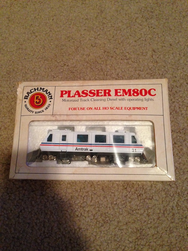

I actually have one of those Bachmann track cleaner engines. Here's mine.
It's actually not a very bad runner to be honest. As a track cleaner it kinda sucks but as a locomotive in general, it's not bad. Plus, these things actually exist.
