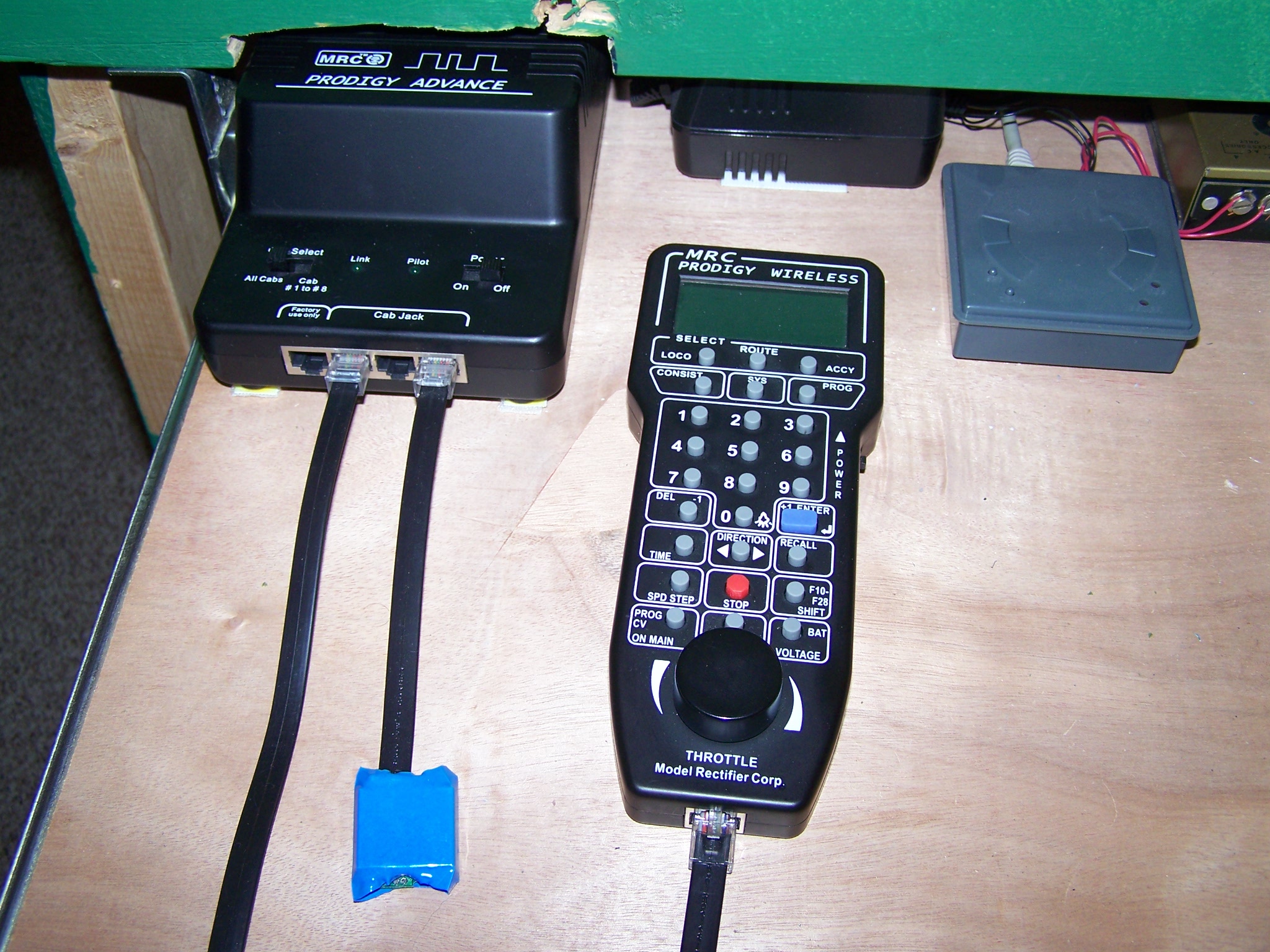

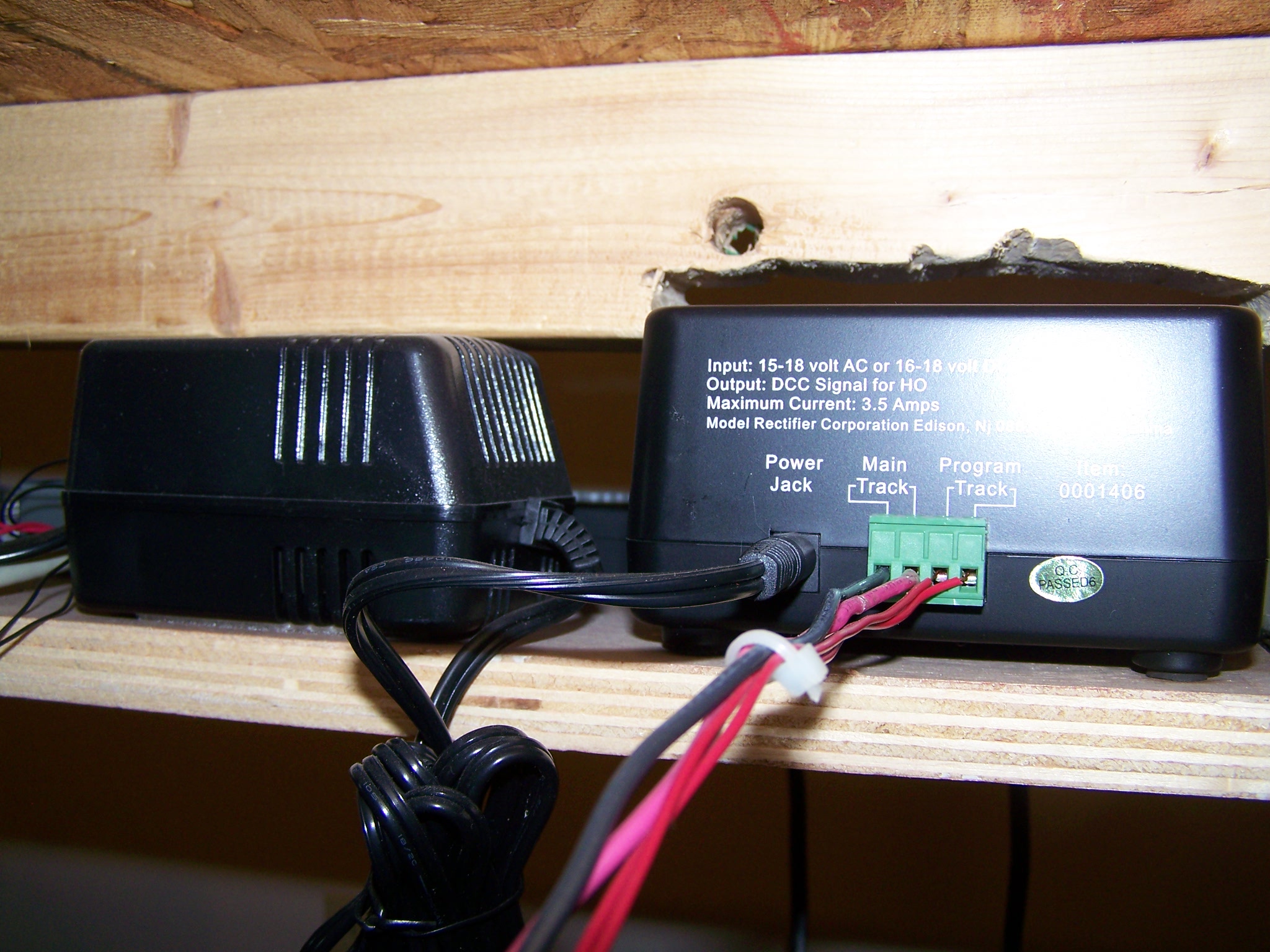

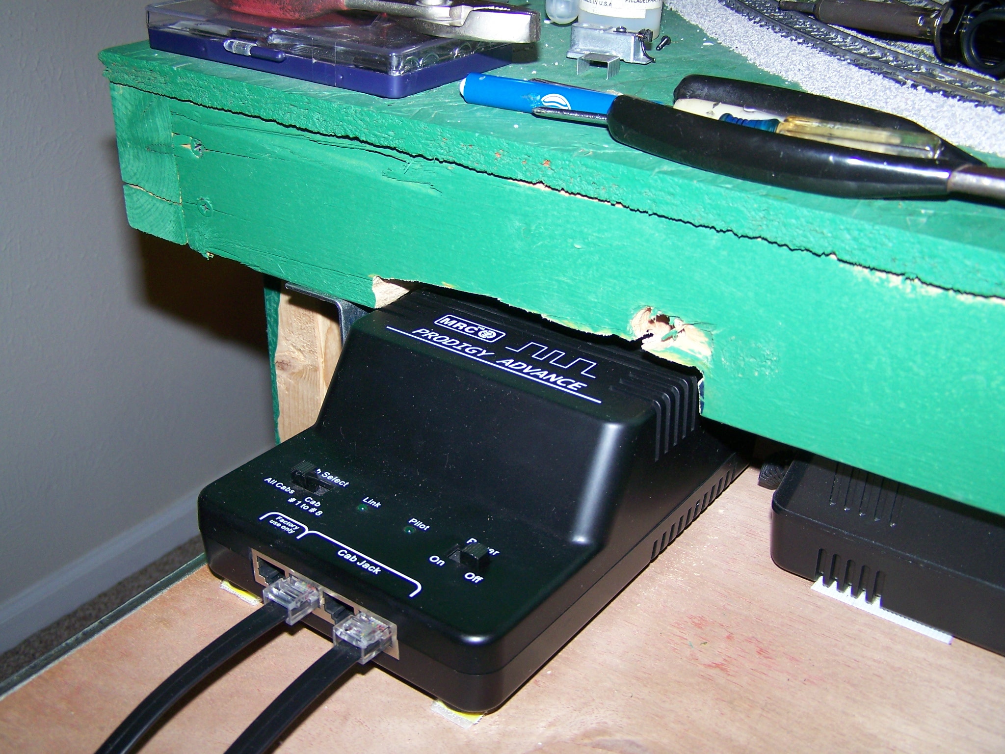

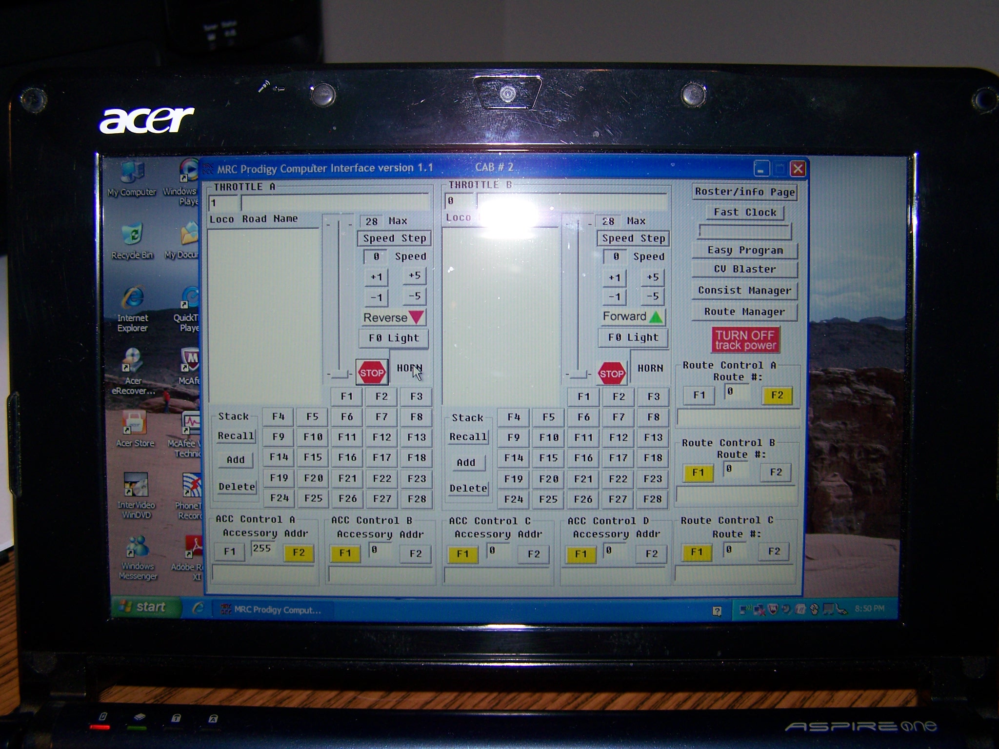

I'm using an MRC Prodigy Advanced with the wireless conversion. I also bought the USB control they sell. It makes a computer the throttle. I like the MRC system, it's easy to use, I have all of my track switches controlled by stationary decoders too. That saved a lot of wiring. I have tried the USB and my laptop and like the operation but have only used it once or twice, to much traveling for work to give it a full workout.
Just my two cents on the subject, hope it helped.

I don't know if this is the same system you are buying. This is my MRC prodigy Advanced. I added the wireless conversion. The first pic is the base unit, next to it on the right is a power transformer, plugs into 110 outlet then to base.
This is the rear of the unit. Power in, track and programming track out.
This picture shows all 3 items, the wireless is plugged into the base for charging the battery and used as a wired controller.
This is a screen shot of my laptop with the MRC software open. This acts as a throttle / walk around. It works with the wireless conversion. I had to buy the USB adapter from MRC to be able to run the system. The USB was around 60 bucks. The software is a free download from MRC. My base is over 10 years old so to use the USB I had to send the base to MRC for an upgrade, added another 60 bucks but it included shipping.

Hank,

Hi Hank, the PC software is a free download from MRC's web site, there are 2 conditions for it's use, first you have to have the wireless set up and the MRC USB wireless transmitter / receiver. Second is the Prodigy base needs to have a certain version of the MRC software on it, I think it is version 3.0. This can be checked using the handheld controller. I forget the key sequence but there are instructions on MRC's web site.
I've been partial to MRC due to the fact that the Command Control 2000 was my first DCC system.
Check the MRC site, there are a few downloads for programming CV's etc............Tom
Oh, you can run multiples with the laptop, same as the hand held controller, also features a nice roster list on a second page. The roster makes calling up loco's a snap.
