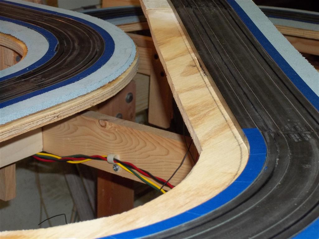

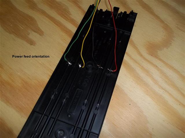

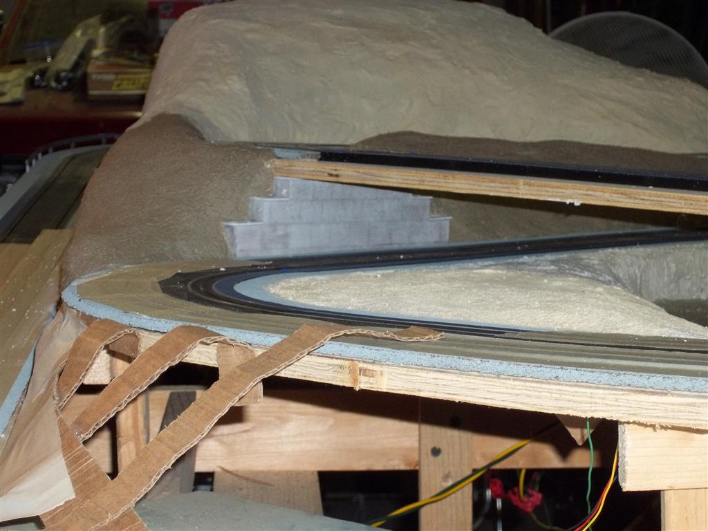

I have them all color coded and use them as taps or drops on the sections that they are soldered to. They are then connected to a main buss line that connects to the transformer. Each lane has it's own transformer, just to make sure it gets all the power it wants. The taps or drop wires are a 24 gauge solid telephone wire, and the main buss wires are a stranded 16 gauge automotive type wire. The drops or taps are soldered to the track, and I used suitcase connectors to attach them to the main buss wire. Here's a couple of pictures that might help.

The solid wire helped quite a bit. I was able to tin the ends of the wire, and then bend and tape the wire so that it would hold itself against the rail on the underside. That left both hands free to work. Then I would quickly touch the iron (with just a bit of solder on the tip) to the wire and rail. I only messed up two track sections, I had extra sections planned in advance. I had figured I would mess up a lot more sections that. Oh, I also used a wet, cloth hand towel to lay the track upside down on, and act as a heat sink. It really did a great job, I could feel quite a bit of heat in the towel even after soldering one drop. Oh, another thing, I only added one wire drop per section at a time. Then I would let the section completely cool before soldering the second , third and fourth drop. With the amount of drops needed you can get a little assembly line going, and it will go quicker then you think. Just keep a bucket of cool water nearby and keep that towel refreshed between each soldering. It will build up heat quickly, and then loose it's effectiveness.
