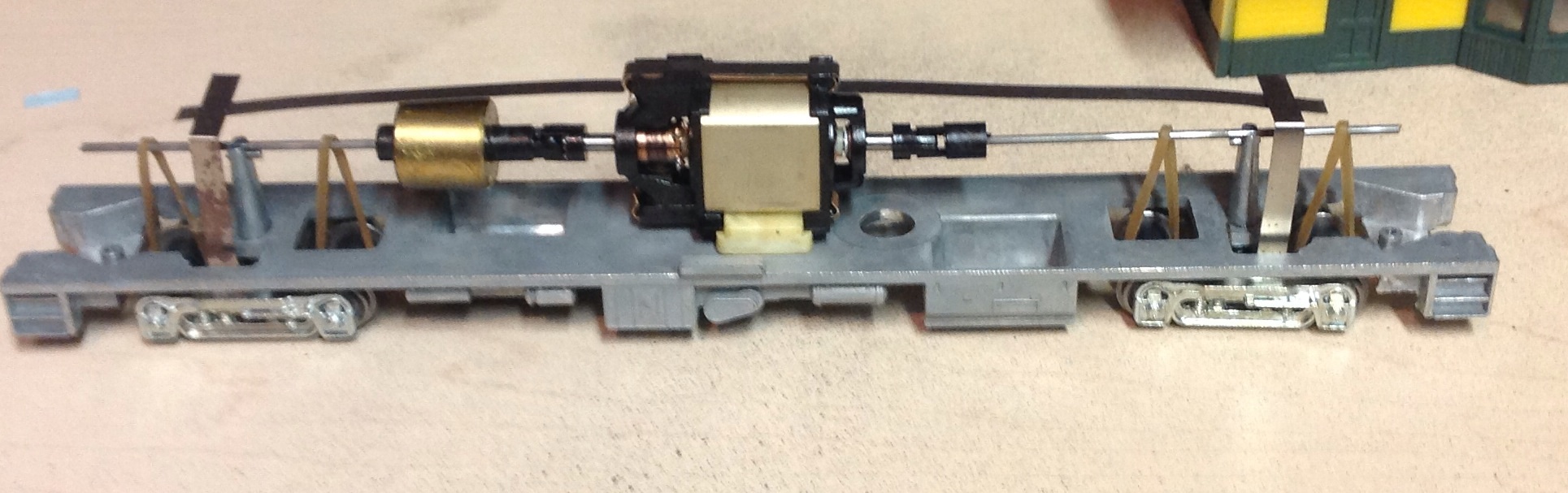

For the hundredth time, use these.
http://www.walmart.com/ip/Goody-Hair-Rubber-Bands-Clear-3-Different-Sizes/12018417
Are youse guys really that afraid of going into the hair care aisle? If you use rubber bands, you'll waste a lot of time scraping rubber goo off the shafts & axles when they melt.
These last forever. I've had these installed for about 5 years with no signs of deterioration. (It also helps to install a massive 24v low RPM motor. )
/tyco/forum/uploaded/NickelPlate759/20140320050149_DSCF1688-1024x625.JPG
They also make wicked traction tires.

Nelson, can you elaborate on that motor? More info please!
 Posted - March 21 2014 :  12:03:24 AM Link directly to this reply  Show Profile  Add NickelPlate759 to Buddylist
Jerry, they were sold by All Electronics 4 or 5 years ago, so I bought a few. Haven't seen anything like it since. I've seen some with the shaft on only one end, but never dual ended like this.
It's a Mabuchi RS-365SH. It makes it run at scale speeds, and amazingly the shaft sits at the same height as the rubber band shafting (the couplings are lengths of small silicone RC fuel line tubing). The motor's just mounted on a piece of servo tape. I wish I could point you towards an equivalent, but I haven't found one on the surplus sites.
EDIT: Just found some, but you have to take the worm and encoder wheel off. These came from large scanners, probably in copying machines. They move the scanning arm back and forth.
http://cgi.ebay.com/ws/eBayISAPI.dll?ViewItem&item=271222941311

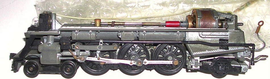

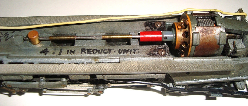

The story I've heard is that the rubber-band drive didn't exactly come from Athearn itself. It was one of their customers - a high school student, I think the story went. He'd brought a 4-unit diesel to their offices. At first Athearn was inclined to dismiss the crazy idea of a rubber-band drive...but brought it in and put it on a test track anyway. They were amazed to find out that it ran more smoothly and pulled better than their geared units. That's how the story went, and the rest is history...
I admit it's kind of hard to believe the parts about smoothness and pulling power relative to geared units...but I've also heard that Hi-F units run in multiple tended to run a lot more steadily than single units. I've never had multiple units to verify this statement with, though.
The Pacific, I'm told, didn't work very well at all. :P

One of these days I'm going to try that setup of Nelson's with an RDC.
Adams
 Posted - June 03 2014 :  6:44:31 PM Link directly to this reply  Show Profile  Add Adams to Buddylist
Relating to the RDC mechanism above, I took an old Athearn flywheel, and affixed it to the shaft. It's still a rubber band drive, but much smoother and better slow speed.

I've heard that about the Pacific too. Every time I've seen one of them they have broken pistons.
Originally posted by Adams - June 03 2014 :  6:44:31 PM
I like that setup - I think I even have all the parts for it....except the RDC
