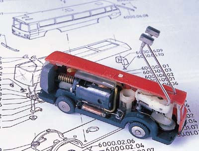

I found a picture of an Eheim trolleybus with half the shell cut off so you could see inside. I couldn't tell how the steering worked, but on some of the old model trolley buses I've seen, the poles that connect to the overhead are mounted on a piece of plastic that swivels, and it is connected to the steering shaft. So when the overhead wires curve around a corner so does the trolley. I also found a site that was supposed to show how to convert a Faller bus to a trolley bus, but the site was down.
Here's the cutaway of the Eheim trolley bus.

That's how his worked. The poles helped steer the car. His car was a different color and the motor didn't take up as much space as the picture you show. It was an "old" set and he had it repainted to the local transportation co.'s colors. I can see the magnetic pick up on the bottom of the cut out in your pic that must be how it swerves around the parked vehicles in the movie clip.
