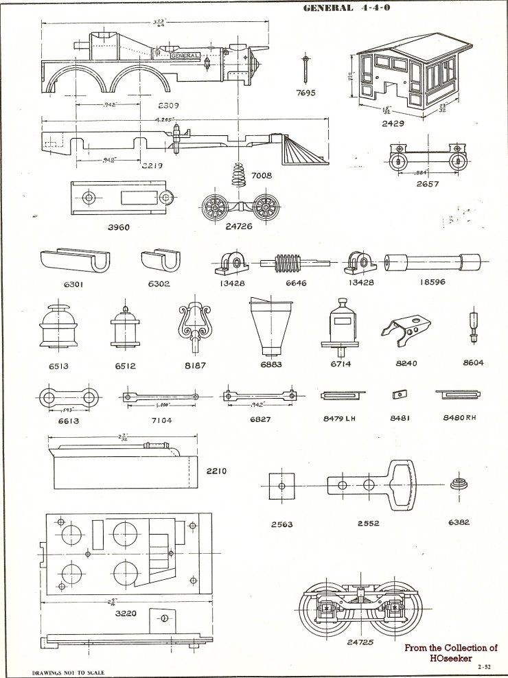

I have a Mantua replacement part list for the General dated 9/52. It has an illustration of the General with a 2 point whistle. The part number is 8604. I also have a New Mantua replacement parts list dated 11/78. It has an illustration of the General with a 2 point whistle. The part number is 8604.

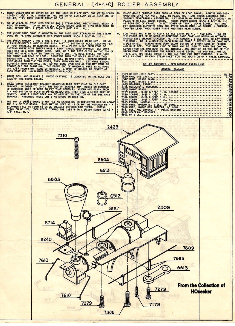

Ken, the answer to both parts of the question is no.
The early Generals had one point whistles. The molder could used wire to make the whistles two or three points. Sometime around 1958 Mantua/Tyco started using the 2 point whistles.

Instruction #9 will shed light on why there are 2 holes on the cab roof.
http://hoseeker.net/assemblyexplosionMantua/mantua440generalpg2.jpg
http://hoseeker.net/assemblyexplosionMantua/mantua440generalinstr1951pg2.jpg
