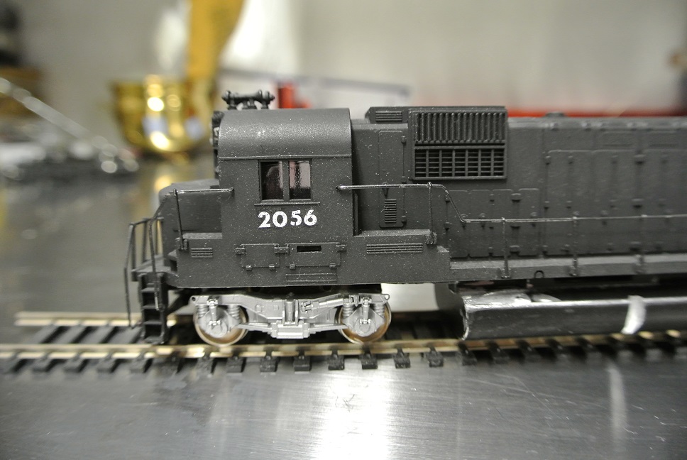

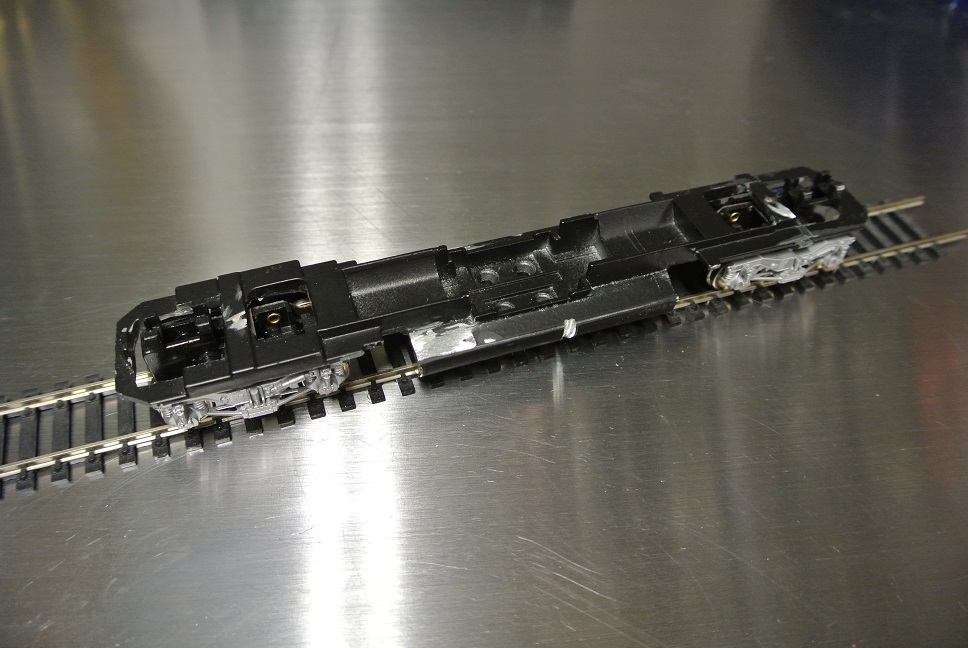

I posted a forum on using an Athearn SD-40 chassis in the C-430 but it does involve some work. A Geep-38 is an easy fit. Take a look at the Walthers low nose GP-9 as an option for the Tyco GP-20.

 Posted - February 04 2014 :  11:50:56 PM Link directly to this reply  Show Profile  Add metalsmith1 to Buddylist
C-430 with Athearn SD-40 chassis converted for type B trucks

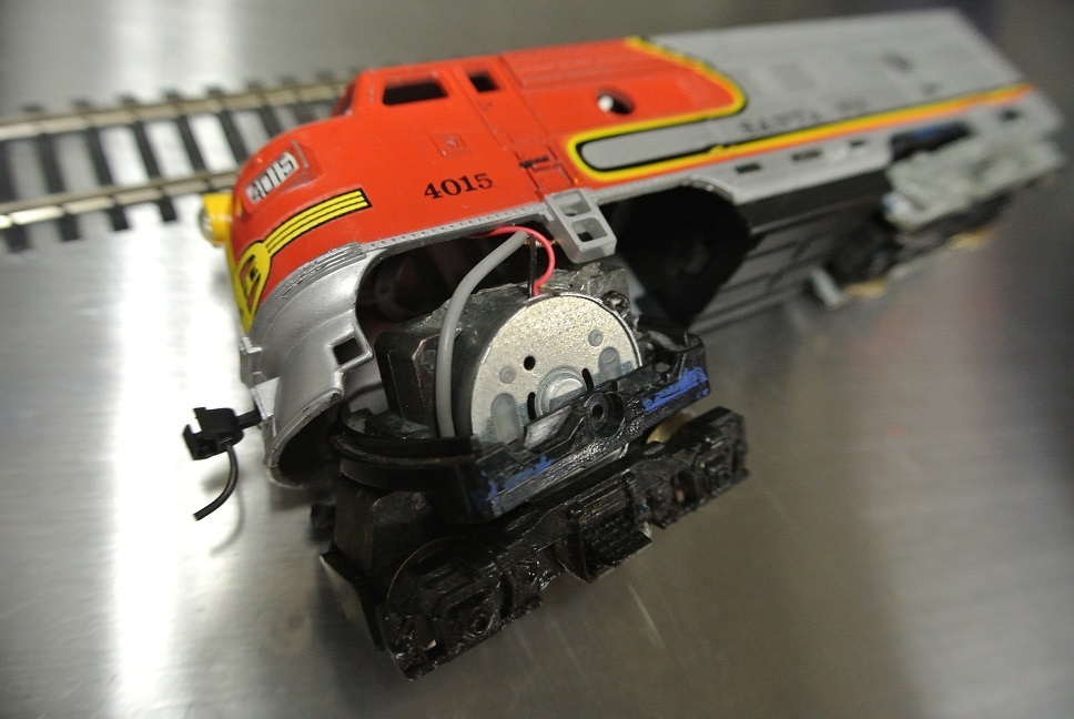

metalsmith1
REAAvatar
 Posted - February 04 2014 :  11:53:51 PM Link directly to this reply  Show Profile  Add metalsmith1 to Buddylist
Here is an example of an electronics surplus motor installed in a powertorgue drive.
