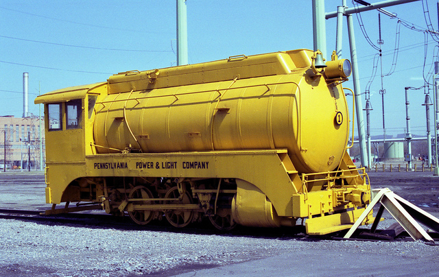

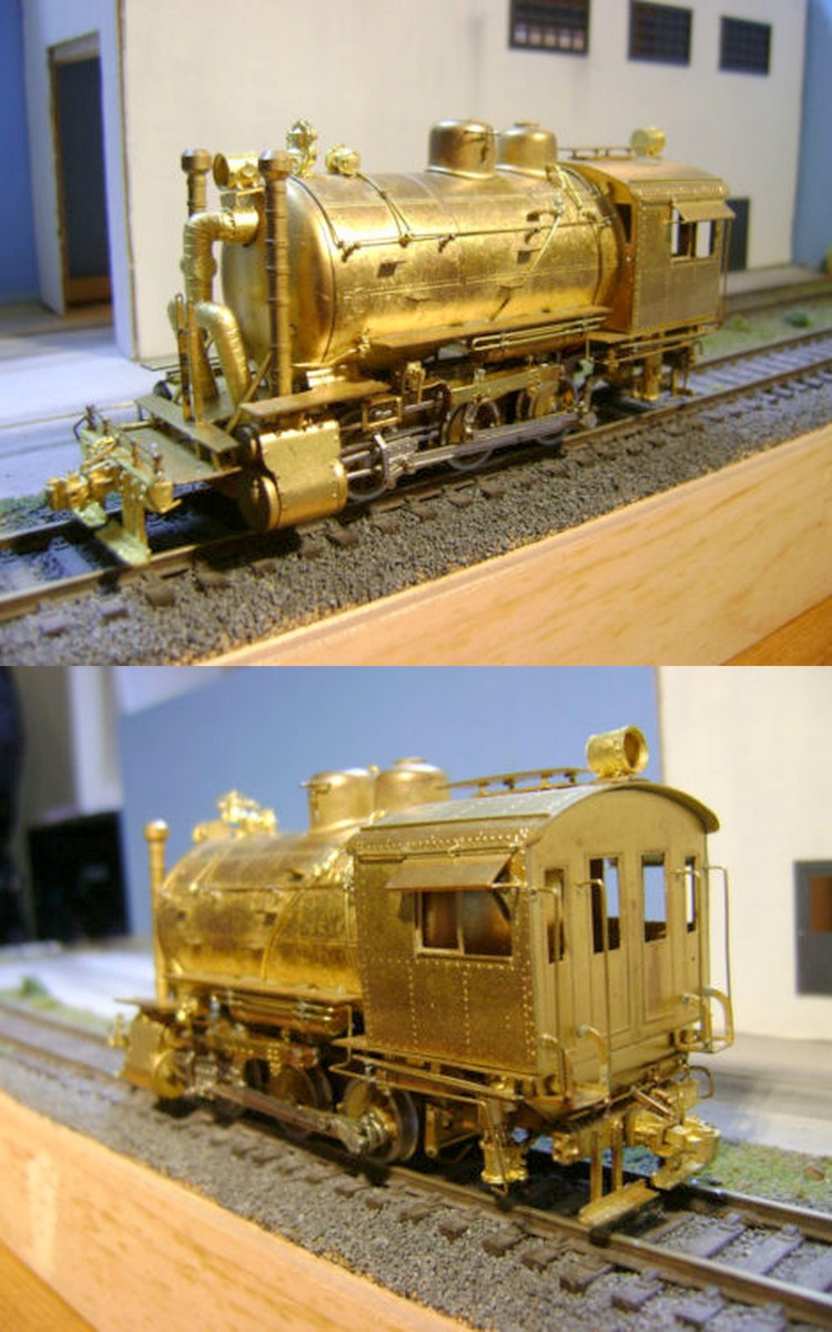

its not one for me but i love the detail,fireless 0-6-0 ken
Edited by - catfordken on November 01 2013 2:02:21 PM
 Posted - November 01 2013 :  3:05:27 PM Link directly to this reply  Show Profile  Click to see EM-1's MSN Messenger address  Send EM-1 a Yahoo! Message  Add EM-1 to Buddylist
I like the Fireless cookers too, but this one Ken, takes the cake. LOVE all the external piping and such....
Crazy part? One of those would be really EASY to build!
 Posted - November 01 2013 :  4:36:07 PM Link directly to this reply  Show Profile  Add NickelPlate759 to Buddylist
That is a really cool model. I've never seen a prototype like that. Interesting that they didn't bother with a smokebox or stack, just vertical exhaust pipes. I wonder if that made the exhaust louder.

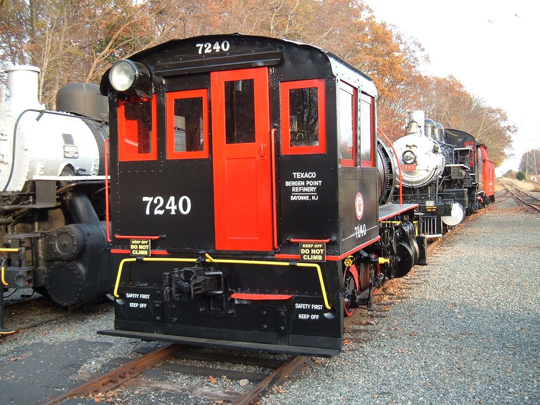

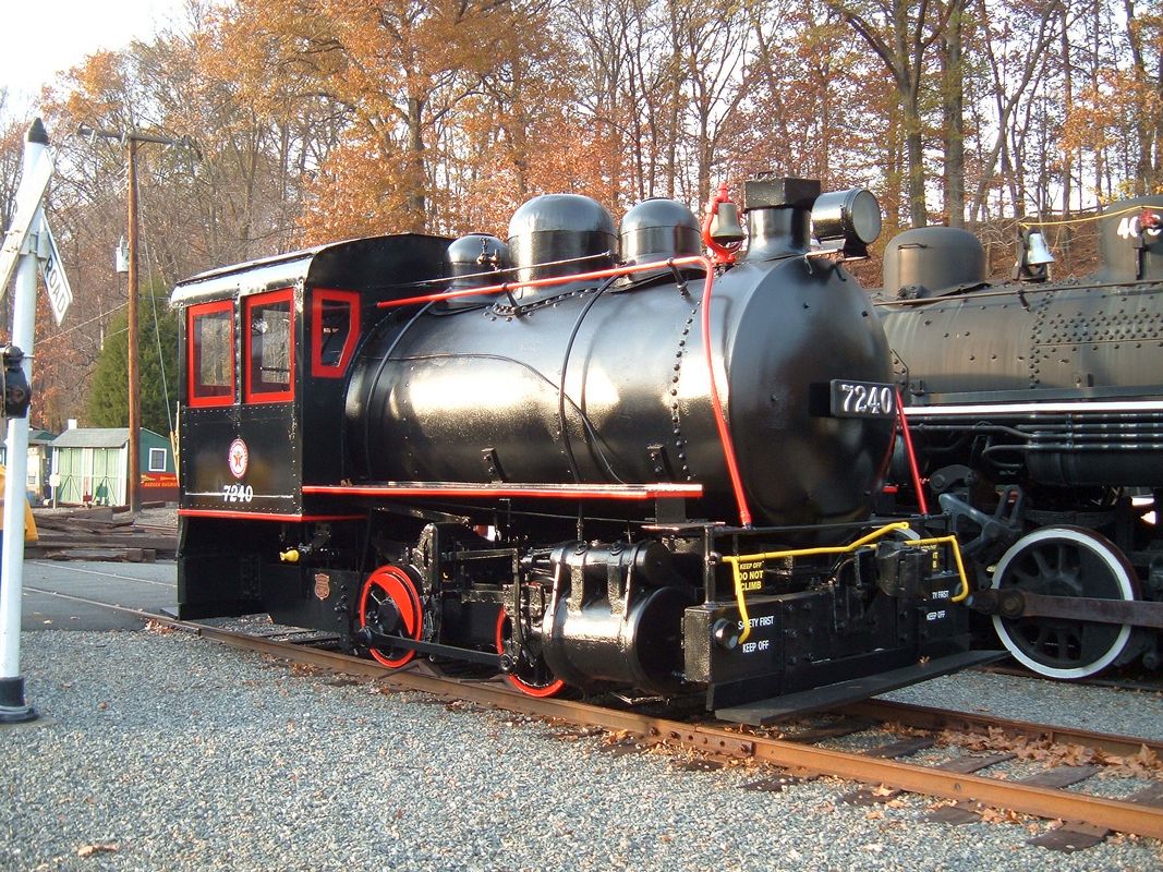

Here's a more typical fireless 0-4-0 that was used at the Texaco Refinery in Bayonne, NJ. It was donated to the Whippany RR Museum 5 years ago.
SCVR66
SCVR #2

LOVE IT!! I seriously want a fireless cooker in HO bit it's so hard to find one and they certainly aren't cheap......

looks like something that the Steam Punk enthusists would make
 Posted - November 02 2013 :  01:04:34 AM Link directly to this reply  Show Profile  Add gmoney to Buddylist
I don't understand why ANYONE ever bothered with a smokebox (what smoke?) and stack on one of these. The reason for expelling the spent steam through the smokebox is to burn the fuel more efficiently by increasing the draft in the firebox, which these locos don't have.
 Posted - November 02 2013 :  02:41:21 AM Link directly to this reply  Show Profile  Click to see EM-1's MSN Messenger address  Send EM-1 a Yahoo! Message  Add EM-1 to Buddylist
Hmmmm.
Glenn your right tho! It was a matter of using what was known to make them work....But the smokebox theory isn't needed in one of these puppies BUT...........they look to be easily made......From existing parts....of course!

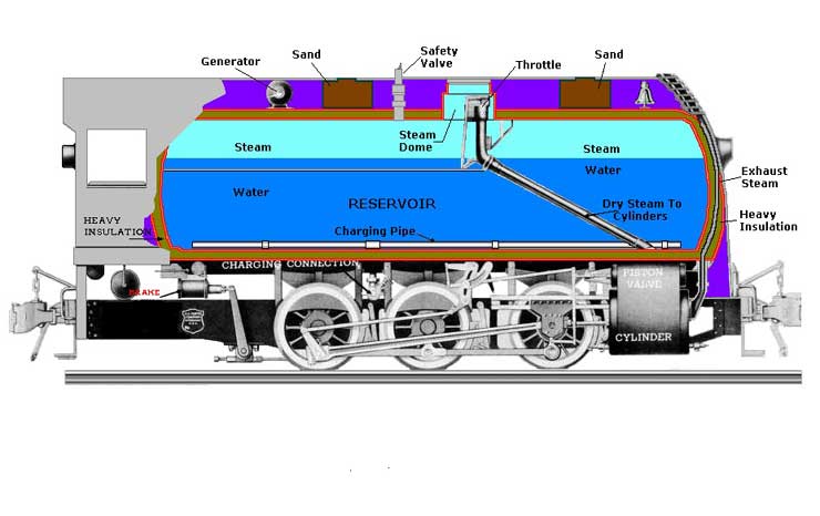

I'll have to see what all goodies I have for such....Question is, was the "boiler" used to hold just hot air (steam) OR hot water, to collect "steam" off of it? I ask as I'm not sure how well these little guys would work with just hot air in them but full of water like a tank would have the main use off the top of the water creating steam in the highest area of the "boiler" or tank as seen.....
Interesting little critter of the steam sort, to say the least! (AND C&O had a couple of them too!)
 Posted - November 02 2013 :  08:47:50 AM Link directly to this reply  Show Profile  Add scsshaggy to Buddylist
Hmmmm.
Originally posted by EM-1 - November 02 2013 :  02:41:21 AM
Fireless cookers were filled with superheated water from a stationary boiler. As steam was used, the boiler pressure would drop causing more of the water to flash into steam.

Why fire less locomotive? It usually has an insulated pressure storage tank where the hot water is stored. As the steam is used off of the top, the hot water has room to make more steam. The water is loaded from a stationary boiler. Sometime these industrial switchers were used because local boilers were already there. Sometime for safety reason such as use in an oil refinery.
It seems to me that combining a modified tank car tank with a standard 0-4-0 or 0-6-0 chassis would be a good way to start a custom project. A welded tank could simulate an insulated tank for the engine.

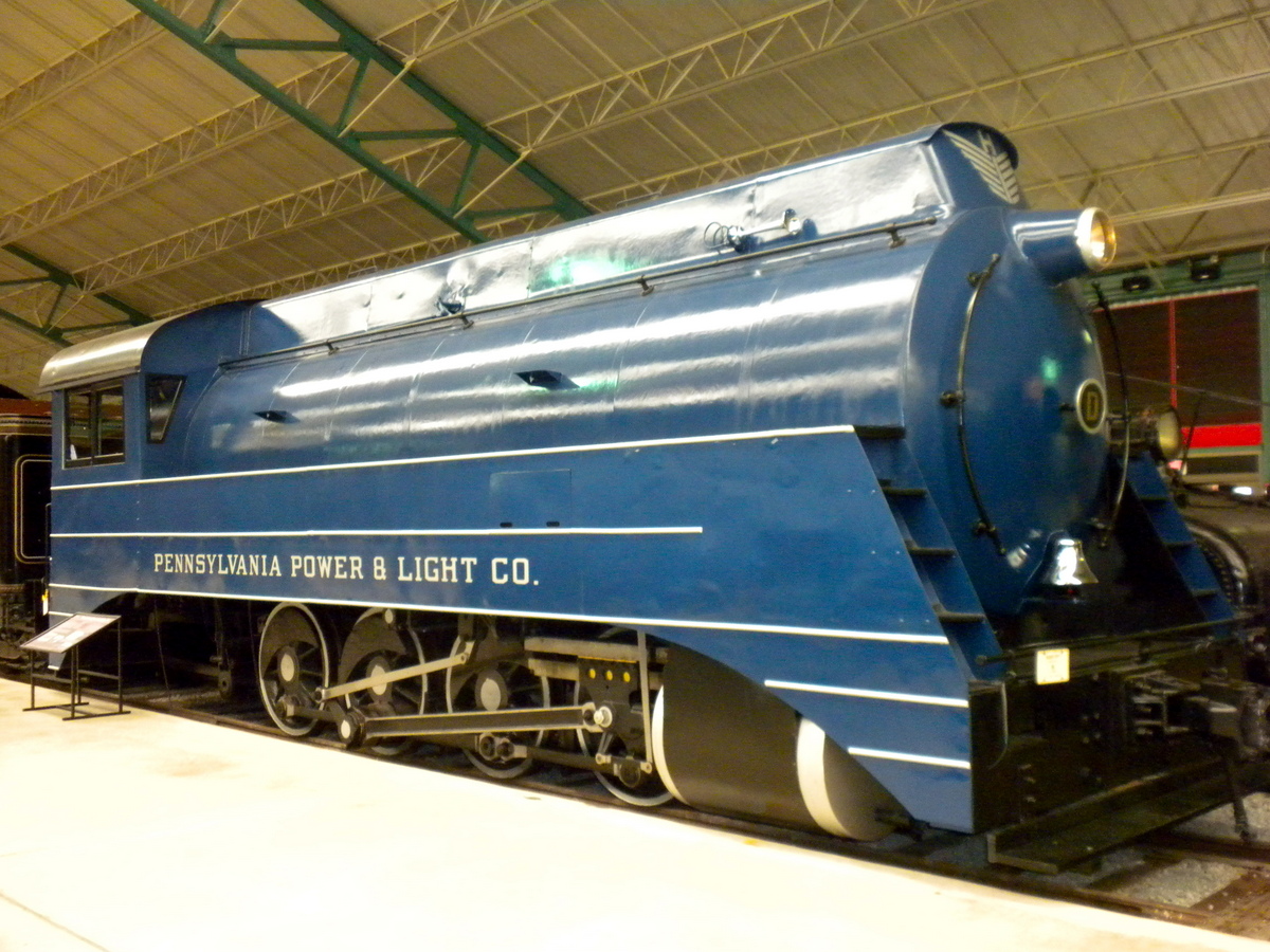

my favourite cooker is this one ken
pennsy power and light at the RR Museum of PA
her little sister

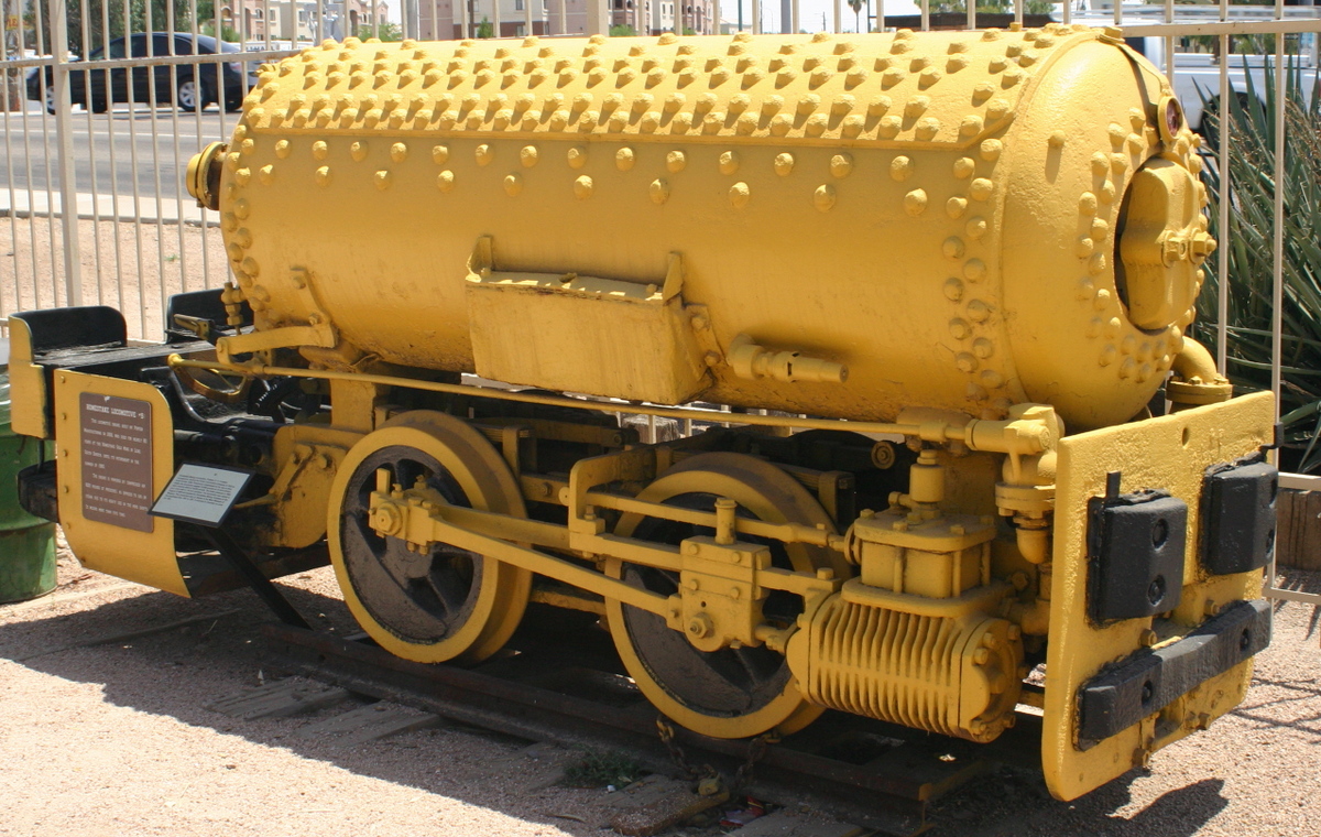

interior of a cooker

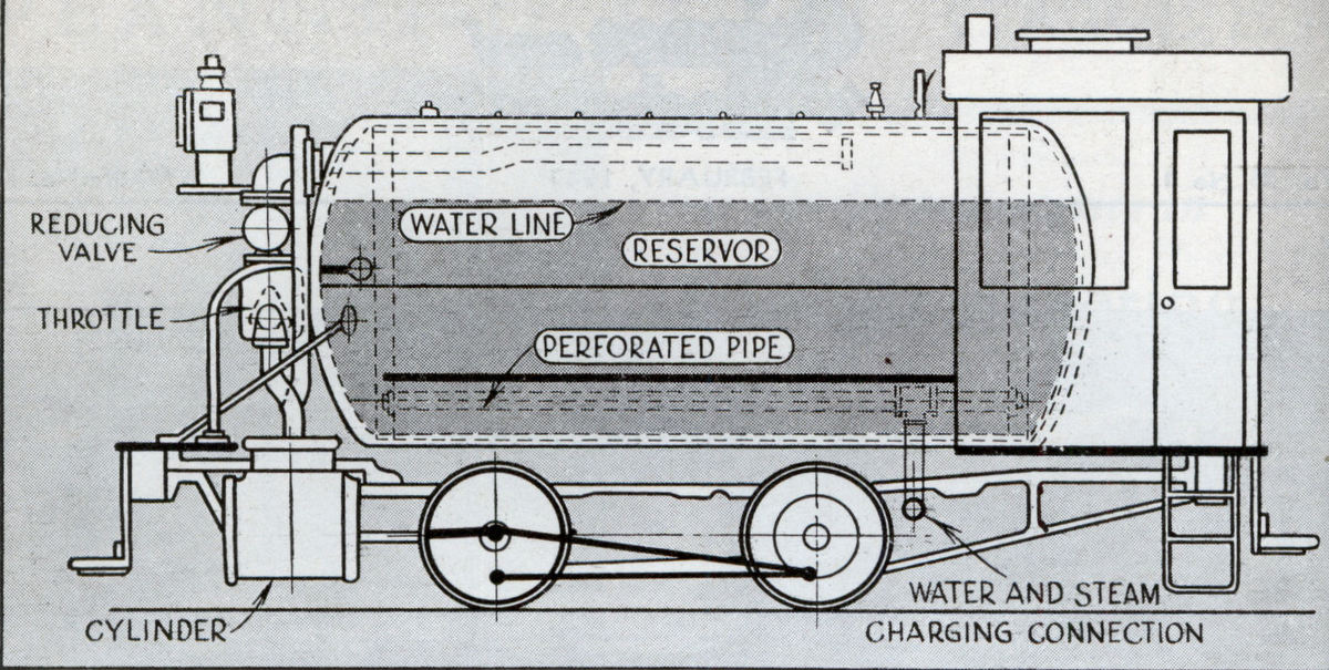

 Posted - November 13 2013 :  12:50:05 PM Link directly to this reply  Show Profile  Send catfordken a Yahoo! Message  Add catfordken to Buddylist
for the technically minded people,ken

 Posted - November 13 2013 :  12:59:03 PM Link directly to this reply  Show Profile  Add scsshaggy to Buddylist
Originally posted by catfordken - November 13 2013 :  12:29:09 PM
This is kind of odd. The cylinders appear to have cooling fins on them. A cylinder should be insulated, not cooled. The steam coming into the cylinder would want to condense into water, which does not compress, and endanger the cylinder heads if it has no good way to drain off. I wonder why they did that.

 Posted - July 24 2021 :  02:11:58 AM Link directly to this reply  Show Profile  Add BEAUSABRE23 to Buddylist
The yellow 0-4-0T is a compressed air locomotive as used in mines, not steam powered
http://www.douglas-self.com/MUSEUM/LOCOLOCO/airloco/airloco.htm

BEAUSABRE23
 Posted - July 24 2021 :  02:33:07 AM Link directly to this reply  Show Profile  Add BEAUSABRE23 to Buddylist
BINGO !
"Note the fins on the cylinder assembly, intended to absorb heat from the environment and reduce the cooling of the air when it expanded"
Of course!
Although Porter dominated this market, the fins may mean this is a Baldwin
