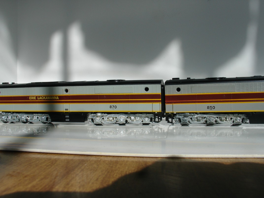

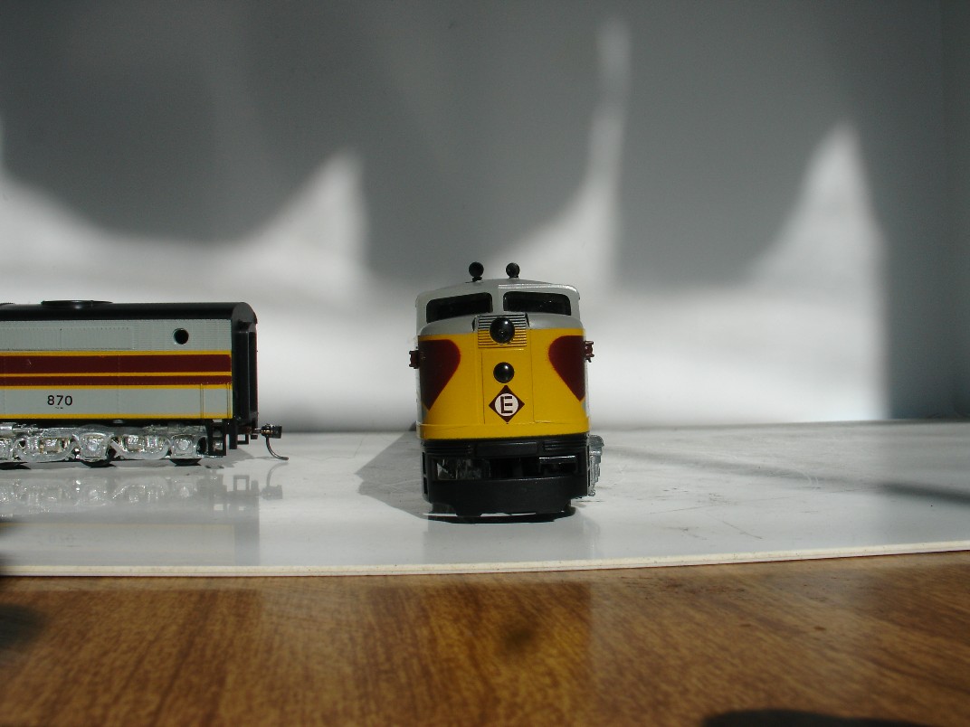

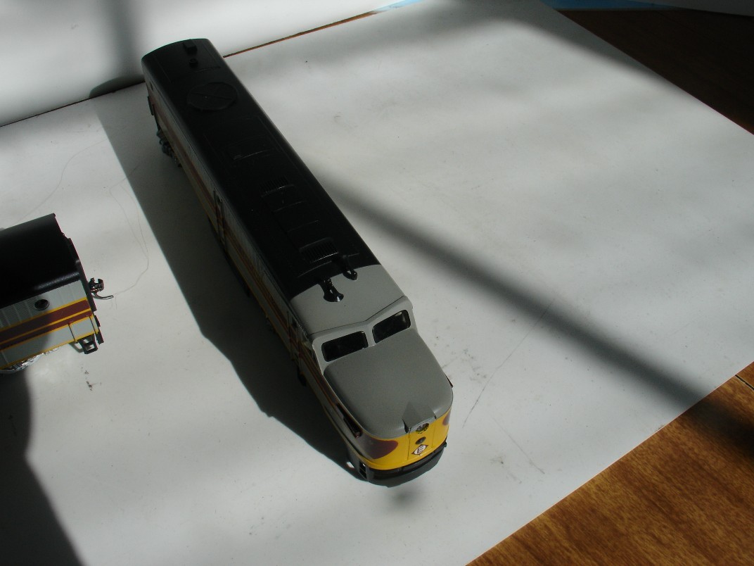

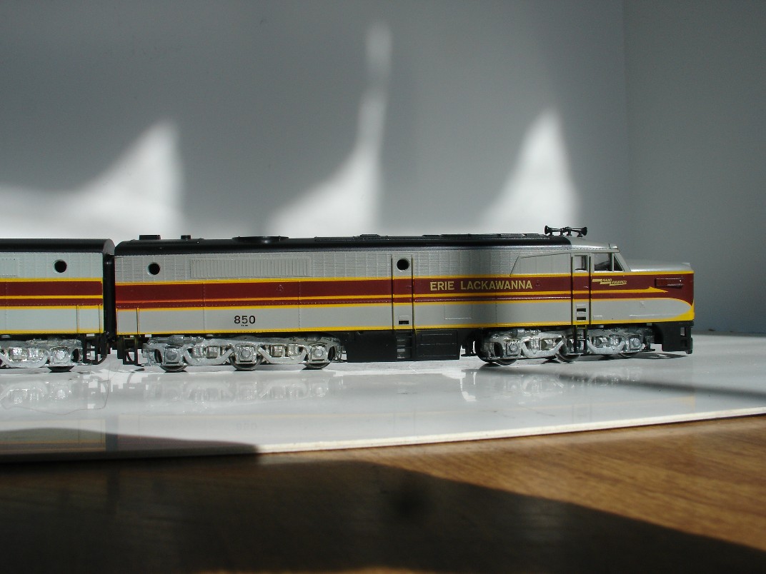

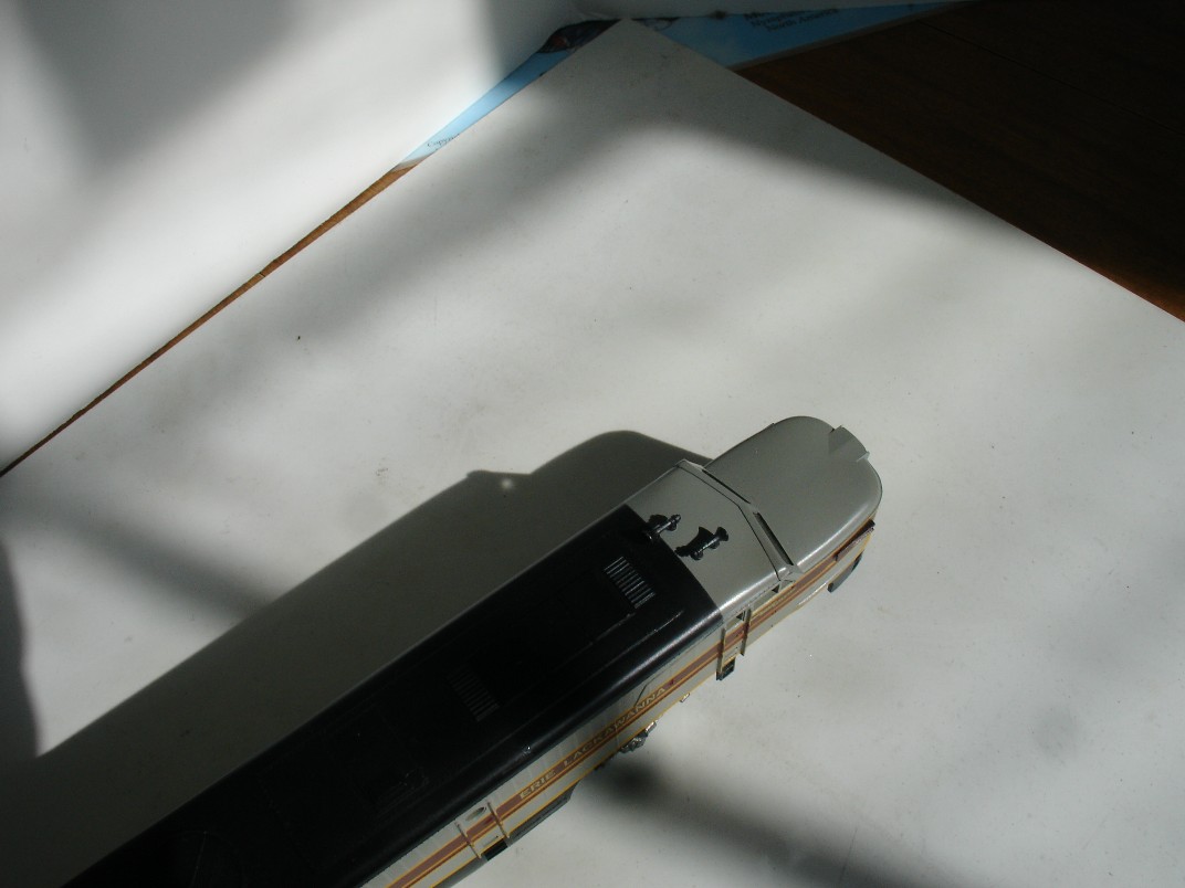

I took your advise and eperimented with color matching (actualy my lady did as she has a better eye for color shades than me) and I was able to redo the nose on th a-unit and touch up on the b-unit side. the pics are the finished results.

Nice touch-up work. I can't even tell there were any scratches. I've always liked the EL scheme, partly because I grew up with it. Interesting to see that the A and B units are slightly different shades of gray.

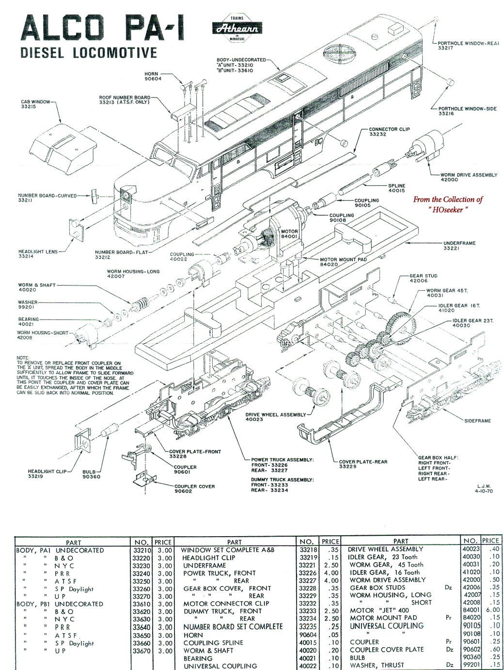

I have checked the contacts and there is no obvious shorts. the unit still runs smooth and quiet and has plenty of pulling power. It is the original motor and I am wondering if the brushes may need to be replaced? I was thinking of putting a constant lighting kit from UTAH PACIFIC that I have on the shelf. I thas a capacitor in it and I wanted to add in a light for the cab and body instead of just the headlight. the problem is what kind of effect this setup would have on the motor if it is drawing so much now. I have added the diagram so you can see which model I am working with(1970)

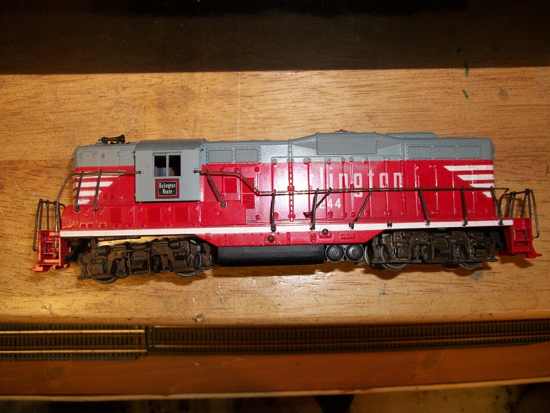

WELL, it still runs? and all? No "running" issues? I would NOT fix, whats not broken, allow it to fail as Athearn locos are known to run a LONG time with nothing more then a shot of oil every now and again, specially from back in the day, as your PA unit is......I've got a GP-7/9 that's from the days of NO flywheels, AND a metal clip that holds the truck together inside the shell, and it runs as tho it was brand new. WELL this isn't a surprise, BUT what it is, the place the brushes wipe across on the motor, that little tubular copper section of the motor, has GROVES worn into it!!!! AND it STILL runs!!!! This one:
