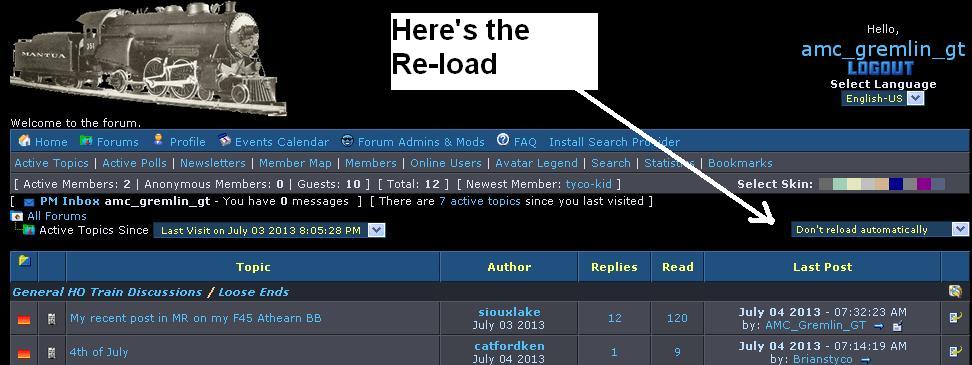

Once you have the Active Topics page on your screen, open any thread you want to read in a new tab. As long as you leave the Active Topics tab open it won't refresh.

 Posted - July 03 2013 :  6:34:11 PM Link directly to this reply  Show Profile  Send AMC_Gremlin_GT an AOL message  Send AMC_Gremlin_GT a Yahoo! Message  Add AMC_Gremlin_GT to Buddylist

If you also look to the right under the [ XX Active Topics ] line, you will see a line box, and it will say Don't reload automatically, or Refresh every XX minutes/hours. Mine is set to NOT refresh. Make sure that box to the right and under Active Topics line says that.

Cheez, this is GREAT news! I'll have to remember that! Now, I'm off to see what AMC is talking about as well! Maybe its a setting I have to re-set!
Originally posted by AMC_Gremlin_GT - July 03 2013 :  6:34:11 PM
Jerry, this must be under my "profile" account as I don't see it on the main page, BEFORE I hit reply with quote OR the "fast reply".....Would that be a correct assumption?

 Posted - July 03 2013 :  8:07:28 PM Link directly to this reply  Show Profile  Send AMC_Gremlin_GT an AOL message  Send AMC_Gremlin_GT a Yahoo! Message  Add AMC_Gremlin_GT to Buddylist
Originally posted by EM-1 - July 03 2013 :  6:50:47 PM
EM-1, it's on the Topics page. Once you log in, it says there are X active topics, when you click on THAT, it takes you to the Topics page, and that's where this box is down a line and to the right of X active topics. On the left above all the topcs it says Forum, then Active Topics then a box which indicates Since Last Visit Date, or whatever you have it set at, then over to the far right is the box where it says Don't Reload Automatically.
Originally posted by AMC_Gremlin_GT - July 03 2013 :  8:07:28 PM
I'm not sure what setting your screen is at Jerry, BUT, I don't have to log in, each visit. I'm automatically logged in!
Having said that, I don't have this little "box" to check, or un-check....However, I did find a drop down menu to adjust how long the "active topics" is, or goes back in time, I should have said.....I'll see if I change that, if things change in a more positive way!

 Posted - July 04 2013 :  07:32:23 AM Link directly to this reply  Show Profile  Send AMC_Gremlin_GT an AOL message  Send AMC_Gremlin_GT a Yahoo! Message  Add AMC_Gremlin_GT to Buddylist
Originally posted by EM-1 - July 04 2013 :  12:33:52 AM
Yes, then you're on the correct page - look to the right of that drop-down , and there's another one on the other side of the page ( on mine anyway ) that says Don't Reload Automatically, or Reload every X minutes - it's just a drop-down like the Active Topics one is, just across from it.

Funny, I've never even noticed the automatic reload drop-down menu. It wasn't enabled by default, so I never paid attention to it.

I'll have a look for that! THANKS for posting the picture that you did, as it makes it a lot more easy to follow!
