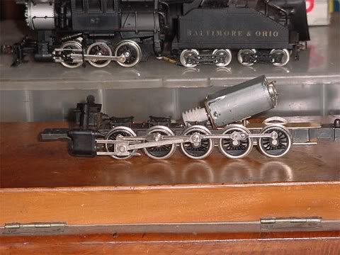

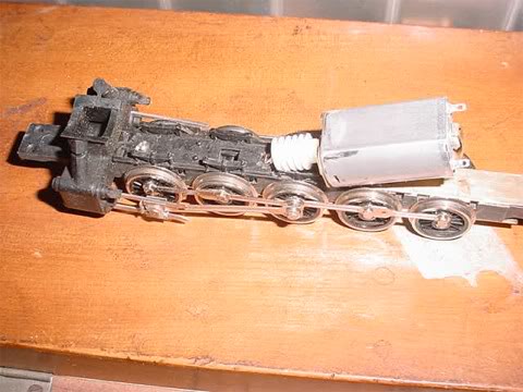

 Posted - May 18 2013 :  12:45:21 AM Link directly to this reply  Show Profile  Click to see EM-1's MSN Messenger address  Send EM-1 a Yahoo! Message  Add EM-1 to Buddylist
Here is the TYCO 0-8-0 built into a 0-10-0....
As you will see, I've done all sorts of things, machining wise to steamers.....Justin, let me know what you might be up for as the milling work you need to do is pretty simple....I'd be able to help you see that made, once I'm able to tighten things after I heal from the surgery!
