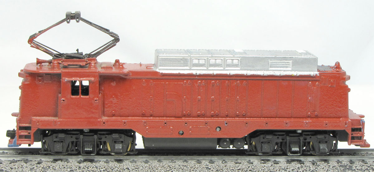

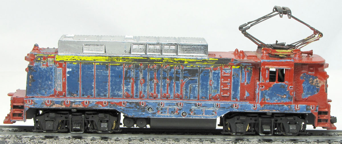

I lumped this in with a small cache of locos from my all-time favorite train show dealer, and it basically comes out to free. And maybe by some accounts it should have been:
It's clearly been dunked in paint and has seen better days, but for an HO Rectifier, the price was definitely right. But was it a Lionel or Athearn?
After soaking the right side in 90% alcohol for 20 minutes, a scrub revealed more history: it was dunked black before red. And when I peeled some of the paint off, the letters "V I R" were stuck to the black layer... sigh. Looks like I can't salvage the oringinal paint beneath, but it was worth a shot.
Both Lionel AND Athearn had the Virginian roadname, so no ID there. The frame and mechanism would hold the answer then, but wait - there's more to this puzzle!

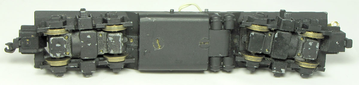

Yeah... that's not like any Athearn or Lionel mechanism I've ever seen. I know Athearn's original "gear drive" was sort of exotic, but was it quite this so? LOOK AT THAT MOTOR!
Oh... and after a bit of clean-up, it runs. Superbly.
OK... so Athearn tooled the Rectifier shell at Lionel's behest, at it was designed to ride Athearn's own GP7 shell. So maybe then, this is some sort of bonus 3rd-party vendor upgrade to a standard Athearn geep frame that found its way underneath this messed up rectifier shell...?
Not so...
Somehow it didn't photograph, but the word "JAPAN" is very faintly embossed on the bottom of the tank. And it doesn't fully match an Athearn geep frame either...
Also, back to the shell: how are the pantographs mounted? Every photo I've seen shows screws which would of course be easy to remove, but mine does not use screws. They appear to be pins. I'm afraid to mess with them for fear of breaking them... because underneath all that awful paint, the shell is perfect and unbroken.

The Virginian Rectifier was sold by Lionel in 1958 and was a rubber band drive unit. It has "Built by Lionel" stamped on the short hood. The Athearn unit is also rubber band drive and has 0590 stamped on it. It was available in 1958 & 59. Both versions used pins to attach the pantograph.
From your picture, there appears to be a trace of the "Built by Lionel" on the short hood. My guess is someone changed the frame and drive on the unit. By the way, Lionel produced the shells. Athearn painted and decorated the units and supplied the drives.

Thank you for the information and Athearn / Lionel clarifications, waw47. So given the base paint and the pins, looks like a 1958-only Lionel version shell? Pity what happened to it.
I agree the frame and motor definitely is aftermarket, but I'd love to know who made it. It's pretty robust, the trucks all fully enclosed with precision-fit brass worms axles and bearings, and the vertical gearboxes are kind of unique. Runs really nice for its era. Given the mounting lugs it seems made for Athearn geeps.
Originally posted by spiderj76 - February 18 2013 :  12:27:14 AM
Hi Tony,
The chassis might be an Olympic Express.
Frank has posted a photo of one in this thread.
http://www.tycoforums.com/tyco/forum/topic.asp?TOPIC_ID=9120
Ray

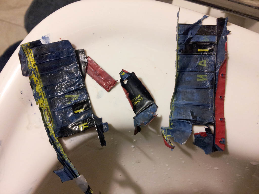

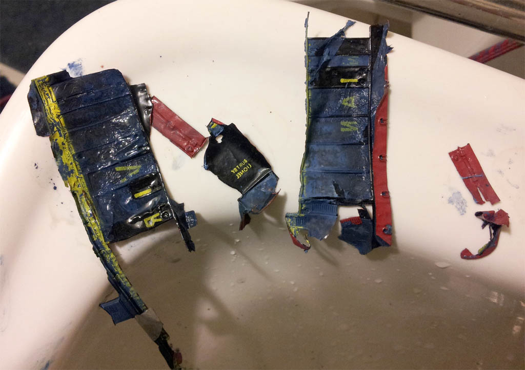

 Posted - February 20 2013 :  3:13:08 PM Link directly to this reply  Show Profile  Add spiderj76 to Buddylist
Ah, kids: the universe's favorite free radicals, randomizers, and wreckers of many a best-laid plan...
So the other day I laid the other half of the shell in the same shallow alcohol bath, fully intending to come back to it in about the same amount of time (maybe less), and remove the upper strata of paint to pursue that "faded original" look I thought would be interesting.
It was late, it was quiet, it was calm, it was close to bedtime, it was a great idea.
And then the kids were kids with the chaos and sillyness and ensuing fallout distractions...
...and around lunchtime the next day, I had one of those dreaded "oops" moments. The kind normally spelled more like "Oh $#!^"...
Well at least I now know with certainty who made it. I guess kids also make good detectives by proxy.
Still, it's pretty neat that paint can peel off that way. After 18+ hours in the bath, the underlying blue came off as well. Oops.
 Posted - February 20 2013 :  4:05:04 PM Link directly to this reply  Show Profile  Add NickelPlate759 to Buddylist
Tony, save the paint pieces. you never know... Lionel collectors might pay big bucks for them on eBay.

That chassis is originally Athearn. Originally called a "dual geared geep" for marketing. I have a complete one, and power trucks for another. VERY smooth and quiet, if you clean the hardened grease out and lube it.
They are not like the plastic, in that lack of maintenance doesn't hurt much. These have oillite bearings that need to be kept damp.
http://www.hoseeker.com/assemblyexplosionAthearn/athearngp9dualgeared1957pg1.jpg
Shell swap, probably.
I have been told they only did it for one, maybe two years, until they found they could compete with snap-together plastic gearboxes instead of cast, machined, and tapped boxes with bearings pressed in.
Olympic Express....I know Olympic Cascadian, possibly Irv sold off the line to someone else, but it sure is the same as my dual-geared unit is.
Might be interesting to have one of each and compare.
If it's Japanese, the threads will be metric. Mine are 2-56, as are the ones in the drawing linked.
Dave
Edited by - ScaleCraft on April 26 2013 10:40:44 PM
ScaleCraft
 Posted - April 26 2013 :  10:05:23 PM Link directly to this reply  Show Profile  Add ScaleCraft to Buddylist
As an addendum, the sideframes should be plastic. Mine was missing one, found one, and they are Globe (predecessor to Athearn's plastic stuff). They glue on to the metal tabs provided.
You can even see the stock Athearn Geep "air tanks" on the frame.

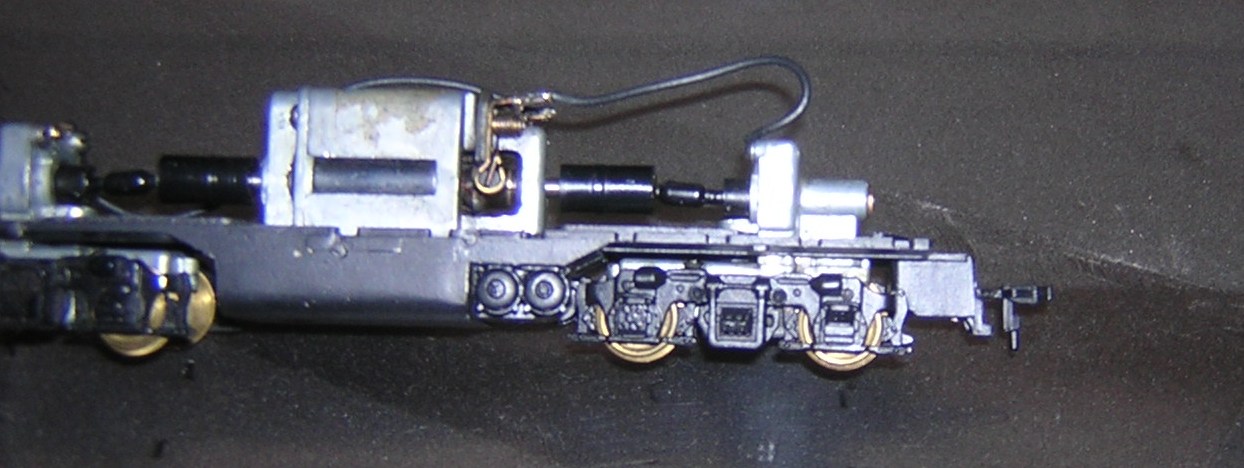

ScaleCraft
 Posted - April 27 2013 :  11:25:32 PM Link directly to this reply  Show Profile  Add ScaleCraft to Buddylist
This is my Dual Geared Geep with shell removed. Dave
