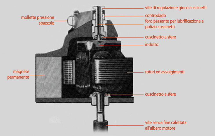

That's funny, I just now PM'ed somebody about this. I should have known one of our own would buy it. It was remotored because the Rivarossi ball bearing motors were much smoother than the vertical motors that New One Made. It probably has a good speed range with the higher reduction New One gearing.
I can give you tune up tips, or teach you haw to strip the motor all the way down for a full service, if you don't mind dealing with those tiny 1mm balls.

 Posted - January 14 2013 :  7:04:03 PM Link directly to this reply  Show Profile  Add SCVR66 to Buddylist
Oh nothing I just can't understand 90% of that diagram there

 Posted - January 14 2013 :  11:12:55 PM Link directly to this reply  Show Profile  Add NickelPlate759 to Buddylist
Justin, you definitely don't want to pull the motor apart unless you do it in a container to catch any loose balls, but you'll have to pick most off the magnets. Getting a pack of spares is essential.
Fortunately, they usually run fine with a brush & commutator cleaning (including the slots), and oil for the bearings. If they're really dirty I blast the bearings with contact cleaner and re-oil. Worst case scenario is if the bearing races are pitted from dirt, which will make the motor noisier.
I guess if you call someone a spazzole in Italy, you're really calling them a brush spring.
Edited by - NickelPlate759 on January 14 2013 11:17:20 PM
 Posted - January 15 2013 :  12:19:14 AM Link directly to this reply  Show Profile  Click to see EM-1's MSN Messenger address  Send EM-1 a Yahoo! Message  Add EM-1 to Buddylist
I was being taught Italian by my grandfather on my Moms side (Only Pap I knew), as my blood one, passed when my Mom was 3, and my gram remarried... Sadly, I lost the Pap I knew before he could finish his teachings just so I could translate those Rivarossi diagrams!
And yes, he was teaching me, for the very reason......was to be a gift! (HE got fed up reading them for me as a youngster!
