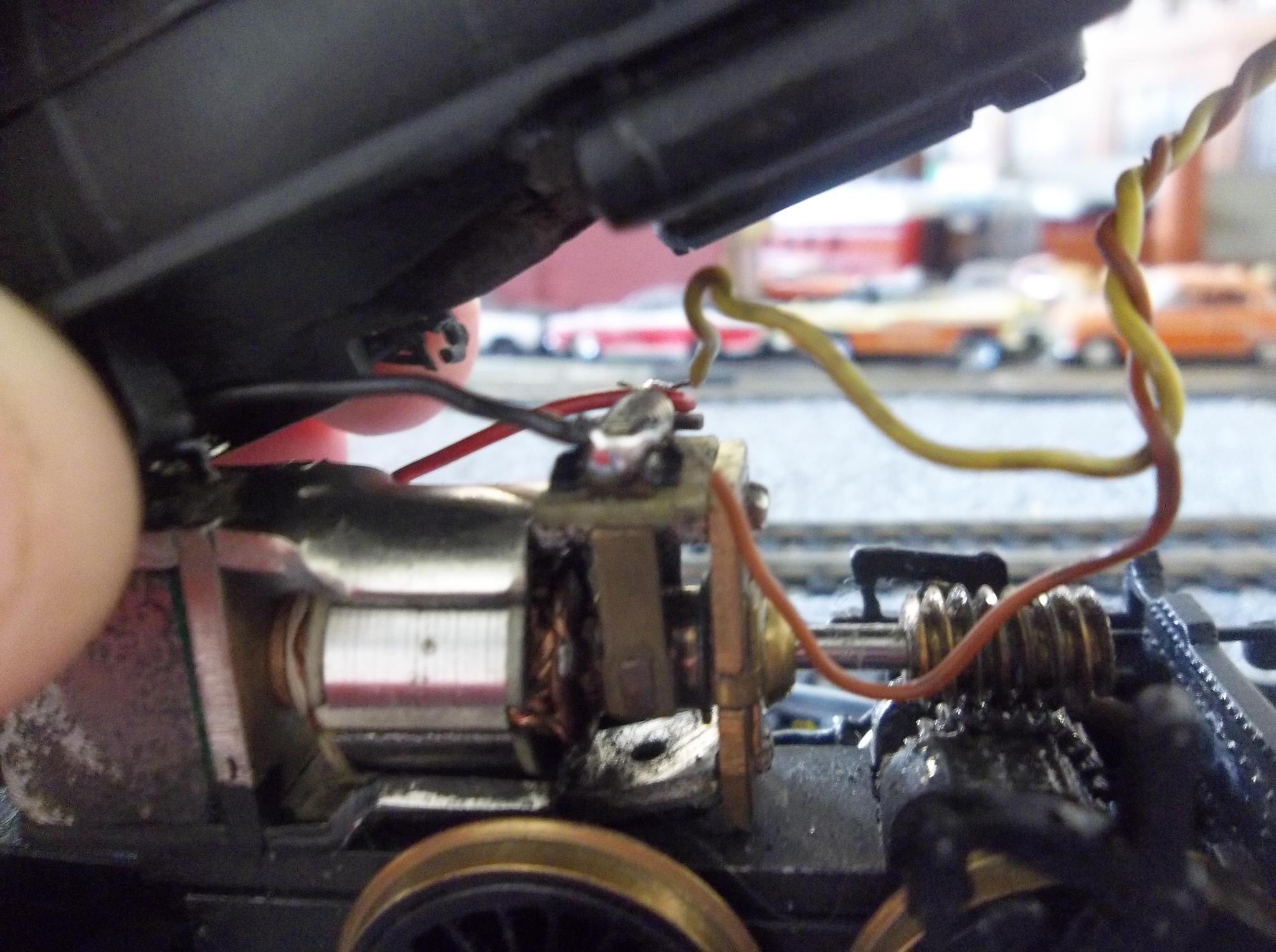

You are absolutely right Jerry! I had my dad take a look who's been electrician for 30+ years at ADT and here knows it's a short. There's an wire that broke off it's sautered position and he says it's touching the motor or boiler and causing it to short. Were gonna check everything else too. Preferably I like repairing engines and I only come to my dad when it's wiring related. Everything I've been able to handle. I love repairing engines but don't worry there's detail parts broken off due to bad packaging that I'll put on after it runs. Thanks for your help jerry! Much appreciated!

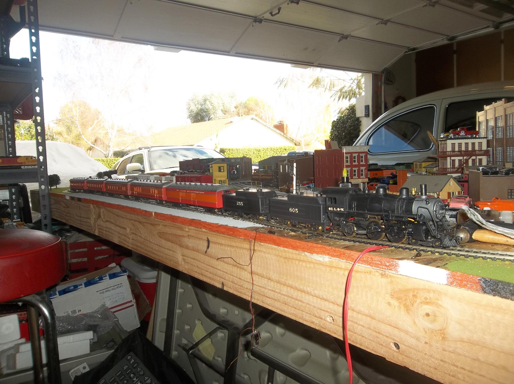

Well today I sautered the wires back onto their spot on the motor! She now works flawlessly! She ran her matching 5 coach train and ran perfect every inch of the way! Definately my 2nd favorite steamer. Loved her so much i put it into my shop with my other favorites. There;s one catch its rail on the shop floor
sautered wire in the foreground
here she is on seperate rail! My Seybold Locomotive Works

Nice Point-to-Point layout ya got there! I see a "BUG" in the design ( well, next to it, anyway ). Must be another project. Glad you found the problem and were able to re-solder the connection properly. Always good to get things properly fixed right. Wiring is not such a hard thing to do, it just takes some patience and a diagnostic thinking pattern to find out what is wrong.
