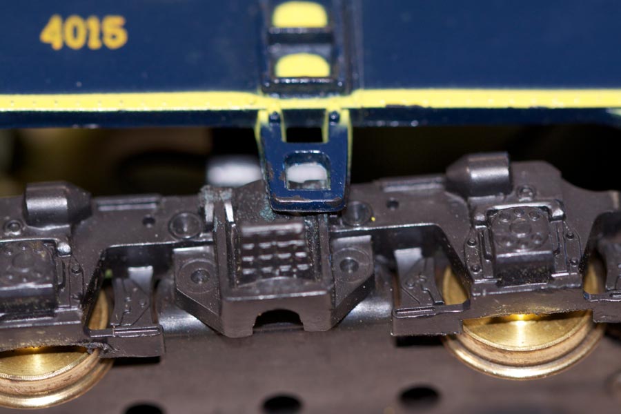

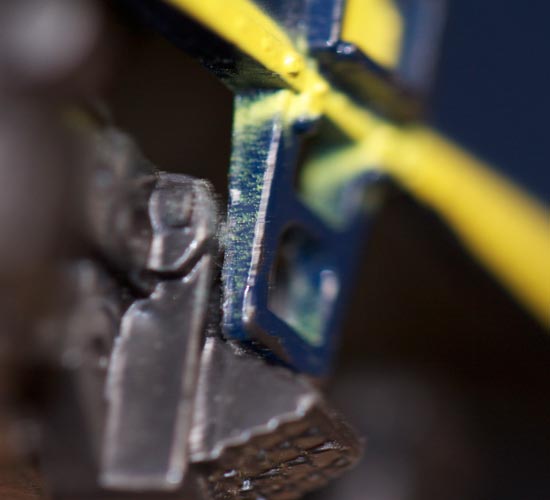

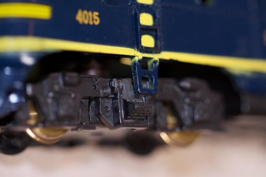

Thanks, guys. I suspect you're right about the steps bending in a bit, but as they look aligned to the frame, it might be that the frame has buckled a tiny bit causing the steps to be a little too close to the truck. Photos in case anyone is interested.

Glad you got it working. In your pics the stirrups look normal and proper to me, but I can see the rub marks, so I'm not sure what the problem is. Eric had a great suggestion which is similar to but perhaps more plausible than my second, so if it happens again I would look there.
