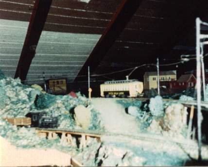

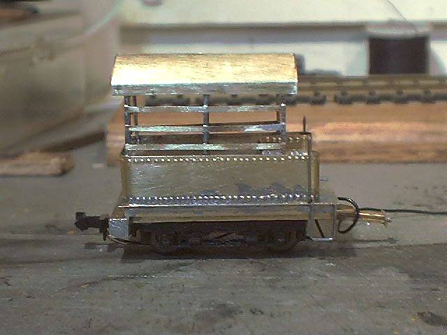

I used to have an HOn30 line on one of my earlier layouts.
The cars were all scratch built and the loco was a kitbashed Bachmann 0-4-0T

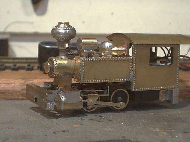

I also built another HOn30 locomotive for a friend for his sugar cane railroad.
Ray

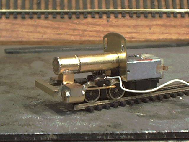

 Posted - October 29 2012 :  02:01:29 AM Link directly to this reply  Show Profile  Add NickelPlate759 to Buddylist
That is really cool, Ray. How is it powered? Other than the wires I can't see any sign of a motor or gearing.
Ray Marinaccio
RayAvatar
 Posted - October 29 2012 :  02:33:38 AM Link directly to this reply  Show Profile  Add Ray Marinaccio to Buddylist
It has a small rectangular motor in the cab. The chassis is from a Bachmann N scale Dockside. Almost everything else was made of brass.
Ray

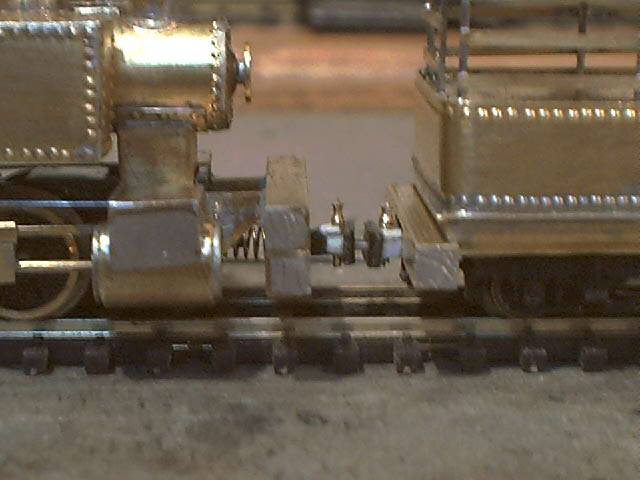

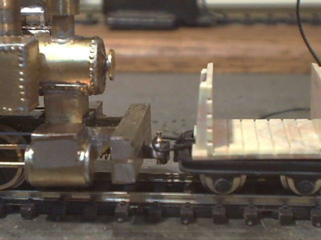

 Posted - October 29 2012 :  02:39:11 AM Link directly to this reply  Show Profile  Add Ray Marinaccio to Buddylist
It even had operating link and pin couplers.

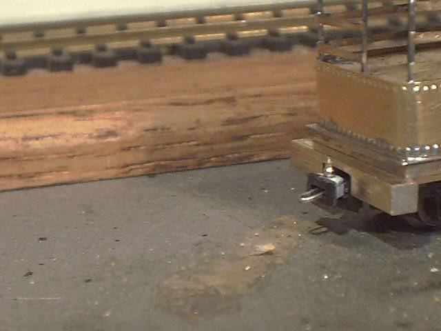

 Posted - October 29 2012 :  03:41:54 AM Link directly to this reply  Show Profile  Add gmoney to Buddylist
Are those link and pin couplers available commercially or are they scratchbuilt? Either way they're really cool!
Originally posted by gmoney - October 29 2012 :  03:41:54 AM
Those link and pin couplers were built by modifying N scale Rapido couplers.
Ray

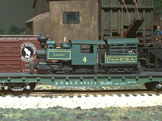

Originally posted by Ray Marinaccio - October 29 2012 :  12:32:33 AM
[/quote]
I really like this locomotive. Painted well, great color scheme, looks appropriate for the job. There's just one thing I'm not a fan of; that cab looks like it would make the rear of the locomotive rear-heavy. A lot of narrow gauge/ tank engine locomotives have that because of real-world weight distribution (cabs are light) but that just looks odd to me. As a model with the motor back there, wouldn't there be a balance problem?
Originally posted by Islanderh93 - October 29 2012 :  5:31:50 PM
There is alot of brass and solder ahead of the drive wheels and the side tanks are filled with lead. It is heavier than it looks.

 Posted - November 06 2012 :  12:30:15 AM Link directly to this reply  Show Profile  Add NickelPlate759 to Buddylist
Ray,
I remember now seeing that loco on the 2 Guys forum. That motor is perfect for the cab. Didn't recognize it painted.
Shay, awesome stuff. The 0-6-0's a hoot.

Can I ask what NAESA means?
if you remove the E its NASA!

Originally posted by microbusss - November 06 2012 :  12:33:42 AM
That is the name of his sugar cane railway.
