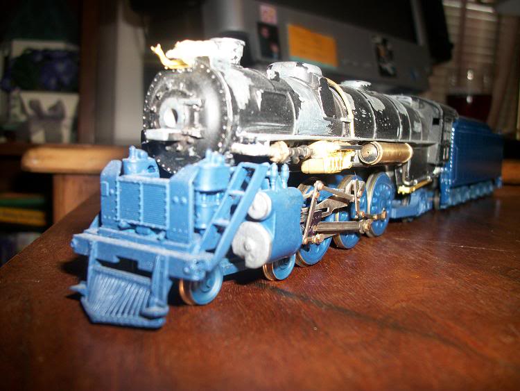

Posting something here that I don't believe I have. I know I have mentioned it, but thats it! So, I thought I'd post some pictures of whats being done to this model.

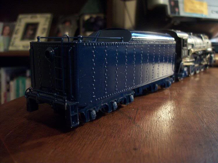

I got some time ago a Mantua 4-6-2 that has the old gear box cover tranfer gear box. In GREAT shape.
Well with my knowledge of the B&O, and the research I've done, the Mantua light boiler is a really close model to a B&O P-7 boiler, and with alittle work and alot of brass detail parts can be made to look really good!
And thats just what I plan to do.....I'm working on building tghe B&O's P-7e 4-6-2, #5314.
Heres is the progress to this model.

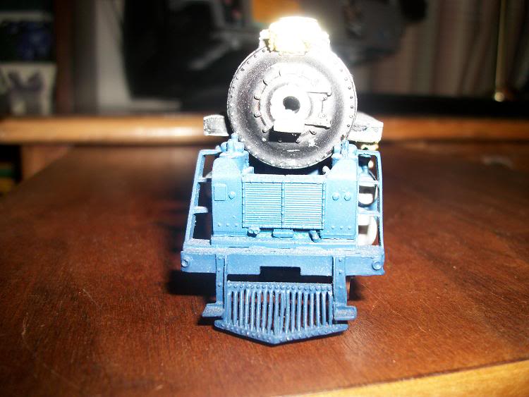

The pilot seen here, is 100% custom, built to the prototype. with a array of brass parts to make it.
And the tender:

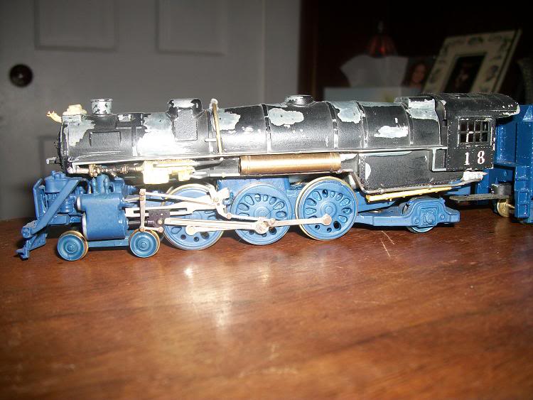

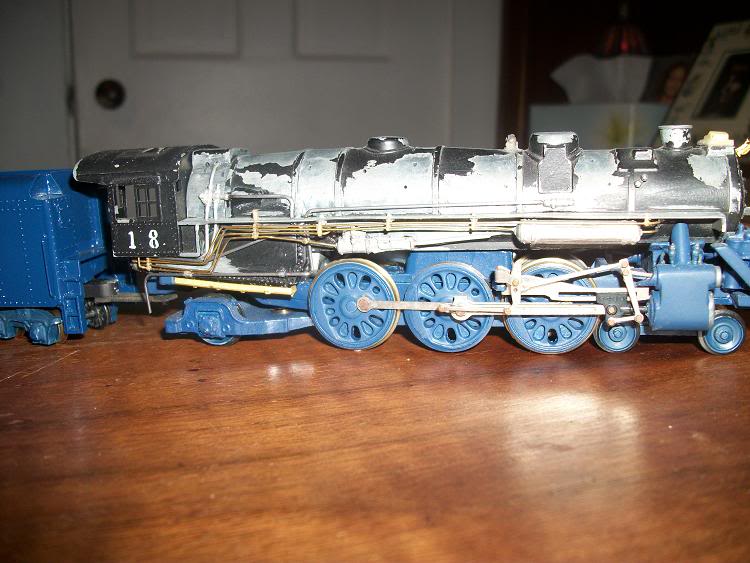

The other side of the locomotive:
I stopped working on this locomotive due to a cab. It came with a metal cab, and I wasn't happy with it. (I actually traded it to Nelson, due to my most recent cab casting process of the Rivarossi cab that fits the Rivarossi 2-10-2. Which is a "B&O spotting feature" as they were very distinct in looks, and will be adding that to this model. In the above pictures, you will see the original metal cab.

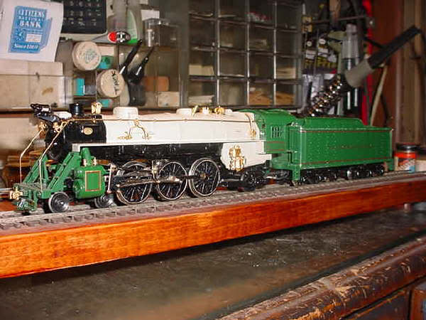

This is the reason I planned to build this locomotive:
This whole train will be pulled by the above locomotive.
I could NOT stand the thought, of this:
...pulling the B&O's "Capitol Limited" when the train is blue and gray, and the locomotive is green and gray.....

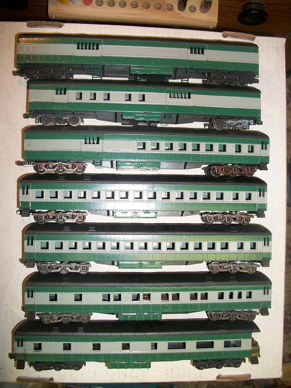

SO, I am building and assembling this:
To be pulled by the B&O's President Washington P-7 #5300 pictured above. I KNOW this train, is NOT prototypical, I just could not resist. IT will look good so.... I thought it was a tasteful choice in colors.

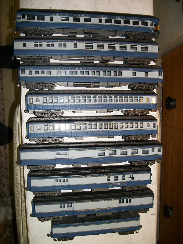

and with that, I got the cars from IHC to build an all green, B&O "National Limited" to go with these and I'm working on the Royal blue as well......PLUS, I have the much newer streamliners to build as well that will be pulled by a set of E-8's as well!

Something I didn't point out, do you have a way to remove the "cast on" details? Like the air tanks and the cast on power revese and such? the items below the boiler gangway.....I milled off all these details and while I was at it, I milled the gangway too, just to make it more scale thickness so it looked better then having the thick walkway!
The 2 places a bell can be added by Mantua factory, was removed and the hole filled as I relocated it to the top of the boiler front.
Alot of removal of cast on detail and let me be the first to say, it takes time, go slow and then use a good section of 400 grit sand paper to finish smooth it out. As if you "gouge" you'll be filling ALL of those to get a smooth boiler!
Let me know as this requires some patients and to that you'll probably be using a Dremel to do that.....Your going to need ALOT of the #426 cut off wheels......
I also smoothed out the handrailing post "lugs" and then took off the AUX dome, just in front of the turret cover thats the box closest to the cab.....I smoothed out the top of the feedwater heater thats just in front of the smoke stack, and right above the headlight and added my own casted part for this.
