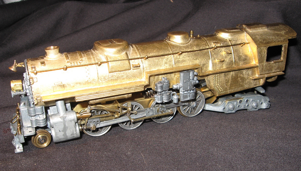

I have this Varney brass Berkshire (that someone made into a Mikado). Since i have ~3 Berkshires already, I decided to try and list it on eBay. No one purchased it or made me a reasonable offer over $100, so I decided last night to restore it myself. The locomotive itself was in excellent condition, but just the paint was bad. Well, as of about ~11:00 am this morning, it was rid of what remained of the paint. I have not assembled it yet. I need to finish cleaning all the parts. All I have left to clean are the tender (whole thing) valve gear/rods and the motor. I decided to convert it back to a 2-8-4 Berkshire by simply replacing the single axle rear truck assembly with a dual axle assembly. After sripping the paint off of the frame, I soaked it in TARNEX for about 10+ minutes. It came out awesome!

This is how it looked before I started:

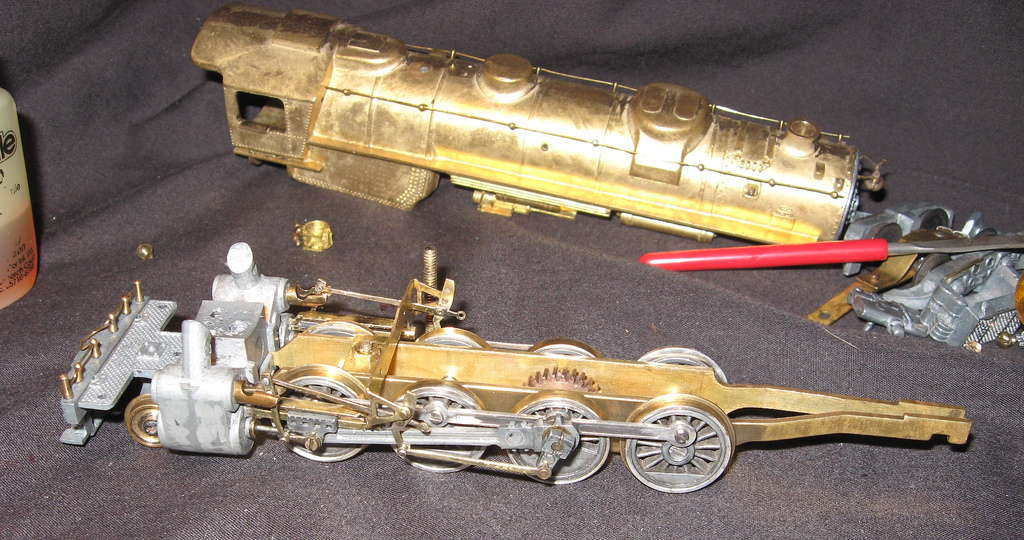

Meanwhile, here is how it was and how it is now:
/tyco/forum/uploaded/Mustangs_n_Trains/20120623161751_7426616072_607e96735c_b.jpg

LOOKS 100% BETTER,how i like to see them all shiny ken
 Posted - June 23 2012 :  4:42:21 PM Link directly to this reply  Show Profile  Add NickelPlate759 to Buddylist
I like it in black, myself, but it could use a repaint. Those keyed axles are a real godsend... I wish more manufacturers did that.
She really gleams now. Are you planning to paint it, or leave it au naturel?

I just finished cleaning the valve gear using a brief ~1 minute dip in TARNEX and then a wash and gentile clean using a stainless steel wire wheel on my Dremel.
I then lightly sprayed them with a clear coat to keep and preserve the clean look for a very long time.
I figure it should take me an hour or so to put it all back together from this point. Maybe a little longer if I have trouble adjusting it.

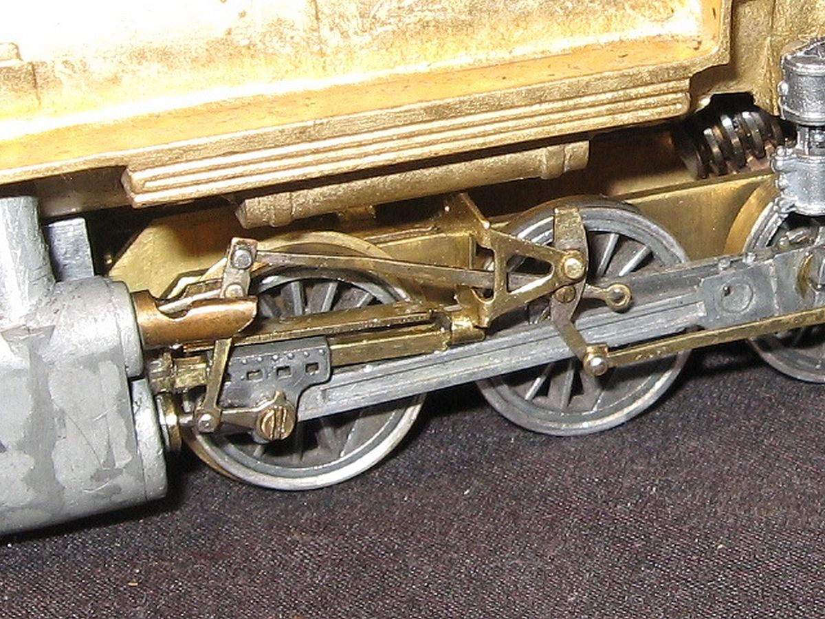

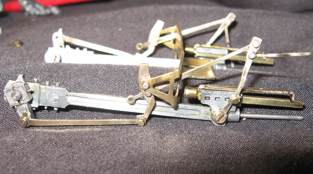

The chassis is now assembled. Dumb-arss me, I initially assembled it with the valve gear, pilot and steam chest upside down! I had to take the valve gear off and flip it over and re-assemble it. What fooled me is the Economy Pacifics (which I have sitting beside me) are assembled with the brass C-channel frame open side facing downward. I forgot that this one was different in that it faced upward. I realized my problem when I tried to replace the pilot truck. I had no where to mount it. Then it dawned on me.. DUH!
As an improvement, the old valve gear hanger rested only on the flange edges and it had a central screw which tightened it to the frame. There was no central support here, so as you tightened down on the nut, it would bend the central plate on the hanger. I then dug through my scrap brass tubing and found one that was a perfect fit. While standing on end, it sat just below the flange sidewall height. I added a washer to improve / increase the bearing plate surface area and the two combined were exactly flush with the flanges. I then replaced the hanger and tightened down on the nut until it was all snug. Perfect fit without bending the hanger base plate!
Took about 2 hours total, botched assembly and all!. After final adjustments and tightening everything down, I put a drop of CA / Super-Glue on the backs of the crank-pin set screws. I did not want them to work their way lose sometime in the future.
The rest of the assembly will be straight forward and easy. Had to get the toughest part done first!
Sorry, forgot to add the photo earlier...
Edited by - Mustangs_n_Trains on June 24 2012 2:04:01 PM

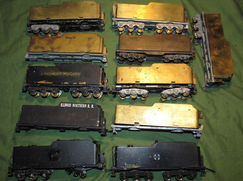

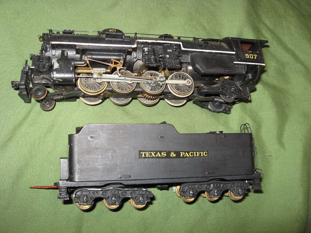

Yes John it is brass shelled with a die cast base & trucks:
It will look like the top right one in this photo when done (this is my stash of most what I have in these tenders by the way):

Sean, continued from VHO, I cropped and sharpened your picture and I can see where the crosshead guide can be pressed further into the chest, and how the hanger should butt up against it.
Looks like they put some serious gearing on these, too.
