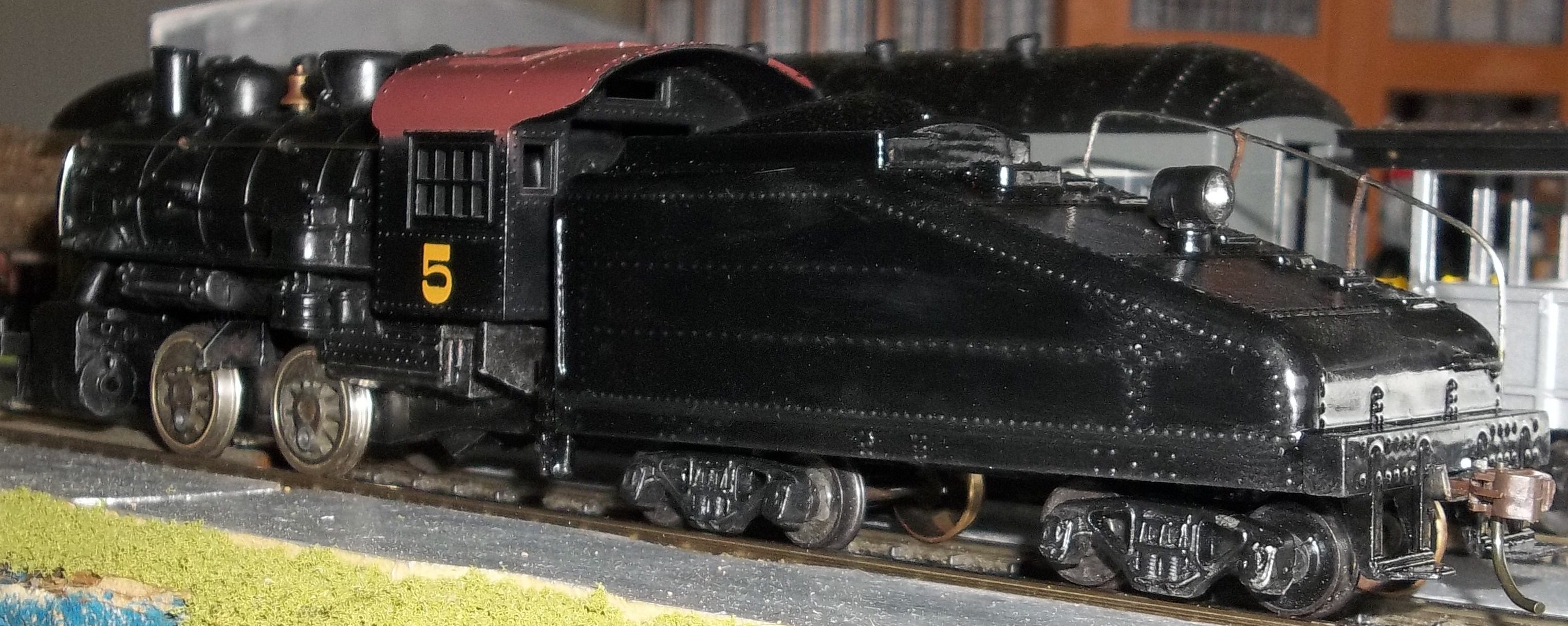

i've talked a lot about my dads old mantua 0-4-0 shifter that he gave me along with his collection of tyco trains. It was old, worn out, dirty, paint chipped, missing cab and smokebox door front and not much of it was good i spent 2 years just taking it apart and finding more info on it, now i know all about them and have spent 2 years rebuilding it, 2010 i really got started, painting the boiler and frame. But that was it. 2011 i tried to get her done but the motor wires broke and caused more problems with held up her restoration. this year (2012) i told myself i'd finish her, but first i had some huge problems: the wheel quartering was off on the drive geared wheel, and i was missing some brass spacers which seperate the drive rod from the main rod. Also, the tender frame got a screw stuck in it while i tried removing it, it snapped in half rendering me with the locomotive once again in a million pieces. It all changed yesterday when i went to the train show in bakersfield and stumbled upon a parts box and found a mantua 0-4-0 boiler and tender shell and frame (complete tender basically) the tender was missing the trucks but i rebuilt my originals. Anyways i spent all day today painting the spare boiler even though i dont need it , the tender frame and shell as well as installing the newly rebuilt tender wheels and trucks which are original and installing the fake tender light and handrails which i pulled off her original tender which was missing its steps thats why i decided to use this newer shell cause it had all the steps, i had to paint over the pennsylvania lettering and make it undecorated. After all that the tender is finally 100% rebuilt with a new frame, shell, rebuilt wheel and trucks, new knuckle coupler, fake tender light, and original handrails. A huge milestone after a huge string of problems. now she is 75% complete and only needs new drive wheels and rods, i hope to get a parts supplier engine only on ebay soon.
it looks shinier and cleaner in person i'm proud though
the first time the tender's been rejoined with the engine since 2009! i put the original drive wheels back on just for the photos today, they will be replaced in a few weeks.

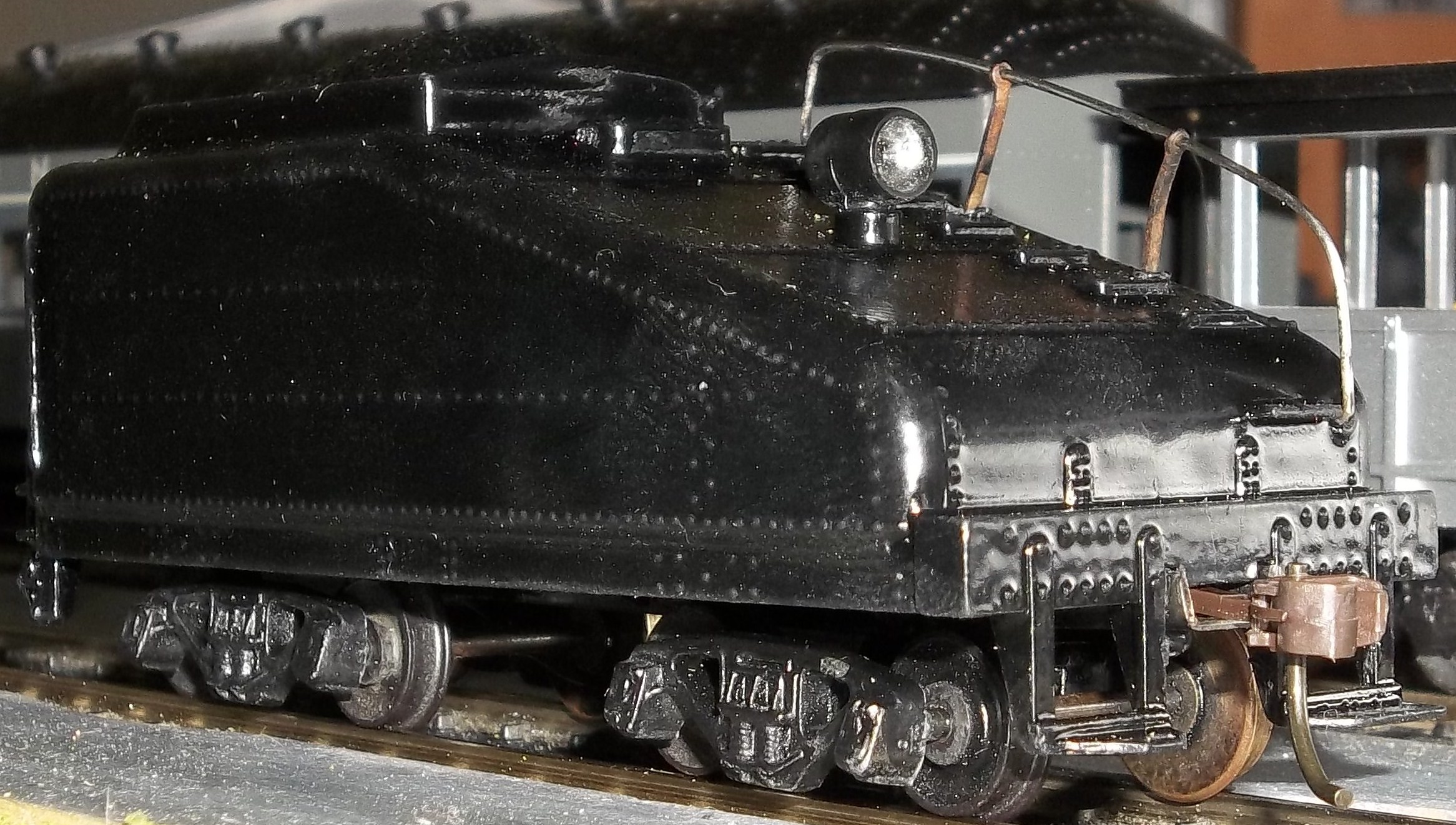

rear view of the newly rebuilt tender and ol #5

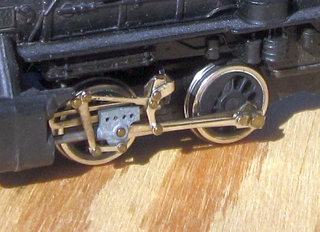

Yardbirds will fix you up...the full valve gear will look like this...

 Posted - March 12 2012 :  12:52:56 PM Link directly to this reply  Show Profile  Add shaygetz to Buddylist
Piece o' cake...just remember the eccentric goes on just left of center and don't kink the linkages...
