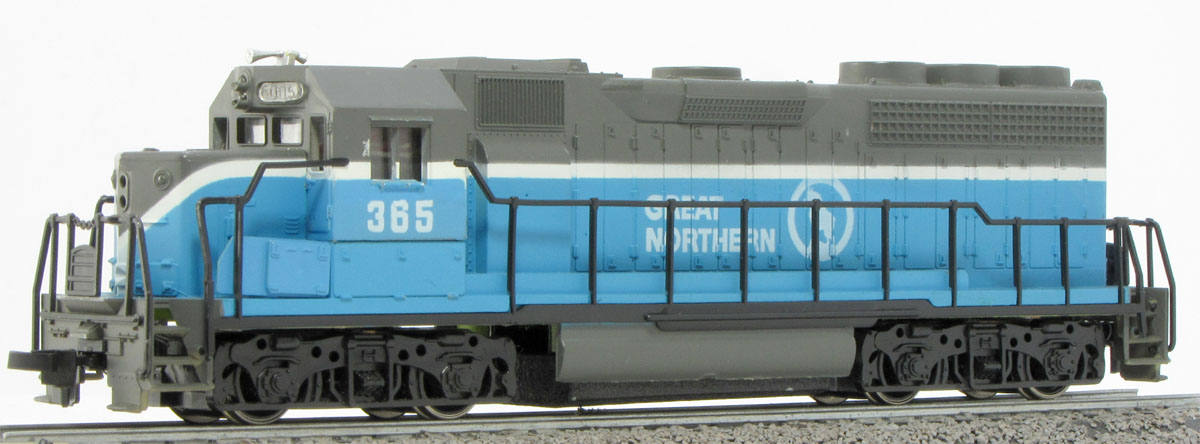

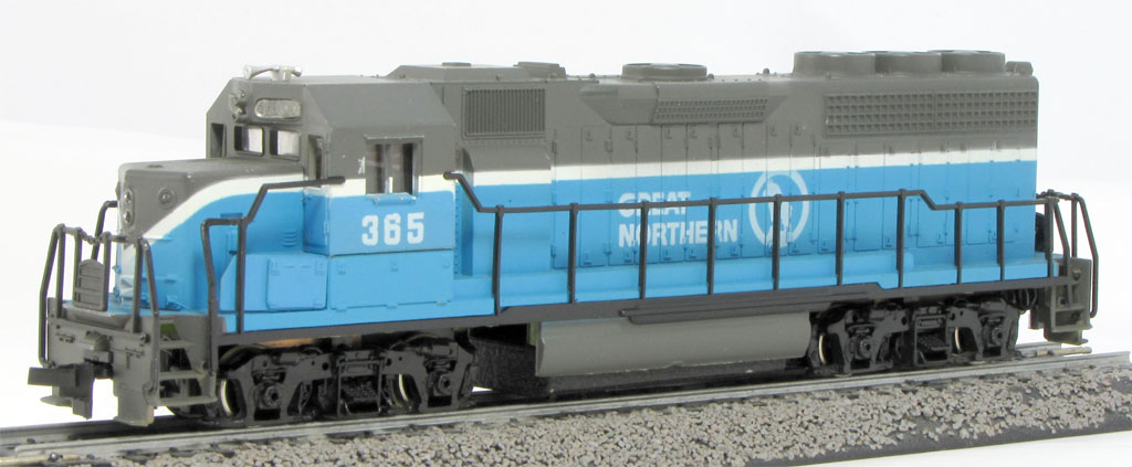

Took a while for everything to arrive, but I finally got all the parts in hand this week to upgrade my Great Northern Bachmann GP40...
BEFORE:
AFTER:
Newer can motor courtesy Shaygetz, and upgraded trucks from GraftonTerminal. Thank you, gentlemen!

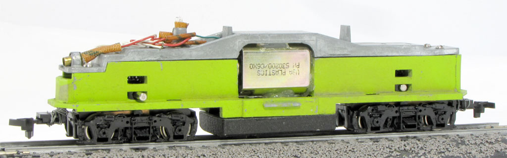

The can motor is a drop-in fit, however it does not fully seat in the chassis owing to the shaft bushings being a different size. Silicone to the rescue! I used some sparing silicone to mount and insulate it as shown, and it works like a charm. Very easy installation, aside from installing the joint couplings on the shafts, which was surprisingly tough. Also have to make sure the motor is aligned perfectly level... kind of an eyeballing affair, but it will bind if it's not correct, so it either works or it doesn't.
Performance is MUCH improved, but the low gearing doesn't make this a speed demon by any means. And it's still loud, but I like it. Actually the new motor is silent, so everythign else is gear chatter.... I'll have to try some of Nelson's suggestions there.
At any rate, I think the newer trucks are a big improvemen in looks, and it definitely has personality now... easily one of my favorite "Train Show Junk" finds ever.
Thanks again to all who helped out!

Wowzers, those truck sideframes made a real big difference didn't they? You're very welcome - I'm glad to help.

Tony, the detail is better on the later sideframes.
I guess we discussed it before, but now all of the noise comes from the shafts and gearing, and a lot can be eliminated by tossing the couplings and substituting silicone fuel line tubing. I also shimmed the square plastic bearings with thin styrene at the bottom of their slots to keep them from rattling, since the fit's a little loose. If it has the metal worms, it should be pretty quiet after that. The plastic worms on the AHM FT's were noisy, probably from the parting lines running right down the center.
