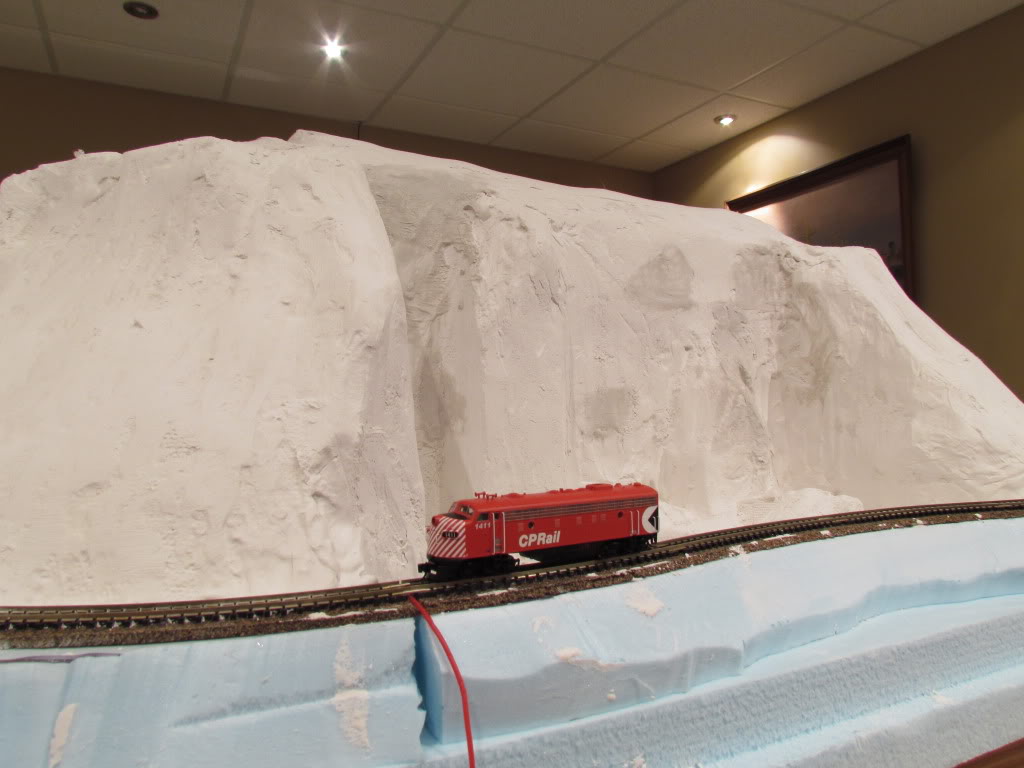

The layout I'm currently working on is paper towel dipped in plaster and laid over foam:
 Posted - February 19 2012 :  7:18:37 PM Link directly to this reply  Show Profile  Add Alco Fan to Buddylist
Nice work on this layout Cheez.
