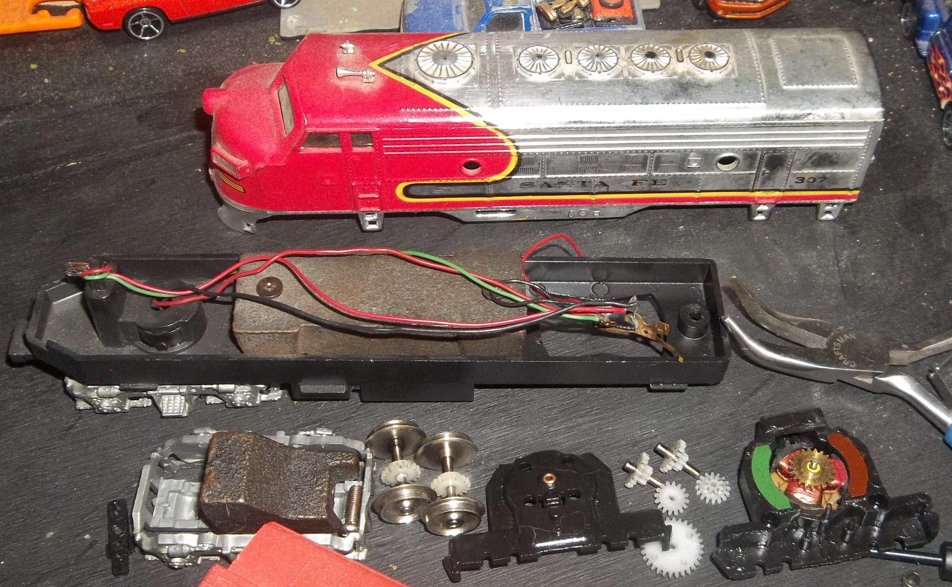

one of the first engines i ever got as a little kid was a bachmann f7 or f9, for the last 10 years ive had it sit out of service on my collection shelf, only the light worked on it when put on the track. I've had similar problems with tyco alcos, and corrected them, but their totaly different then the f7. What type of problem could it be, i'm a steamer restorer, i've restored some old tyco and mantua diesels but cause i'm familiar with them. Anybody have an exploded diagram sheet of it? I've stripped the rear power truck from the frame, its all in pieces now, so i need a reference to where everything goes, i forgot to take photo references. Since it's one of my first ever engines i feel it deserves to run again like my dads old 60s tyco alcos.
Here's where it stands as of now any tips?

Your first engine. Yeah, it deserves to run. I can't find a reference diagram. Most likely it's going to be bad contacts, why it didn't run. Somebody here has a photo or something.

One more thing. I have that same Bachmann F9. I can dig it up and post photos of the power truck with the gears still in place. It's packed away in a box, could be a few days before I can dig it out.

 Posted - February 18 2012 :  9:10:18 PM Link directly to this reply  Show Profile  Add Alco Fan to Buddylist
Wow, that is so similar to Tyco PT and Aurora slotcar motor set ups.
Replacing the entire power truck would still be original like.

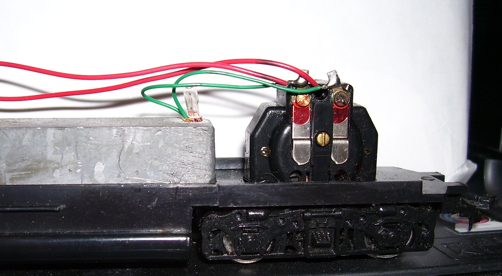

This is a rough guess where the gears went. The positions should be close. The drive axles could be figured out if the gears are off centered and they only line up one way.
The wires I think would be a pos, a neg and one to the light. It might run backwards at first.
Good luck.

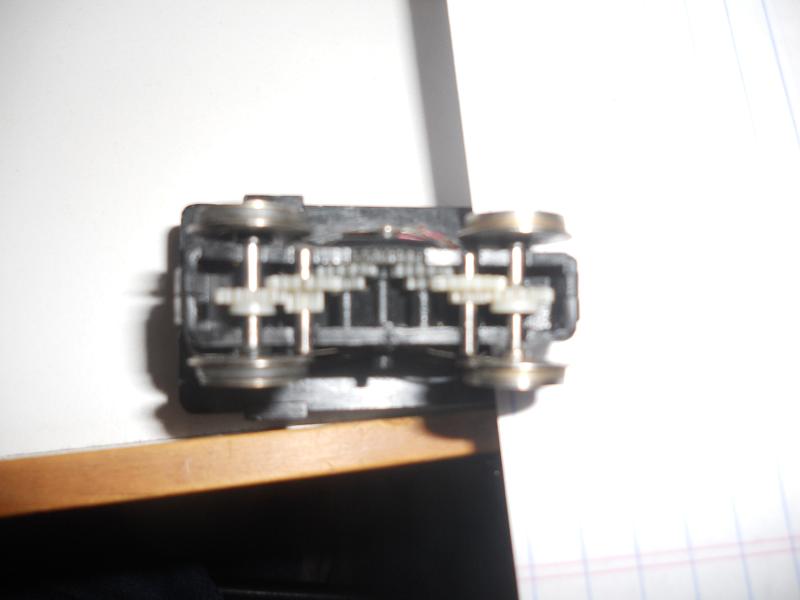

With AlcoF's side view schematic and this blurry photo, you should be able to reassemble your power truck.

This is a Lionel GP30 but has the same power truck, I hope.
Let us know how it works out.
