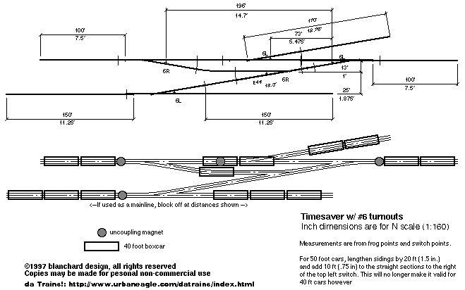

Does anyone have a track plan of the Timesaver? It will be the add on of my current layout.

Here it is! - Erich

Many Thanks Erich! I appriciate your help!

Romcat, I knew it was unrealistic, But I wanted to see if my dad and I and whoever comes to see my layout has any switching skills. I figured out how to do many intresting things with one switch.

The spur at the top was meant to be used separate or joined to another Timesaver. This way two could play at the same time, with the added twist of transferring cars from one side to the other. The purpose was the two sides working together to finish a problem, not competing against each other. John actually didn't care for people who finished too far ahead of the other, believing that it showed a lack of cooperation on their part and not any skill.
You wire it to a throttle through a DPDT center off switch. Once a comfortable switching speed is set, the only thing to operate is direction of travel thru the switch, the speed being already set and the same for all competitors. A REALLY good switch engine is needed, one that is not affected by turnout frogs and minor dirt spots. There is room for up to 9 cars but 5 is usually more fun and not as complex.
