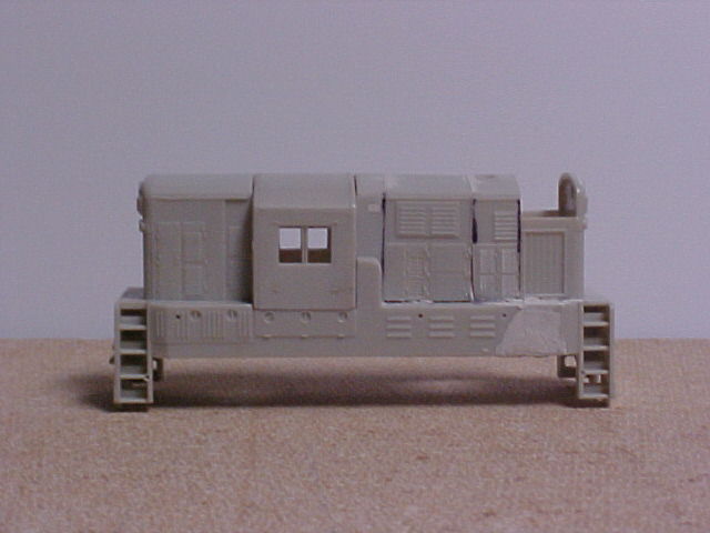

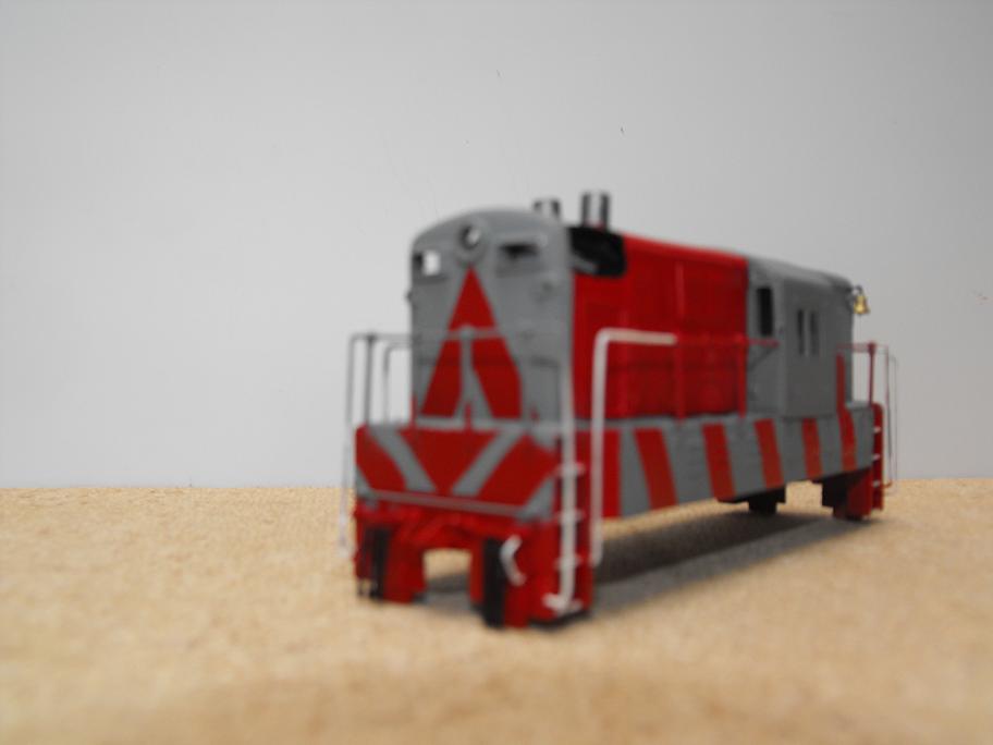

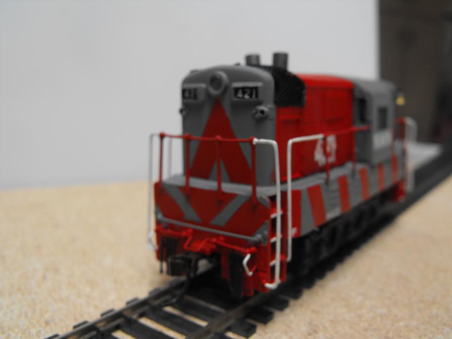

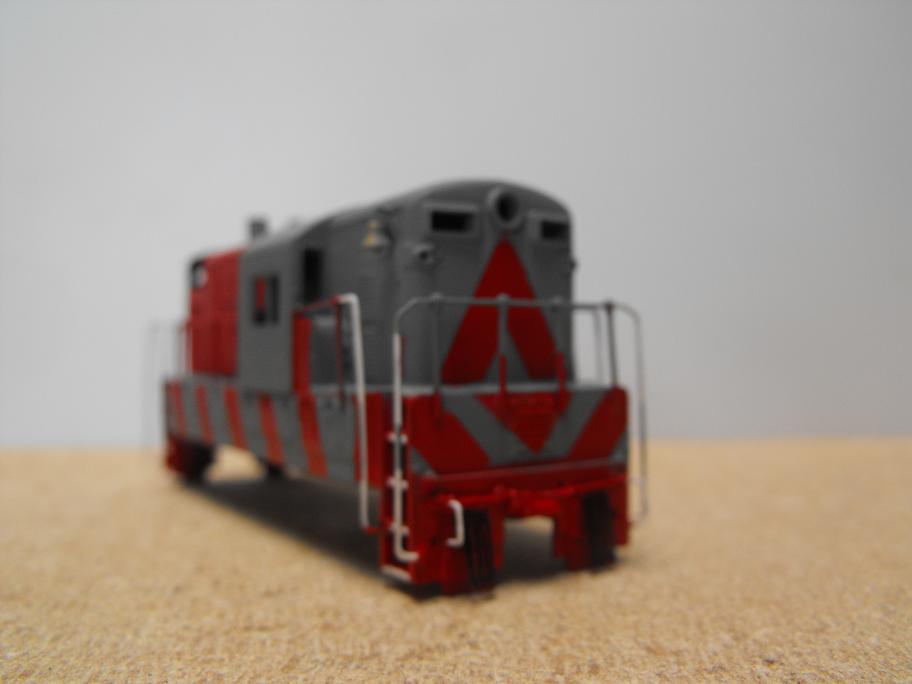

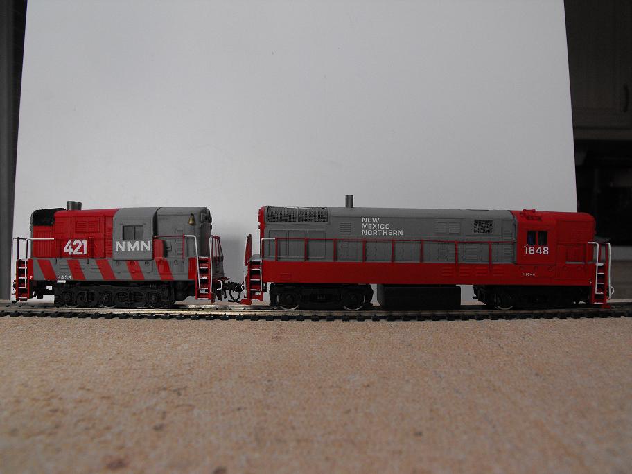

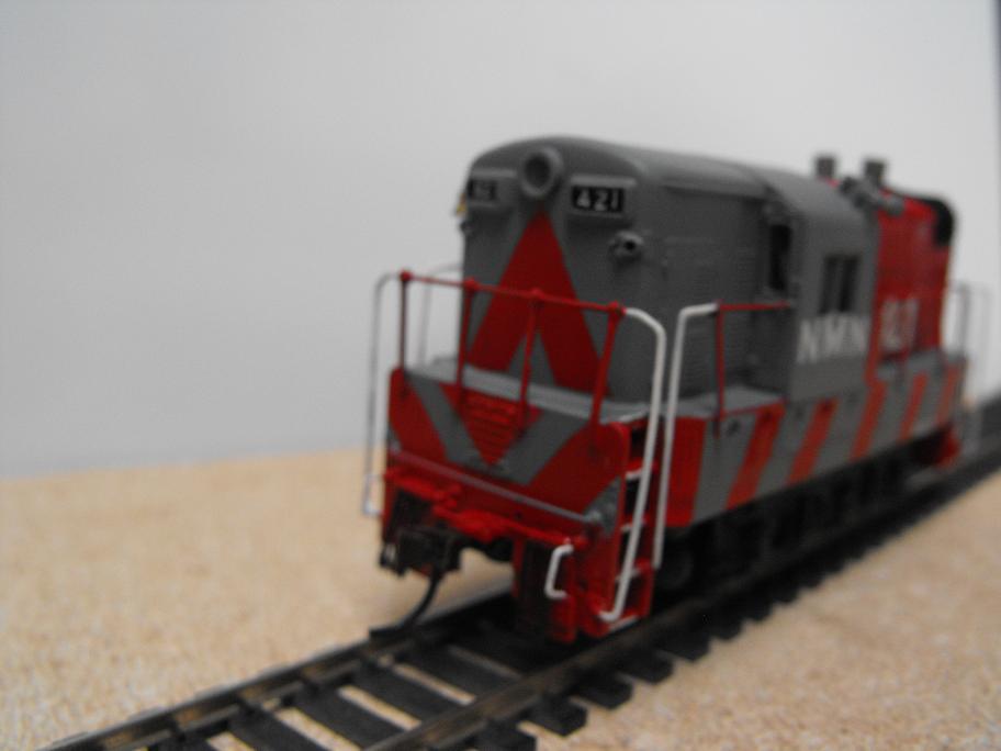

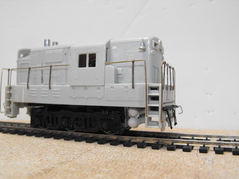

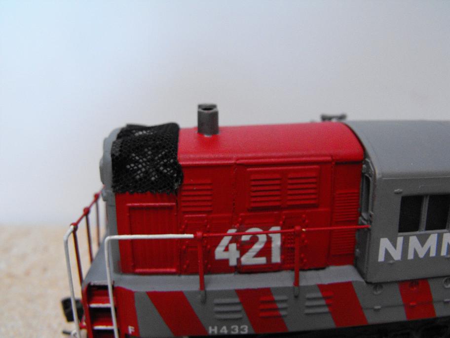

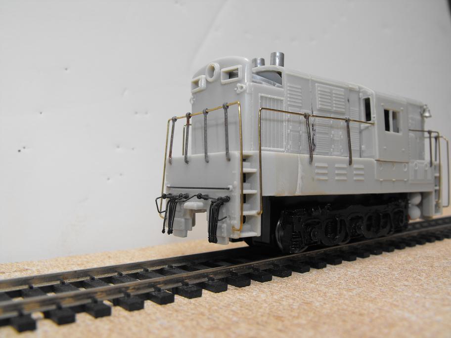

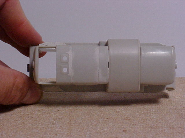

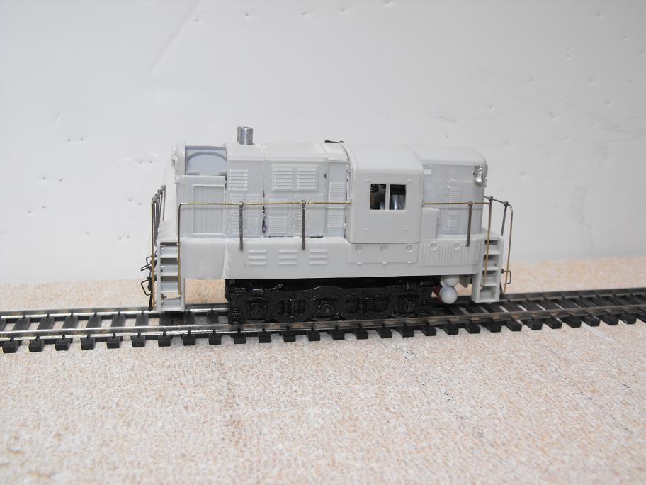

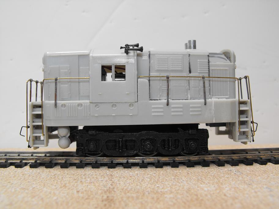

Here is my version of the "Infant Train Master". Ray did the original version. I could only find this photo of Ray's original

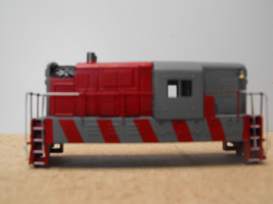

I started this kitbash with a Bachmann H16-44 shell. I wanted to make a center cab-type critter but ended up with the cab off center anyway. Here is how mangled the shell got:
The hand rails are bent brass wire that run through Athearn stantions.

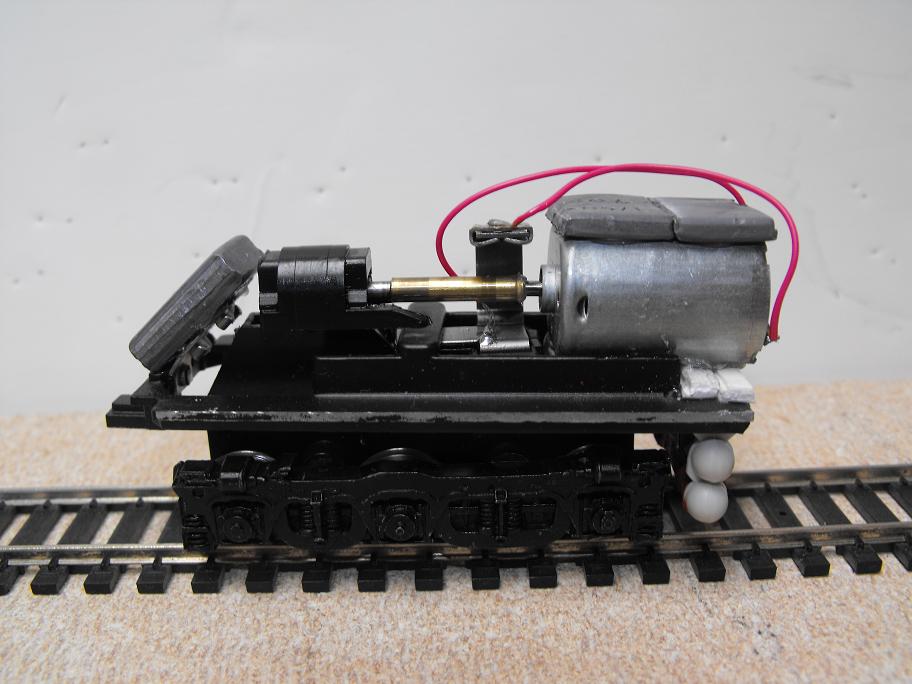

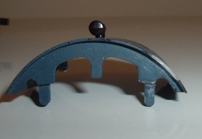

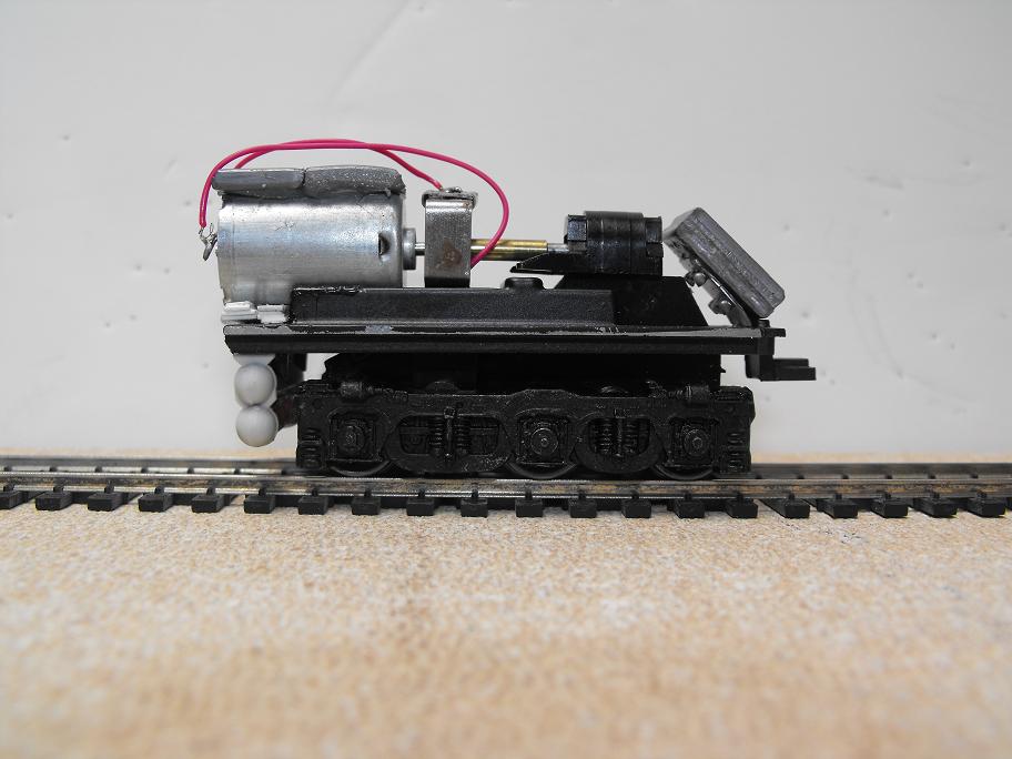

Unlike Ray, I did not have a spare Tyco-type chassis to use. So I made the frame by cutting the front part of an Athearn CC U-boat chassis. This gave me the bolster so I could mount an Athearn TM truck. Since the truck did not need to pivot, I could mount the motor perfectly in line with the worm shaft. The motor is actually glued to both the frame and the rear of the truck. Since there is no shifting in alignment the motor and worm shafts are conected by brass tubing.

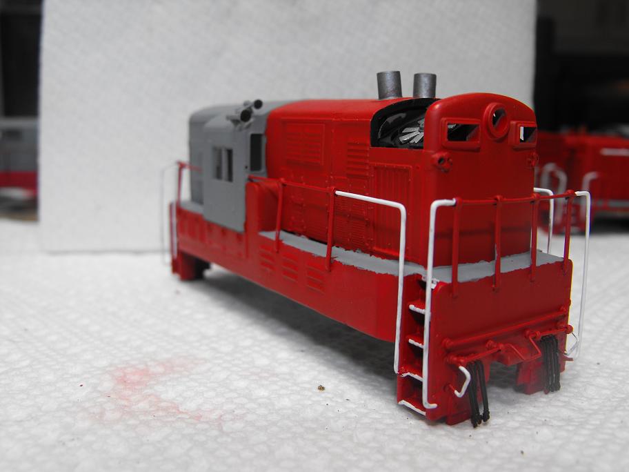

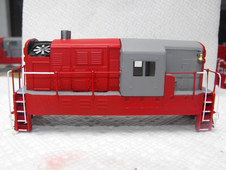

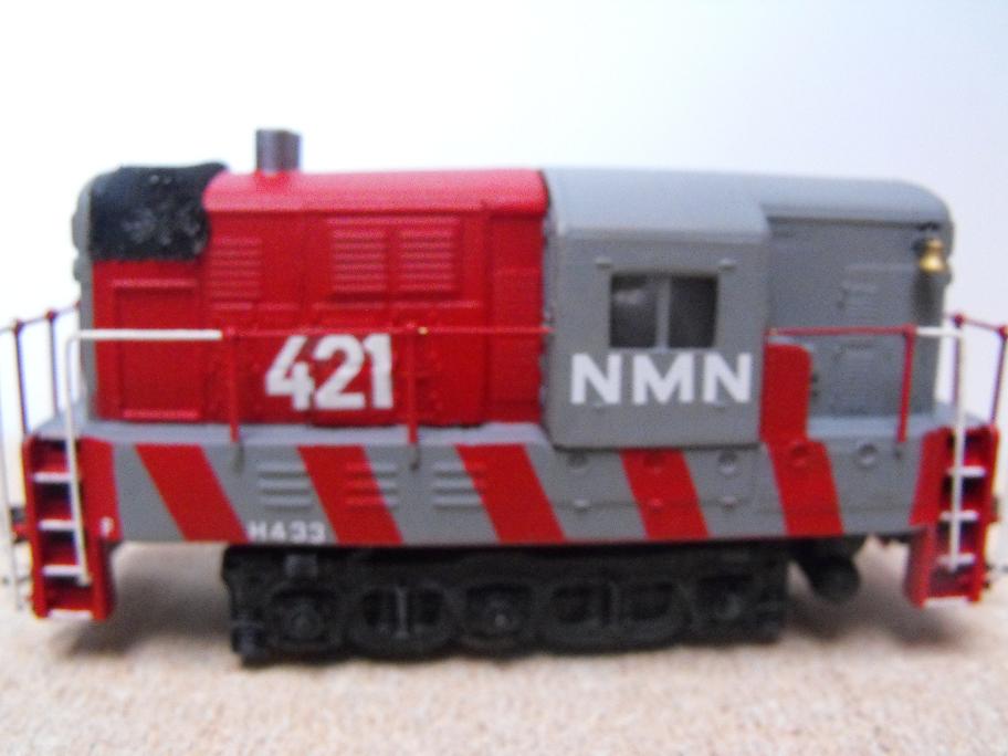

The shell has been in the NMN paint shop today. The decaling will take awhile longer since they must be applied one letter at a time. Hope to have it all finished and more photos posted in a week or so.

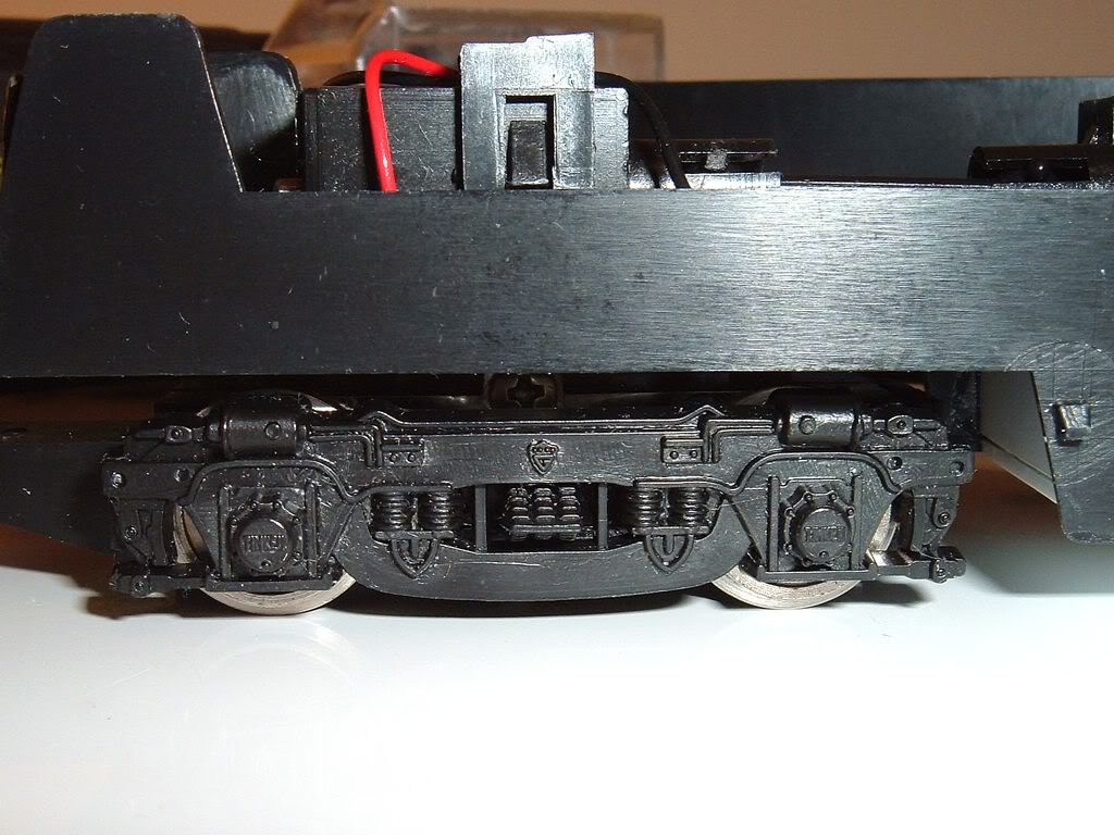

 Posted - October 29 2011 :  6:01:41 PM Link directly to this reply  Show Profile  Add romcat to Buddylist
That thing is awesome Buddy!
You need a closer fitting power truck to really do it justice though!

 Posted - October 29 2011 :  6:10:21 PM Link directly to this reply  Show Profile  Add Hypoponera to Buddylist
I was thinking of filling the open space in front of the truck with a small fuel tank. Since the truck doesn't need to turn I don't have to worry so much about spacing.
I didn't have a truck unit that would fit any better. Besides, I wanted to keep it as "FMish" as possible.

 Posted - October 29 2011 :  6:51:54 PM Link directly to this reply  Show Profile  Add Alco Fan to Buddylist
Really interesting shell work and that mechanism is ingenious!
What kind of red is that it'intense?
I enjoyed the pics!

 Posted - October 29 2011 :  11:59:51 PM Link directly to this reply  Show Profile  Add Hypoponera to Buddylist
Thanks for the comments! I am always open to advice/suggetions.
The red is my standard NMN red. It is "signal red" enamal by Floquil and applied with an airbrush. I am not sure why it looks different though. Maybe I diluted it to a slightly different consistency this time around?

Hypop: Question for ya. What tools do use when modifying shells like this?
Hypoponera
BQ23-7
 Posted - November 01 2011 :  7:11:21 PM Link directly to this reply  Show Profile  Add Hypoponera to Buddylist
Hey Cheez,

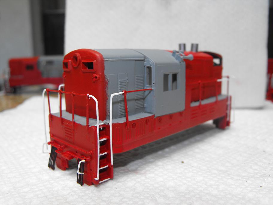

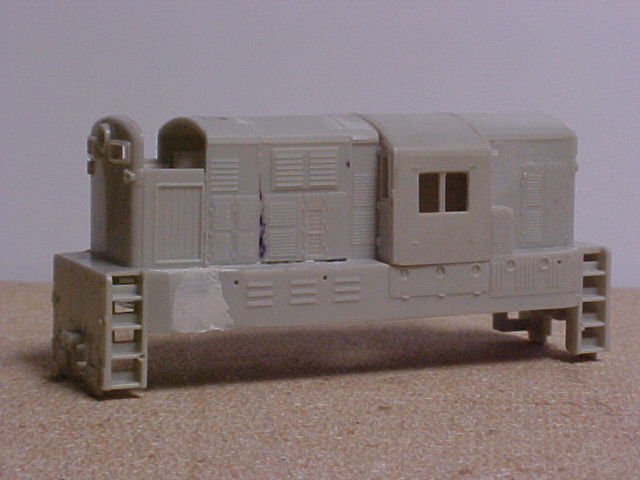

I used an old Atlas razor saw to do most of the cutting on the shell. I used a small Exacto knife saw blade in a couple really tight spots. I did not use a dremel since I tend to melt rather then cut plastic with it! I then trued up the edges with a large mill file.
I used Squadron white putty to fill gaps and seam lines. The first few photos still has all the putty unsanded and visible. I had a ton of places that needed to be filled!
All in all, I did not use many tools at all. And nothing "hi-tech" or powered.
And your opinions DO count! I had not thought about filling that open space. So suggestions to do so showed me something I had not even noticed.

Just a suggestion, Hypo Why don't you put on grills over the fans & paint them black or gray & make the fans turn too

Put black paint near the smoke stacks! It looks like soot and oil!
Originally posted by microbusss - November 01 2011 :  9:51:38 PM
Good suggestion! but I beat you to it. I have the screen and just need to cut it down to fit. The screen is already colored black and has fairly large openings. So the silver blades should show just fine.
Turning fans? Hmm.... Life Like did do that once.
Originally posted by CNVIATyco - November 01 2011 :  9:55:42 PM
Weathering is planned. But not expected to be done any time soon. The amount and type of weathering will depend on what I end up using this critter for.

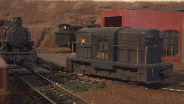

Ray Marinaccio
RayAvatar
 Posted - November 03 2011 :  12:41:45 AM Link directly to this reply  Show Profile  Add Ray Marinaccio to Buddylist
Nice work I like it.
Would a baby loco like this work IRL?
Originally posted by microbusss - November 02 2011 :  4:06:35 PM
http://www.rr-fallenflags.org/milw/milw-x3800agh.jpg
http://www.rr-fallenflags.org/cr/cr-shpgoa-eza.jpg
http://ohiorr.railfan.net/images/crmule.jpg
Ray

Cool idea, Hypo. It looks like you used the trusty FK-130 to power it. What size brass tubing did you use for the sleeve coupling?

Is that a C-Liner truck? I think I have a spare one of those....
Cool pictures, Ray. I really like the CR mule on the Alco truck.
Originally posted by NickelPlate759 - November 03 2011 :  2:43:16 PM
Thanks Nelson! Yep. That is my last FK-130. I used 2mm ID brass tubing. I very slowly drilled out the end that mounted to the Athearn worm shaft. I then used a dab of silicone sealent inside the tube... just in case. I got lucky and everything lined up and was straight on the first try!

I have to congradulate you for a job well done. But Can we see it when the gap has been closed?
Ken
old feller
 Posted - November 03 2011 :  10:01:10 PM Link directly to this reply  Show Profile  Add Ken to Buddylist
Body Fill.
What I use I put some plastic shavings down on a metal plate and add some CA glue in and mix well. The plastic melts and you can use it as body fill works great for me. Try it.

I was thinking the same thing. The revised Mehano C-Liner truck is quite accurate, if that's the one you have.

I've never tried mixing plastic shavings and CA. I use it with baking soda, which is incredibly strong and good for internal repairs or in places where putty wouldn't be strong enough, like filling in this chipped cab roof.
Once the CA and baking soda were built up enough, I used a Dremel with a steel cutter to shape it.
Originally posted by NickelPlate759 - November 04 2011 :  8:24:47 PM
That's what I had in mind. I have several of the revised C-liner trucks as well as 1 pair of side frames from Smokey Valley for the Athearn B truck. I think the Athearn would be easier to mount onto a frame though.
 Posted - November 05 2011 :  10:04:51 PM Link directly to this reply  Show Profile  Add NickelPlate759 to Buddylist
You could cut off the C-Liner sideframes and use them on an Athearn B truck assuming the wheel spacing is close enough.
To do the CR mules properly, you'd need a NWSL Stanton drives.

 Posted - November 07 2011 :  4:14:40 PM Link directly to this reply  Show Profile  Add Hypoponera to Buddylist
Thanks to suggestions by Romcat, I had to add some safty stripes. So a quick masking job and a blast with the neutral gray paint resulted in this:
Sorry for the blurry images! Now I need to do some touch up painting.
Edited by - Hypoponera on November 07 2011 4:20:15 PM
 Posted - November 07 2011 :  4:53:39 PM Link directly to this reply  Show Profile  Add romcat to Buddylist
Hooah!
Now based on that paint scheme clearly a Switcher! Long Hodd being Red and all....
"A is A"

Hypoponera
BQ23-7
 Posted - November 07 2011 :  5:25:13 PM Link directly to this reply  Show Profile  Add Hypoponera to Buddylist
Certainly changes the look of the little critter! Just need to touch up paint tonight. Tomorrow I will gloss coat and hopefully I will decal and flat coat Wen or Thurs. I will need to stare at it for a while to figure out how to mark it. There isn't any space for the road name to be spelled out. Maybe just large letter initials?
Also may have figured out how to fill that space at the front. I found some old loco weights that may fit with minimal work and are nicely rounded on the bottom.
 Posted - November 07 2011 :  5:28:23 PM Link directly to this reply  Show Profile  Add romcat to Buddylist
"Jerry Cans"!!! to fill the space!? I mean the gaps at the ends!
Long Range non-conformal non-fastpacks! configuration!!!
"A is A"
-Aristotle
Law of Identification

 Posted - January 17 2012 :  2:40:36 PM Link directly to this reply  Show Profile  Add Hypoponera to Buddylist
Sorry for the delay! I had planned on having this project finished before Christmas. However, family emergences pushed all modeling projects to the back burner. Fortunately I had a week between drives to Tucson and got this project done.
I still have to come up with a good fuel tank to fill that gap under the front pilot. I gave some thought to Romcat's suggestion, but could only find a spare set for an old F-4. The SEA scheme kinda clashes with the NMN red though.
Here is a broadside view. Shows that gap quite nicely don't you think?
A close-up of the screen cover over the fans. It doesn't look great up close but looks good at arm's length.
Here are a couple poor shots of the ends.
Here is the kitbashed critter with a full sized Bachmann H16-44. This should give you some idea of how much of the original was cut out.
I think this critter will look good sitting next to the old round house. I found it won't pull more then a couple small cars. There just isn't enough room inside for adding ballast. And the balance is terrible!!
Now, where did I put that C630 project I started?
